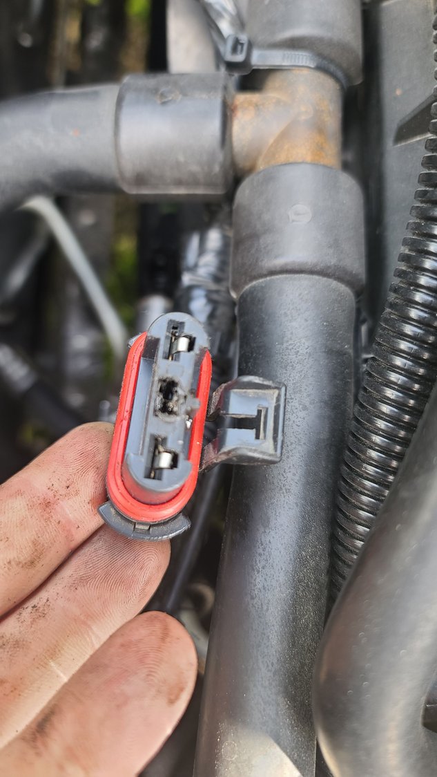

Can I by pass the plug that goes to fan controller by just hard wiring it. Mine is melted.

Several forum members have done exactly that. Be sure you use the proper gauge wire should you require any additional and solder the connections and then seal them.

10 ga or larger wire
good crimp connector but solder is better
Seal it from the weather....heat shrink or something.

Did you modify the fan table so that the fan ramps up sooner? If so, that puts more stress on the connector. If you then bypass the connector, the stress is passed on the the fan controller. It can then fail.

No the fan table is stock.
I just finished the bypass and fans are working fine,
Ill need to re solder the ten gauge since I didn't have an iron hot enough. I used butt end crimp splices. I'm going to pick up a mini torch tomorrow and solder the connections.

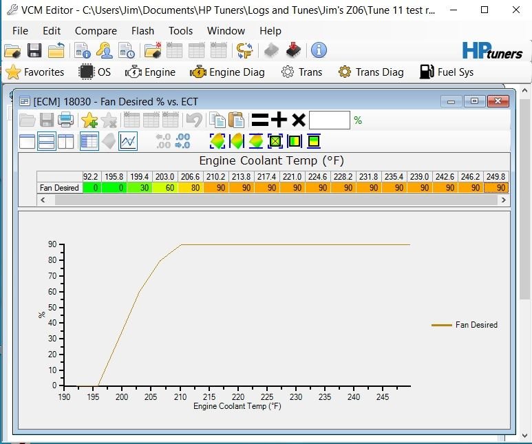

A service bulletin several years ago by GM recommended the ECM be programmed to no more than 90% duty on the fan. Supposedly, this was the cause of the melting connector.

Hardwired the fan several years ago after the connector melted for the second time. Also "tuned" the fan table to command the fan to run a little faster a little sooner.
Here's a comparison between the stock and modified fan tables:
Stock Fan Table: Notice the fan is only 50% @ 215* and doesn't go to 90% until 225*. Used to regularly see 230* in summer traffic.
Modified Fan Table: The fan comes on at the same 200* but ramps up to 90% quicker
The car runs noticeably cooler in 100* stop & go summer traffic for several years now, and nothing has burned up. Don't believe the naysayers who have never done it
