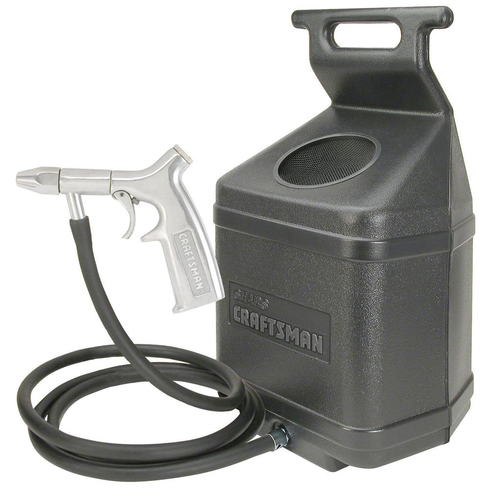

Myself, have a bead blast cabinet, but for something like rotors that screen sifted play sand will knock off the rust quickly, and since the yard always could use a bit of play sanded added to it, have one of these that I use outdoors with air compressor when I need to clean up metal instead.
Note, safety glasses and wear a respirator why blasting.
Also, if you have a power washer at the house, them there is a sand blast kit that you can buy to use with it, but the dry system is a lot faster and you don't have to worry about the cast iron rotors rusting up quickly from the water you using in the first place.
