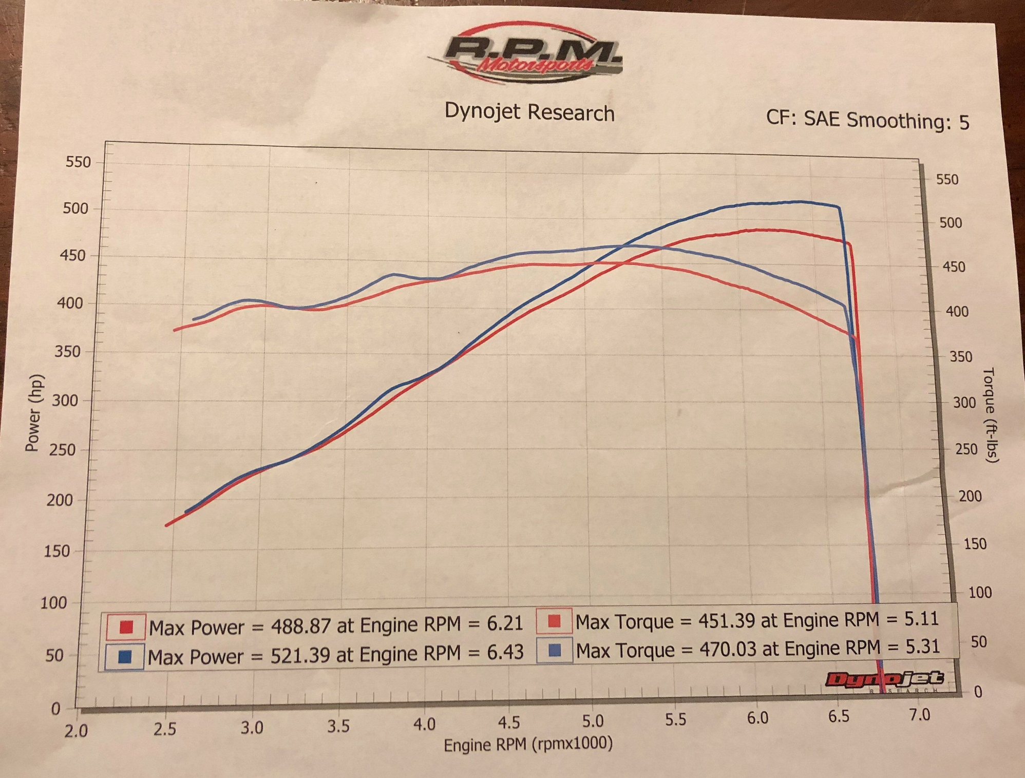

Originally Posted by djjmk1
Great info guys, I daily the car on occasion and 230 @ .050 would be the largest I'd put in it. The car is a manual 6 with a Monster LT1-S twin clutch, Trick Flow Gen X 255 heads, ported Katech throttle body and AFE Pfadt 1 7/8 Tri Y headers with 3" exhaust to 2.5" Flowmasters. Also considering the Spinmonster cam
I have seen 520rwhp a few times and this thread shows the combo of a 230/234 114+2 on an LS3 with trick flow heads making 521rwhp. I didn't sell him the parts and I didn't do the install:
https://www.corvetteforum.com/forums...am-result.html
When tuners state their huge overlap cam makes more power everywhere, ask to see chassis dyno proof.
Use a proven combo that drives great due to low overlap. I've seen expensive lessons learned by guys who went ported stock heads with huge overlap. Why go huge overlap to make near the same power?
