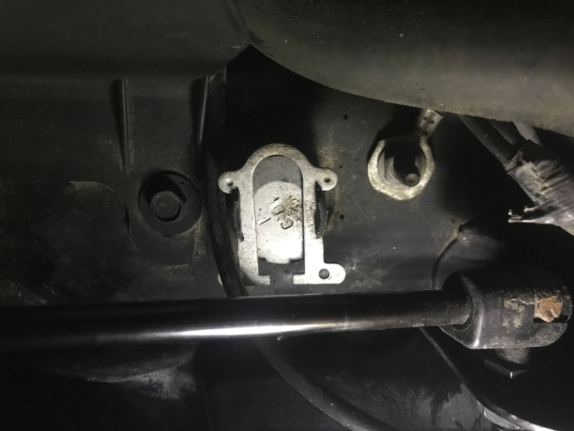

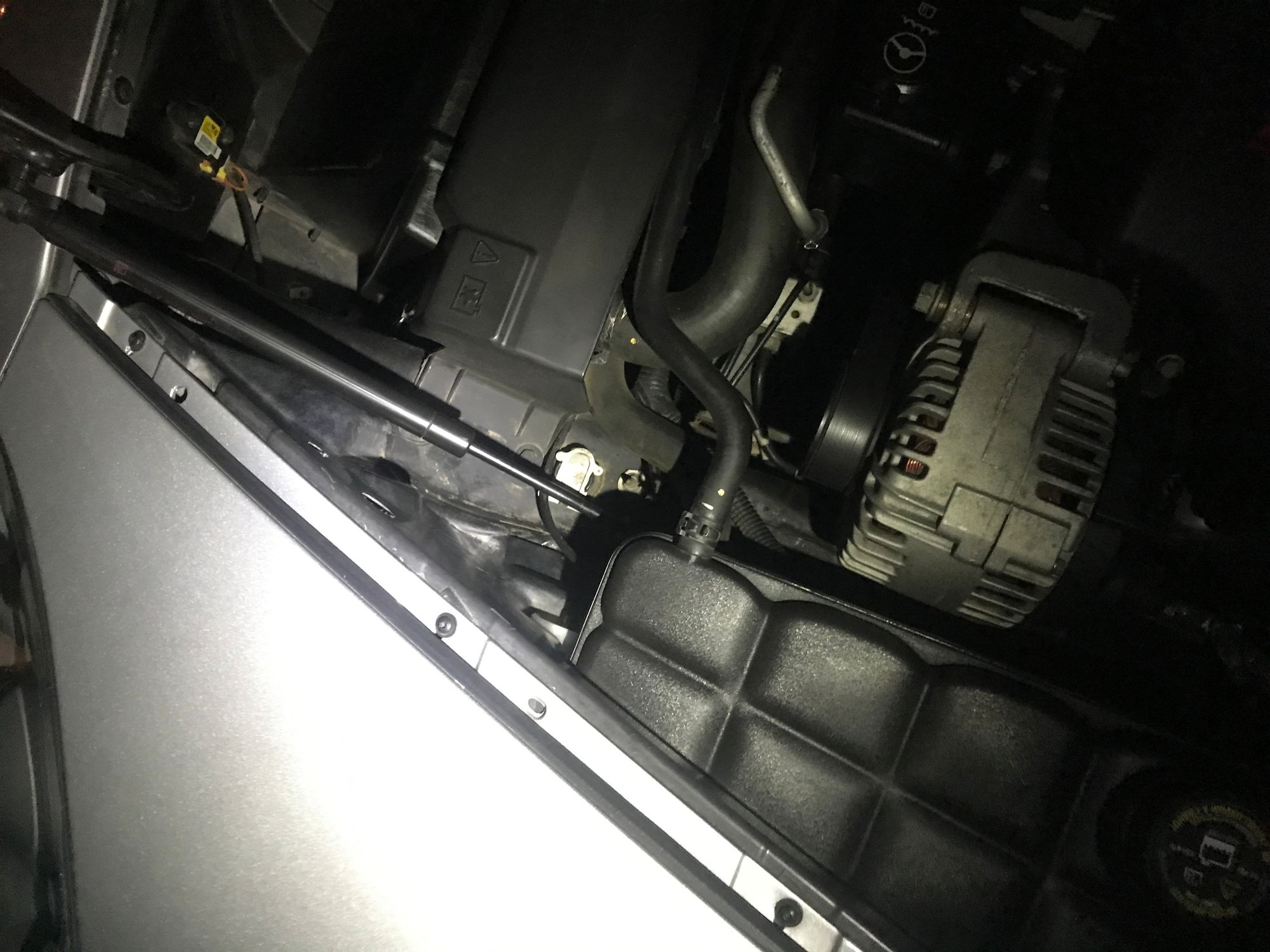

I'm new to my C6 Corvette, so please be gentle.
What in the heck is this gosh-durn thing? There are four of them in the engine bay. It's like a low, round cylinder with a springy metal frog-shaped thing that seemingly can be removed, but I don't want to do that without knowing what it is! As far as I know it could be the 4 lynchpins that holds the whole car together!
Location of one of the four gizmos.
Close-up. There are numbers stamped into the part.

I just tried to take one apart. The clip comes off. But the piece underneath will not. It seems like some kind of ceramic rock.
I can not see it inside of the frame. It looks like they are welded in.

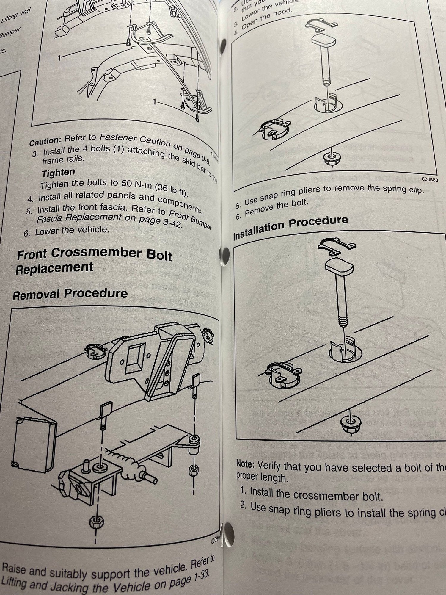

I was close. It's a crossmember bolt:

My guess the clip is there so the bolt remains in place during the assembly process. Kind of like the stud clips to keep the rotors on.
Exactly. I've dropped my own engine before on my 2008 Z06, and, of course, the bolts didn't move when I re-installed the crossmember, so that's exactly what they're for - keeping the bolts in place so you can stab the crossmember back on the bolts.
