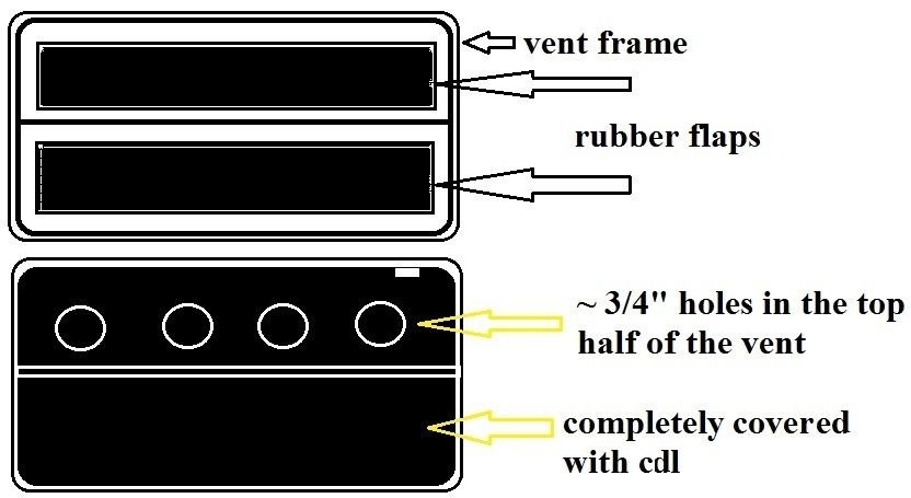

Ok here is my shot in the dark, on the drivers side & the passenger side, in front of each rear wheel well, between the rear quarter panels and the car's interior walls is a bag filled with what looks like expanded foam which is contained in thick plastic. This foam conforms to shape of the space and is used for sound dampening of that cavity between the inner wheel liners and the door jam. On the drivers side it is around the gas filler tube and wheel liner.
Just thinking that in cold weather the plastic gets stiff and makes noise and as the temperature rises it softens up. There is a large cabin vent behind the rear passenger side speaker that is one of the biggest ways for noise (road and otherwise) to enter the cabin. It's a plastic frame with just thin rubber flaps that allows cabin pressure relief when the doors and lid is closed but it is definitely a major way for noise to enter the cabin. When I did my sound deadening project years ago I actually put CDL over it and used a 3/4" socket to cut some holes to allow the pressure out but also covered vent and it made a hell of a difference on cabin road & other noises entering the cabin.
You can only get to this vent by removing the rear passenger side wheel well liner, it snaps out only towards the outside but is located right behind the rear passenger side speaker.
there could be something in these areas making the noise..........
Just a shot.............. Good luck
based on where the noise is coming from, this thought is promising. I have heard over the years, that there was some type of insulation installed in rear quater panels. initially, my description of the noise, sounding like an ice chest, half full of water and ice, this morning, a more accurate sound ( to me anyways ), would be like when you open a paper grocery bag or even when you crumple one up. I'll definitely look into this one.
