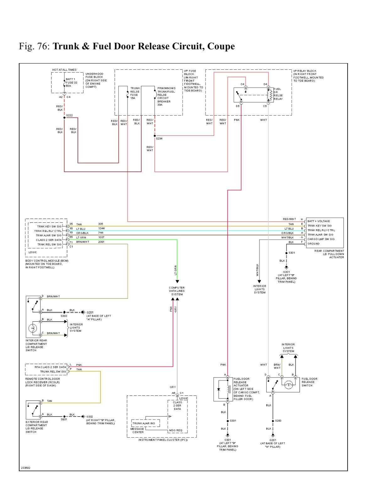

I have 2 issues with opening the hatch of my 2006 which I bought new in 2006. First, the hatch button has stopped working. I purchased a GM replacement button and installed it but it still does not work. FOB and inside buttons do open the hatch. What is my next step?
Second issue is that the hatch key does not work. The key turns to the right (clock wise) about 1/8 of a turn but does not open the hatch. What is the best way to analyze this problem?

OP stated he replaced the hatch button in the first post. Best bet it’s a wiring issue, so I’ve attached a diagram which might help.
