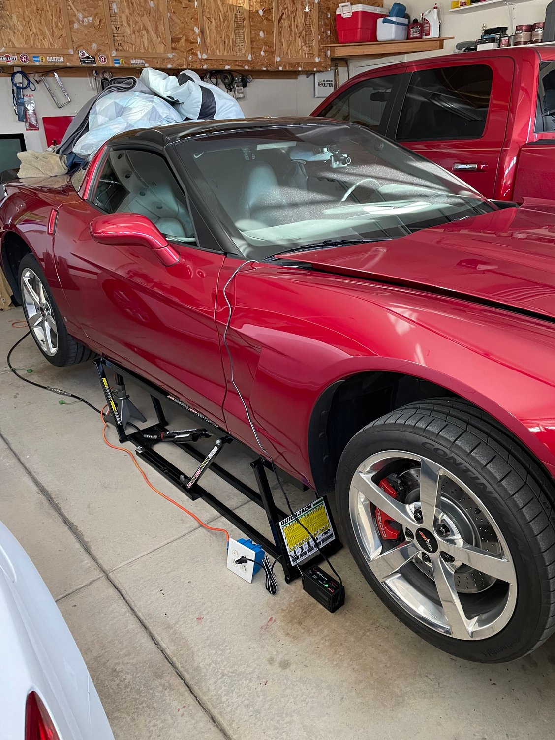

All winter long not a problem. I won't take her off the jacks until May 2023
