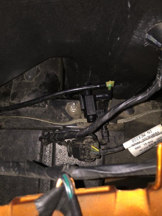

It's probably the vacuum solenoid that's fused. Happens often enough. To check if that's the problem, disconnect the electrical connection at the solenoid. The solenoid is located behind the passenger side taillights. The solenoid is not expensive, and it's a DIY replacement.
Here's a pic of the solenoid. I believe it's under a rubber cover which you need to peel back (I could be wrong).

Mine was acting up, and the solenoid in back by the taillights was the fix.

I had the same problem - blowing the fuse. It was the module referenced above, easy fix.

Thanks everyone for the information and recommendations. I check the solenoid and that the problem. I already replace with a new one and its working good.
