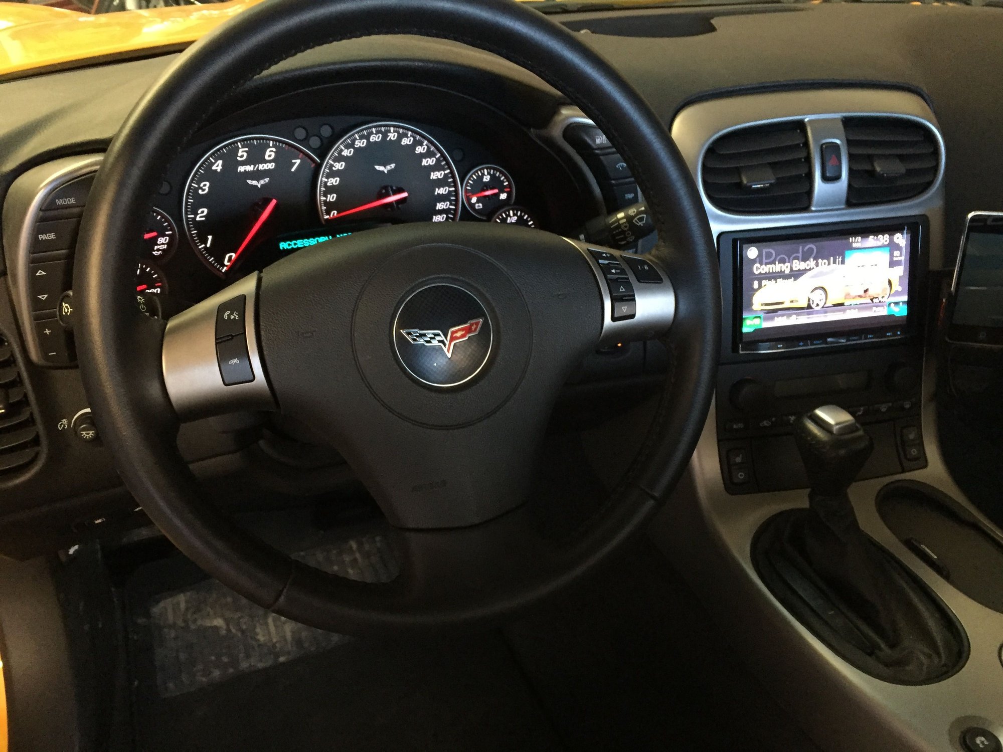

I installed a steering wheel from a 2012 on my 05 so I could add steering wheel controls, of course, as you know, the 05's air bag doesn't work on the newer steering wheels. I had to change the clock spring to a 07+ clock spring, the air bag I bought off eBay,,and the steering wheel I bought off the "For Sale/Want To Buy" section of this forum. Then to have the controls work, it involved swapping wires from the new connector on the new clock spring, to the old connector, then running three new wires to my aftermarket head unit. I'm sure if you install a wheel with out an air bag you'd throw some codes and have the air bag light illuminated, besides, like previously mentioned, probably wouldn't be a good idea. Here's a photo of the newer wheel on my 05.

I agree that is an improvement. I’m not concerned about radio controls, and I really would like a flat bottom steering wheel. As you mentioned, my concern is throwing codes as well as connectivity.

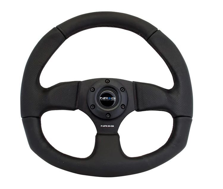

Here ya go. Flat bottom leather steering wheel with no airbag from $145.99.
https://getnrg.com/collections/steer...-wheel-leather

Pretty much what I’m looking for! Question remains about error codes. Any way to defeat them?

Two 2.2-ohm resistors substituted for the airbag will keep the light off. Check the NRG link above, they have everything you need.

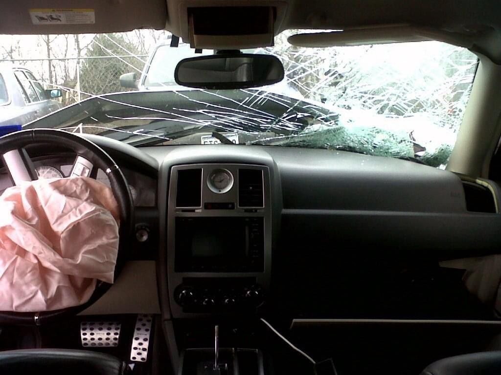

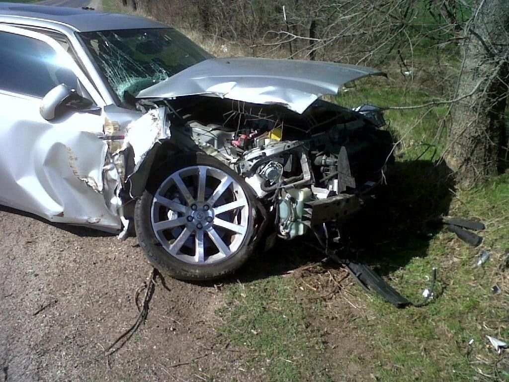

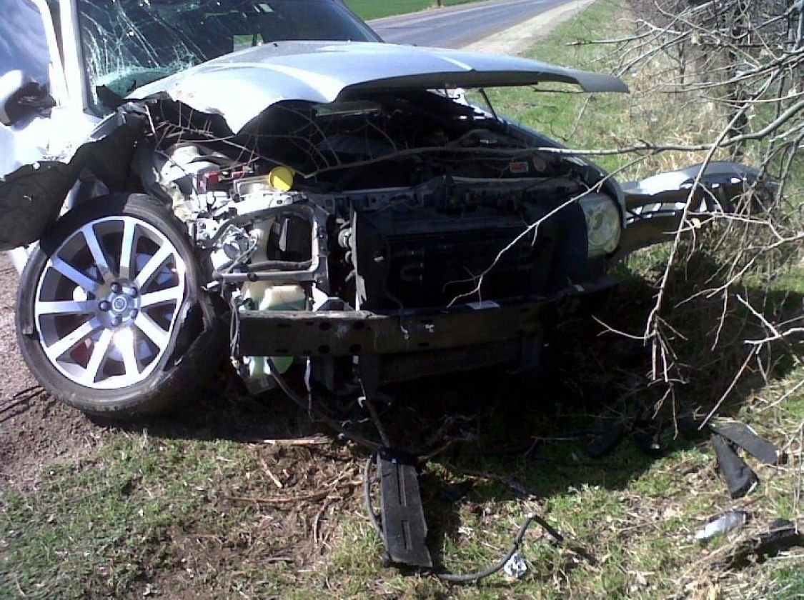

This was my Chrysler 300 SRT8 after my front tire blew out and sent me head on into a telephone pole at 60 mph. I wear my seatbelt 100% of the time but am happy I had the airbag. No way I'd give it up on my Corvette.
