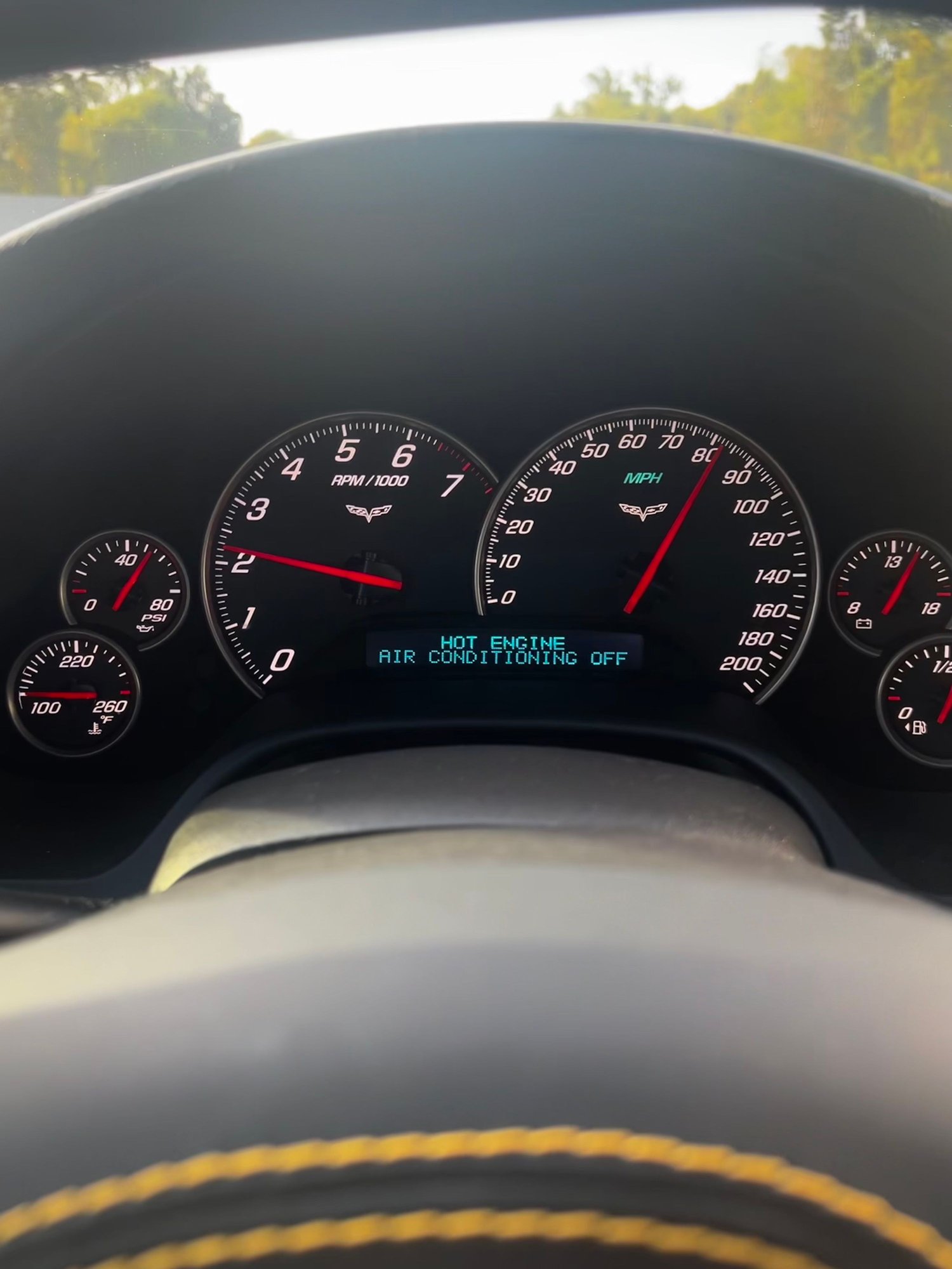

Can somebody for the love of god please help me get to the bottom of this error message?! This sporadically pops up and shuts off my AC and my coolant temp reads “XXX”. I’ve already replaced the coolant temp sensor so I know that’s not the issue. I am running a 160 degree thermostat that was changed over a year ago. It was a different size than the 180 tstat that I replaced which I thought was odd but it didn’t give me any issues for the first year it was installed. But maybe it’s defective and getting stuck? Is that the route I should go next, replace the thermostat? Any other suggestions? Thanks so much in advance for any help.

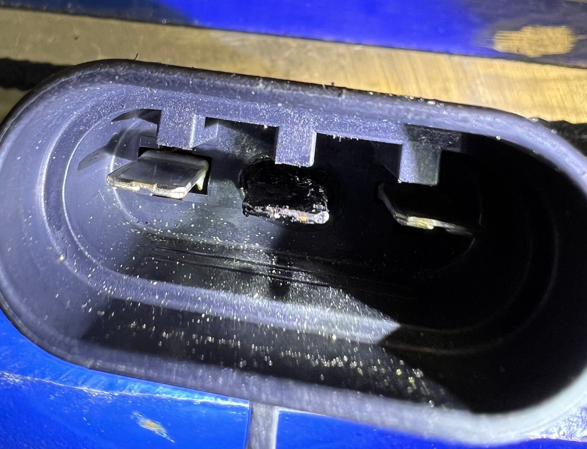

That is the exact same problem I had with my 2011 GS.
1. Hot Engine showing on the DIC
2. A/C Off showing on the DIC
3. Coolant Temp gauge not reading (needle setting on 100 degrees)
I replaced the coolant temp sensor and the inlet air temp sensor ... No fix
Unhooked the wire connector at the radiator fan motor. The contacts inside the electrical connector were all burned up ... Removed the connector and just hard-wired the wires together.
Everything back to normal.
_________________________________
This is not a photo of my connector, but mine looked just like this:

Oh ... And a big thumbs up to forum member 'C5 Diag' for coming over to my house and helping me with this problem. He even removed the burned up connector and re-wired it for me.
This POS connector just can't handle the electrical load the fan motor demands when operating at high speed.
Others here have also had the same problem with there C6.

Thanks Ron, here was your connector !!

How long had the engine been running when you got that message? What was the ambient temperature when you started it? The analog dash gauge looks to be pegged at the bottom @ 100°. And you say the DIC would show coolant temps as XXX at the same time? My LS3 warms up fairly quickly and even on a 40°F day, I’m pretty sure the gauge would be off the lower peg in a couple of minutes. Shouldn’t the DIC display and gauge be tied to the same input data? And you just replaced the coolant temp sensor? Kinda sounds like a wiring issue somehow.

it was like 64 degrees outside when I started it. Yes the coolant temp with read “xxx” and the analog gauge stays pegged at 100 the whole time. I’m thinking it’s gotta be a wiring issue as well. Joy, I hate electrical lol.
