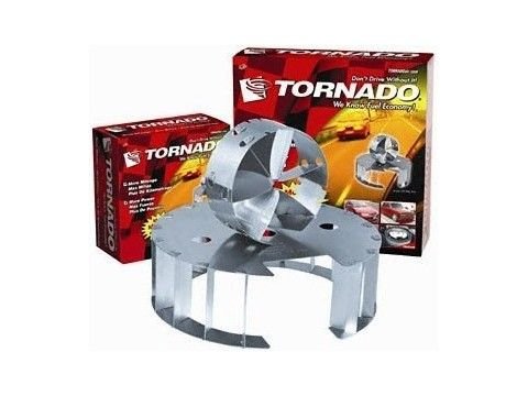

Old Sep 25, 2023 | 06:45 PM
87SAM's Avatar
87SAM
Joined: Jan 2001
Posts: 4,387
Likes: 691
From: Boise ID
The Tornado fuel saver?
