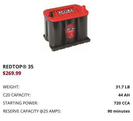

Not to add more "sh*t" to your worries, but you could also have battery drain coming from another source. I'd look into it especially if your new battery goes dead or acts quirky in 3 years or less. I would suggest the Optima RedTop battery. Shop around for lowest price...

If you do get an Optima red top it will either work amazingly well or not at all. I’ve seen many posts warning that Optimas’ are a coin toss, maybe you’ll get a good one maybe you won’t.
I had to return mine a few months after buying it, I got a full refund and bought a AC Delco agm, all good under the hood

What battery and what are the reserve minutes on the battery you have installed? Do not install an AGM battery.

AGM batteries are more sensitive to being fully drained than other types of batteries so if you don't drive it every day and it sits for more than a few days you should keep the battery on a tender. As per C5 Diag, if your battery was a lead acid battery coming off the assembly line then you should not be using an AGM battery. Hopefully he will chime in.
I have noticed that the Optima AGM battery only has a reserve capacity of 90 minutes and other AGM batteries I have looked at only had 100 reserve minutes. The Everstart Lead Acid Maintenance Free battery at Walmart has a 155 reserve minute rating.and is available in a T5 size.
