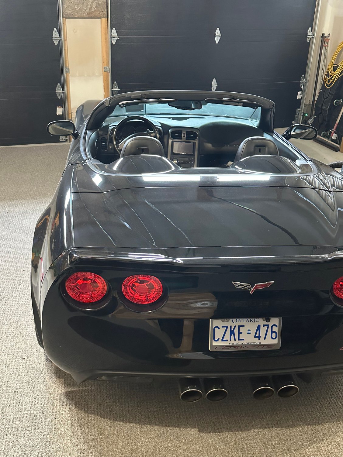

I bought my 2007 C6 in July. Uneducated as I was, I failed to notice the 2” spacers on the rear hubs keeping the wheels sitting nicely in the wheel wells. The prev owner did a rear Z06 Wide Body conversion however, he neglected to do the front end so it remains as a base model. Maybe a cost thing.
The current wheels I have are aftermarket 427 Cup/Grand Sport.
The front wheels are fine with the +57 offset because it’s the base. My rear wheels are a +79 and they would work fine on a base Corvette, but because of the Z06 fenders, the spacers are required.
I have a two options that I can think of.
I can buy a wide body kit for the front but it would be around $8k by the time the fenders, liners, bumper are bought. Maybe I do the removal and replacement or I have someone do it for me. But then I would still need to get it paint to match. Then I would need new wheels and tires. I’d be somewhere around $15k with my guesstimate.
SO… I have searched wheels. To leave the front it remains I need a +57 offset. That’s doable. The rear of my car as mentioned is a Z06 so that offset is +59. I can get a wheel with a +56/57 (same as front) because I’m within the 5mm. That’s provided I leave the front end alone, I still can’t use my wheels because of the rear offset. It’s a whole big old mess is what it is.
The car looks good imo so maybe the wheels are the way to go to save $.
However, replacing the front end would look more like the Z06.
thoughts and insights and any knowledge of past endeavours is quite welcomed.

Welcome - How about a few pic's of your Vette

Many members on here have done only the wide body conversion on the rear only. A pic would be nice, but for the most part, it should look OK with the correct wheels.
Why don't you just buy the correct ZO6 wide wheels with the correct offset, new rear tires and see how you like it. Did the previous owner get long wheel studs to make up for the width of the spacers? If not, that would be a bone of contention for many.
Good Luck

Nice looking Vette, have you thought about selling your wheels and getting some others?

I think the car looks fantastic........!
