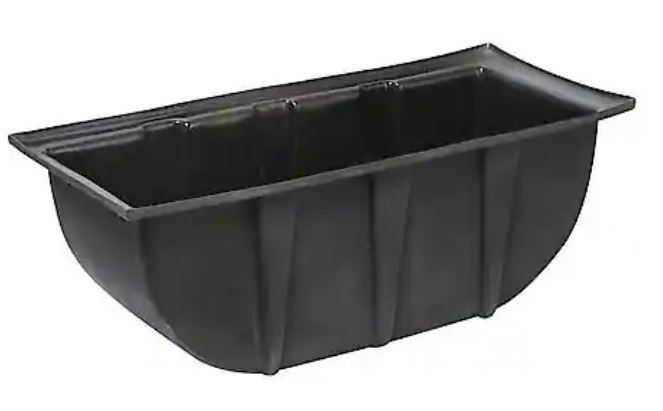

Make the dealer fix it/them or take them back. Best way to test both beads, tires and valve stems is in a tire test tank.
