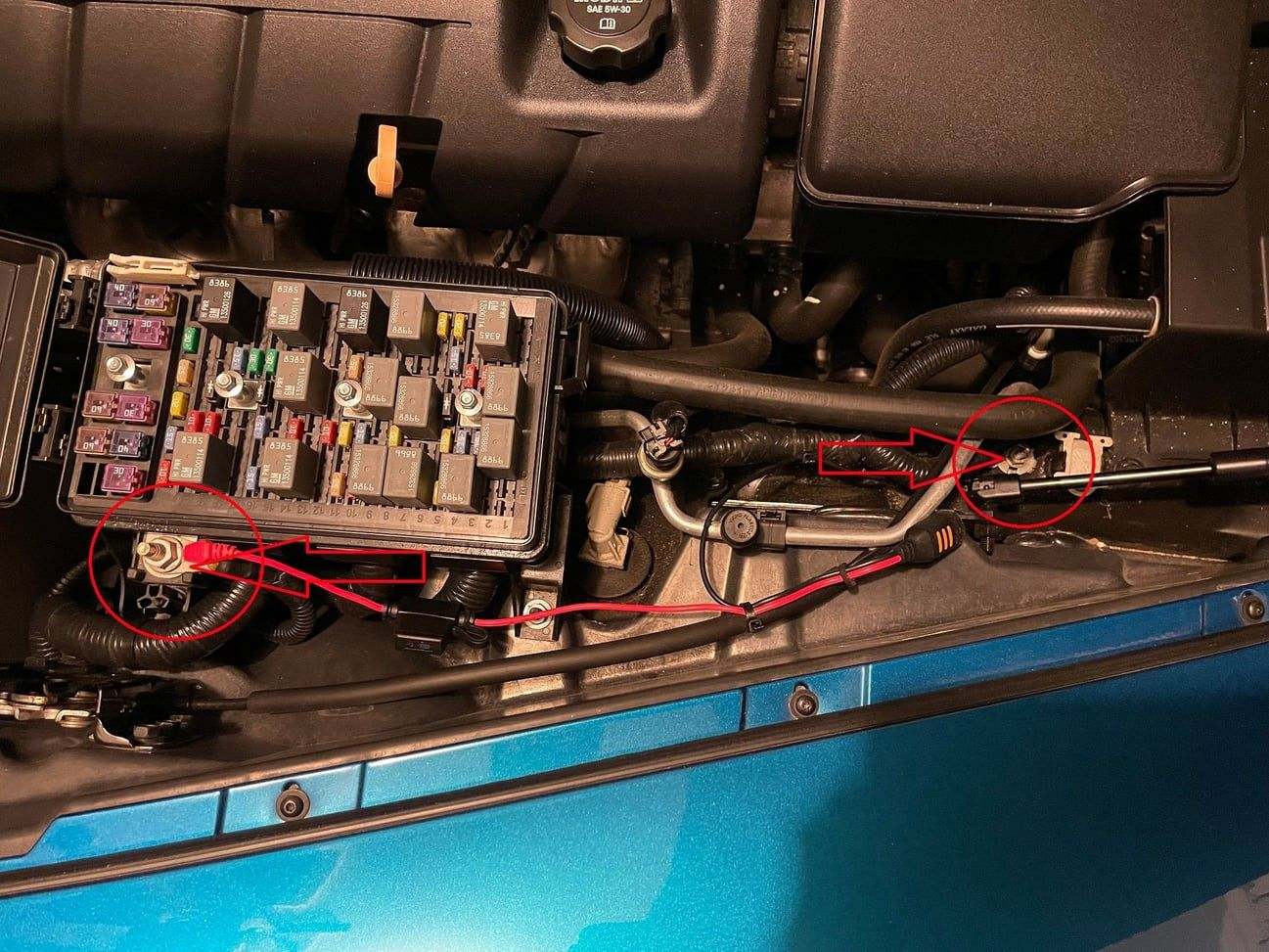

I hooked mine up as shown in the photo, then ran it out to the front grill, had to extend the wire a little so it was long enough to get to the grill, but it works great if you cover your car, no need to open the hood or doors to connect it.

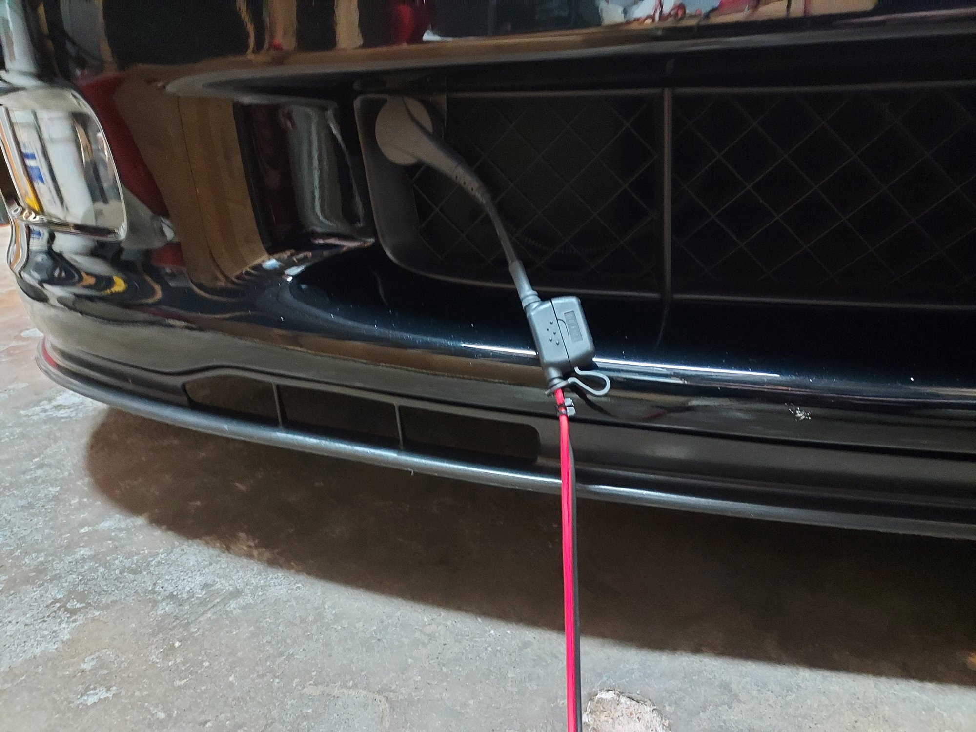

Have 2 cars outdoors with battery tenders for years no problems.put tenders on top of tires and ran permanent hook up to battery tenders.

I've found this to be the easiest way, Tender extension wire to the cigarette lighter, with an SAE\tender plug to cigarette lighter adapter, and charge it through there. There's a notch in the door sill of the C6 that allows you to shut the door with the tender wire sticking out the door, it doesn't pinch. I leave it charging this way in my garage.
