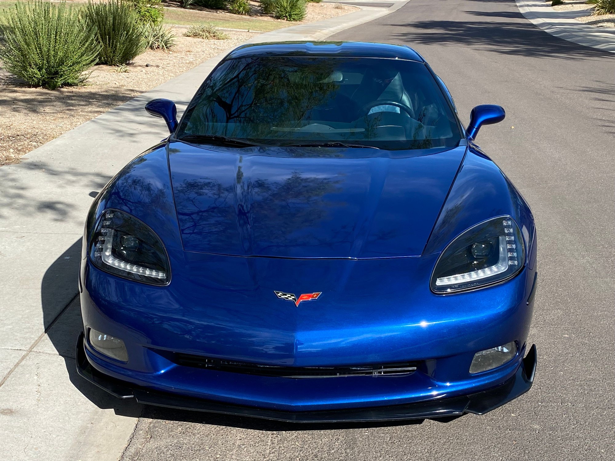

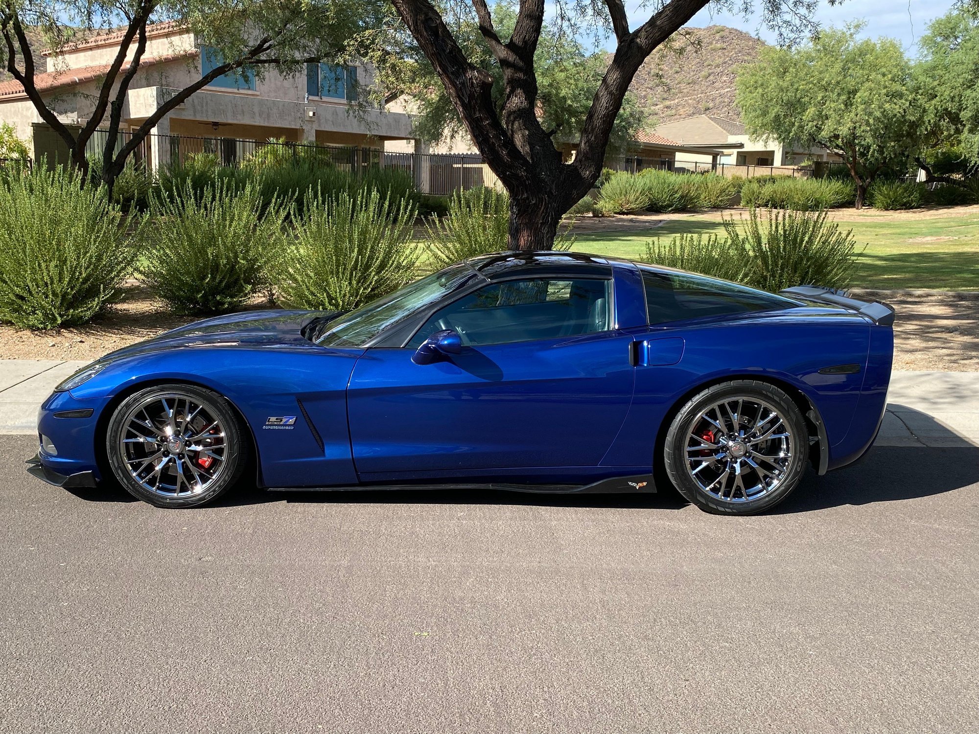

I had mine raised as high as it would go because I destroyed the first front splitter I had on it within two days. But the car still looks pretty darn low with the aero. I plan to put 19"/20" wheels at some point to fill that wheel gap a bit more.
