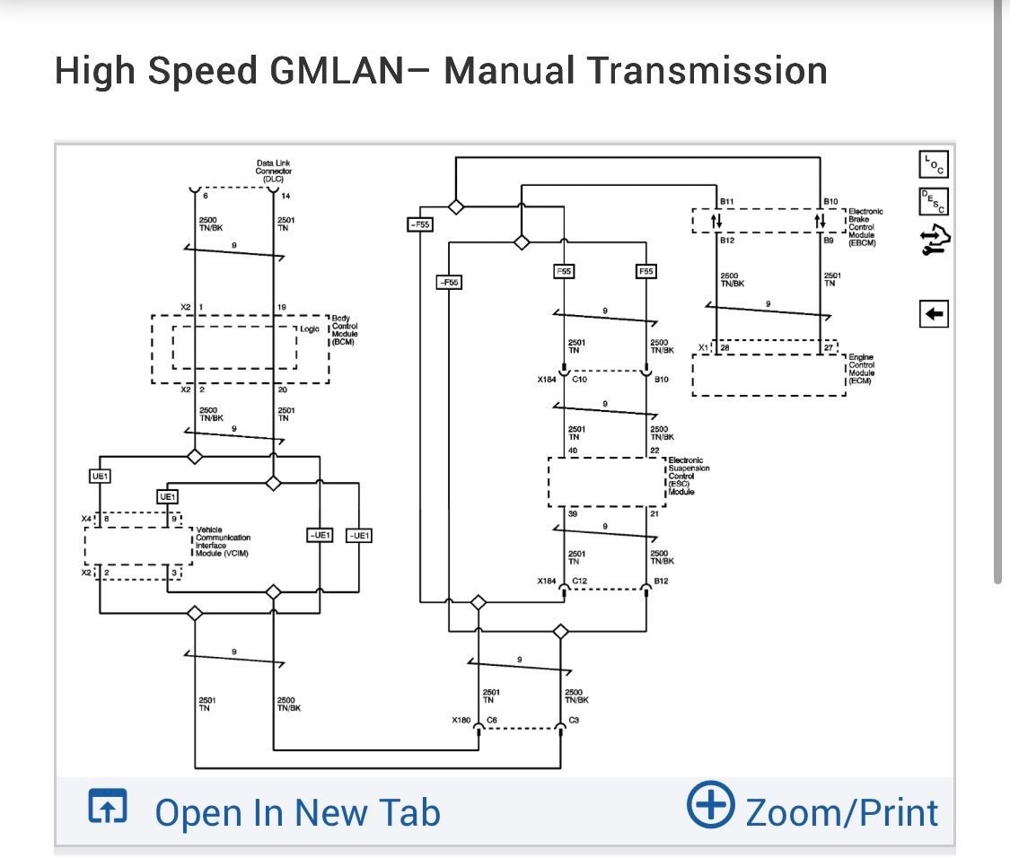

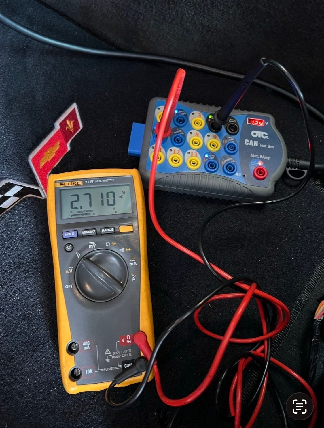

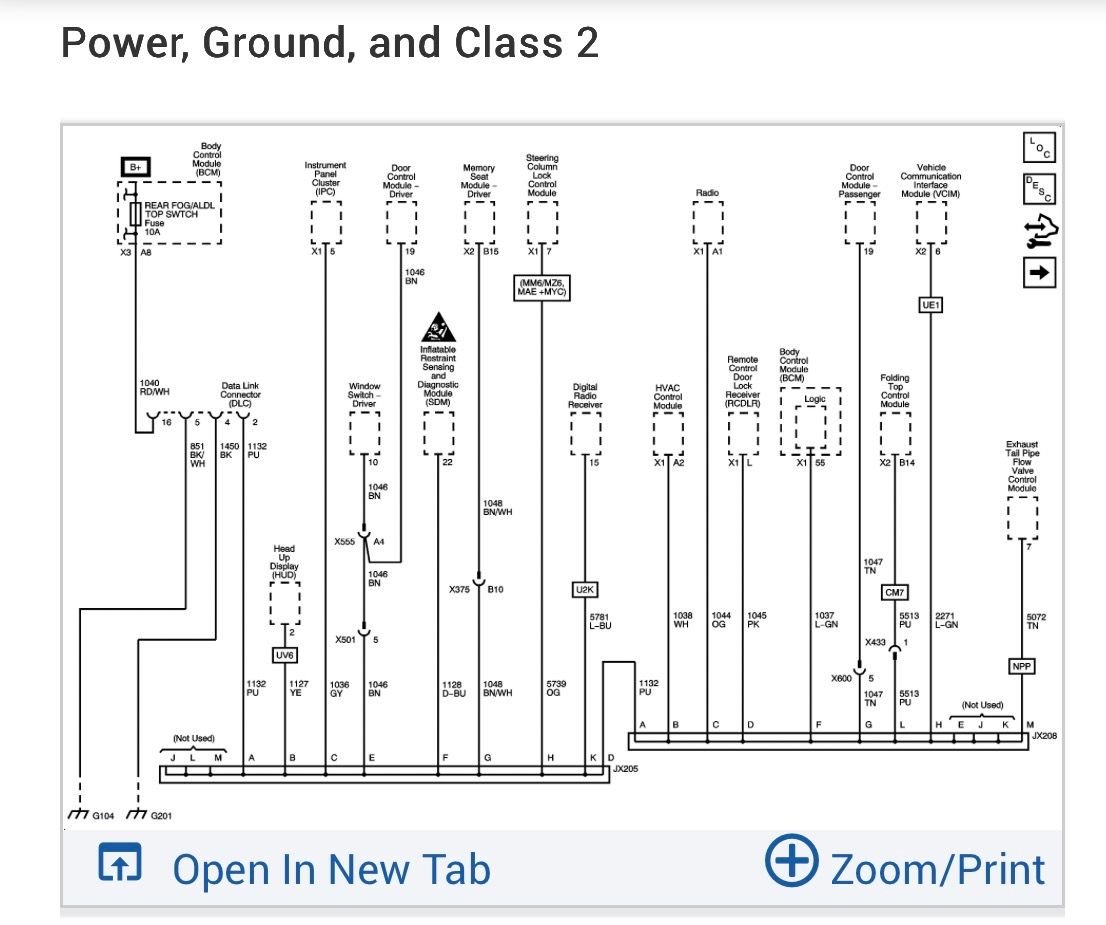

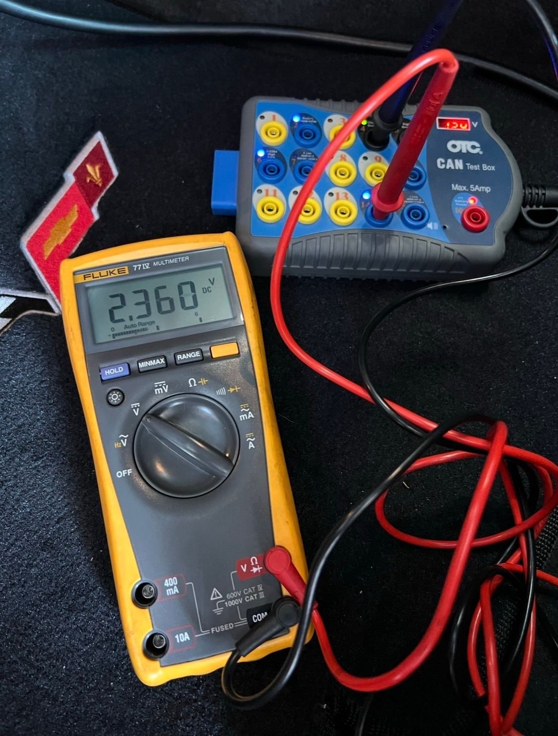

You have have around 2.5 volts on pin 6 to ground and 14 to ground...NOT across 6 and 14...the car should start in slot and if not may be bad RCDLR but can't diagnose this for you over the internet...the class 2 or low speed bus would be modules like HVAC, IPC, RCDLR and others...may be best to send the car to an auto electric shop in your area...they may be better suited to diagnose this. ..below is wiring for High Speed and Class 2...don't feel bad...maybe 1 in a 1000 techs can diagnose a communication issue.

Yes sorry pin 6 to ground and pin 14 to ground with battery connected i was getting around 1.4v.

Something is pulling the CAN bus voltage down !!...this is from 08 base...2.7 on pin 6 and 2.3 volts on pin 14.
