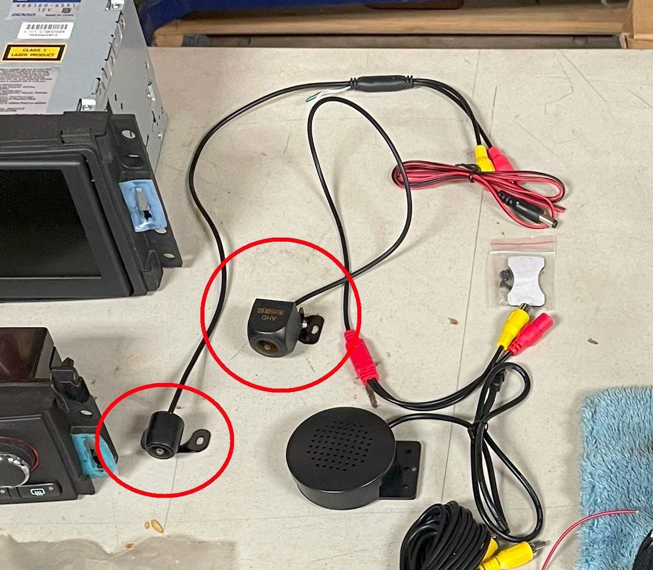

I may have missed it, but which brand rear view camera did you use?
The big screen looks great in there.
Both cameras come with the unit.

I ran across another installation video that covers both front and rear cameras and also the optional DVR camera that just went on sale in March. Fun stuff! I'll reference this when I get ready to install my front camera, and now I'm also tempted to pick up the DVR camera.
This is on a coupe, so the routing is slightly different for the rear camera.

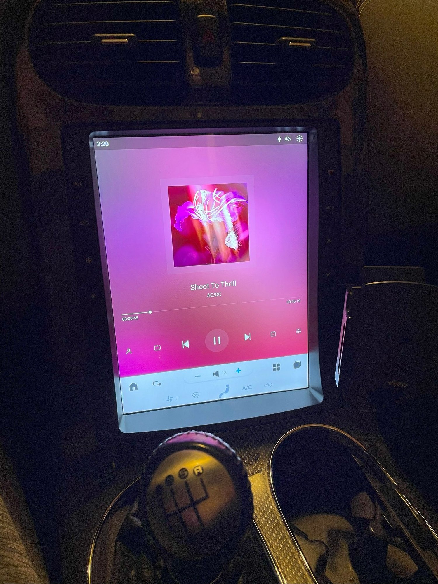

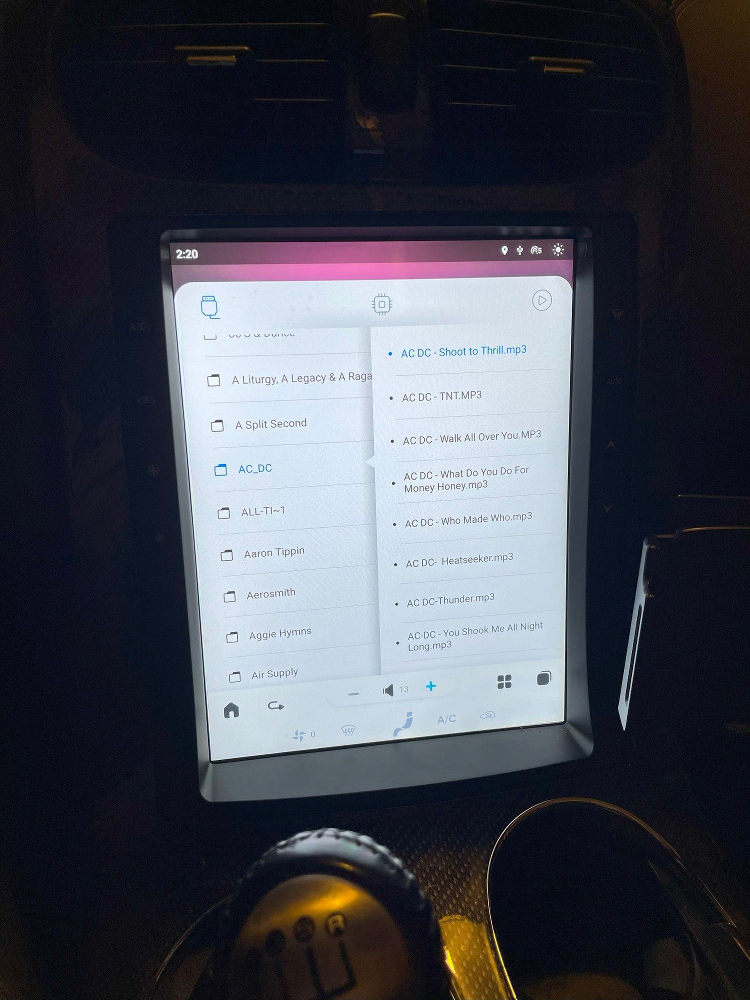

I am absolutely thrilled to report after finally getting the chance to play with it that my USB connection hack worked! I loaded up a 16GB USB key formatted to FAT32 with a bunch of random MP3s (so pay no attention to the playlist since it was just a bunch of files from a media backup folder). So those who have C6s equipped with the factory auxiliary connection in the console can still take advantage of it.
That said, @KnightDriveTV has reported that connecting a cell phone to the unit has in some cases caused strange behavior (e.g. white screen that requires system reset), so I think I may just leave this as a USB music port (and update port) and get a cigarette lighter adapter for that auxiliary power port in the console to keep the phone charged.
Yay!
EDIT: I confirmed both FAT32 and exFAT file systems work as well as MP3 and FLAC files. Now I'm loading up a big USB stick with pretty much my entire digital music library.
Oh, and, yes, I'll probably vacuum out that console. I don't think it has ever been done in its 13 years of in-service.
Now this is interesting. After testing Journey's Greatest Hits album in FLAC, I brought it back to my PC to add more music folders, and the Max-DIN just like pretty much any Android device added a bunch of folders automatically, so I moved Journey to the Music folder, and now I'm wondering what movie formats it supports.

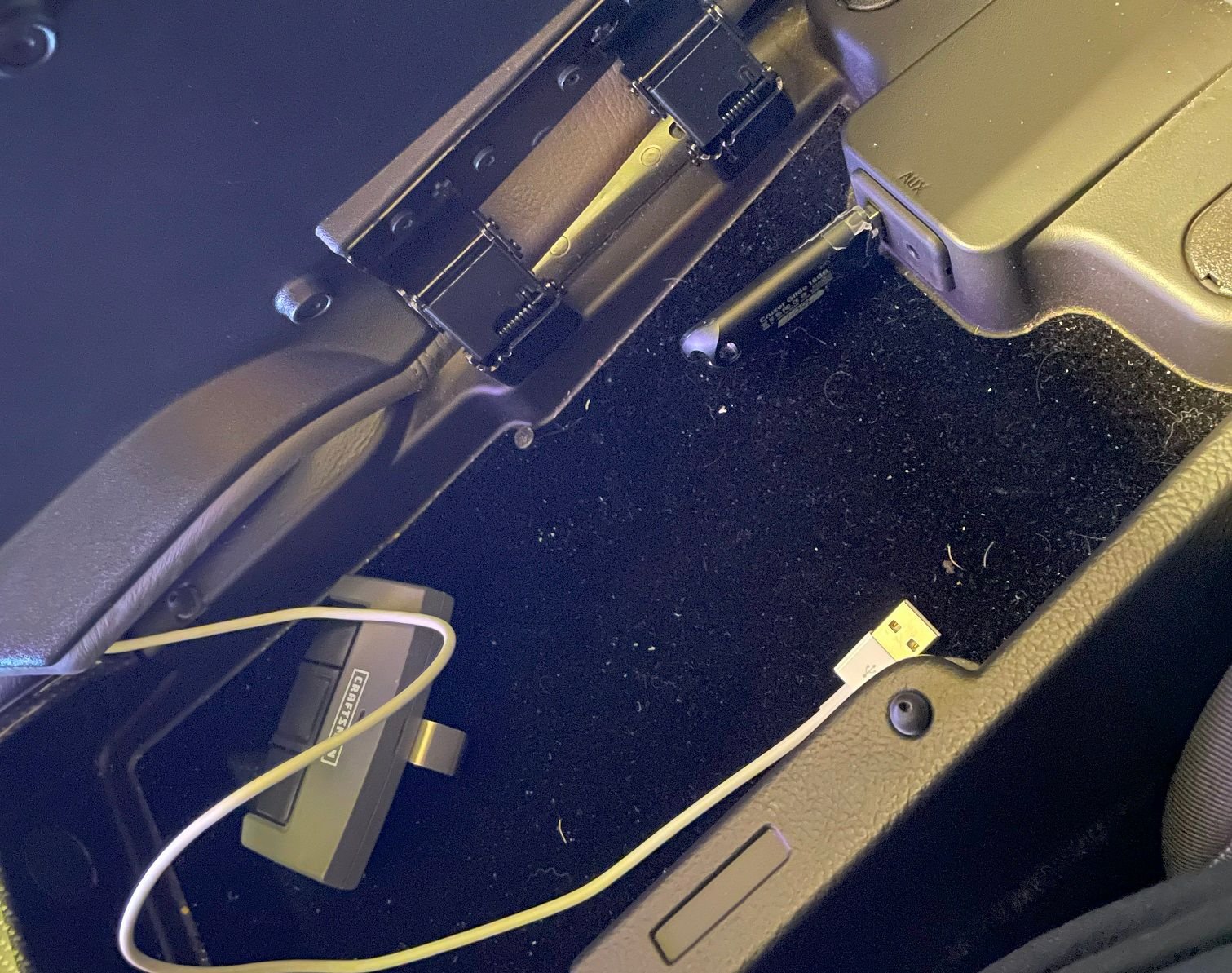

VetteVinnie, I have to ask you....why the garage door opener? I figured your GS has Homelink.
I have a very old Sears garage door openener that I bought in 1981. It has the old technology DIP switches. My GS Homelink works with it. Since I have only one garage door opener, I programmed all 3 buttons to open the same door.
BTW: Nice head unit, glad you got it working just right.
It has a Homelink, but for some it refuses to program to my garage door. I may need to get a third party repeater for it at some point. Something must have changed between 2008 and 2010/2011 because my 2008 Z06 programmed just fine, but neither my 2010 ZR1 nor the Grand Sport want to talk to it. It's just as easy to flip up the console and hit the button, so it wasn't a priority.
Does your garage door opener have wifi? If it does you should be able to download the app onto the max-din and use that to open it.
Negative. Craftsman before Sears shut down.

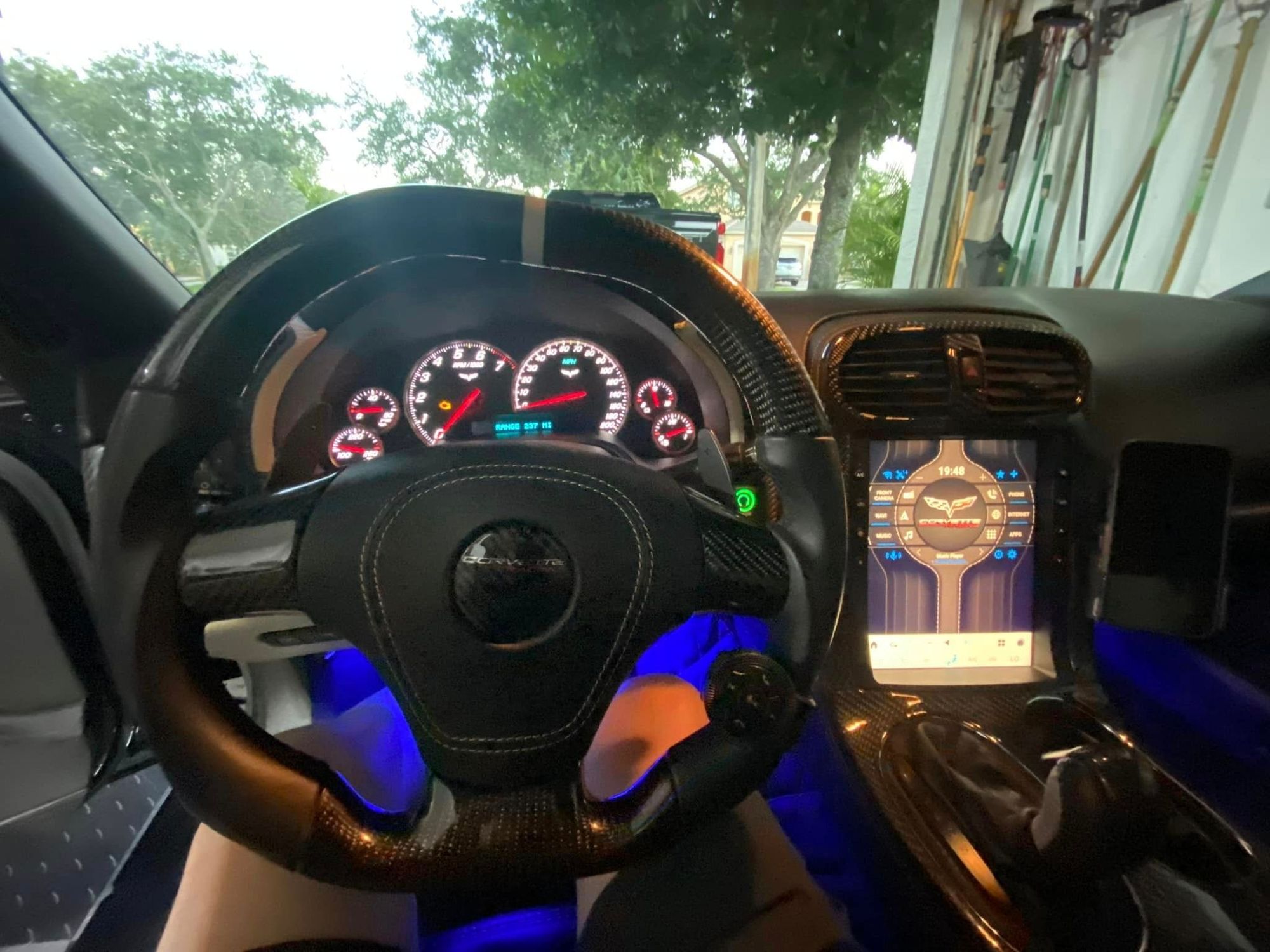

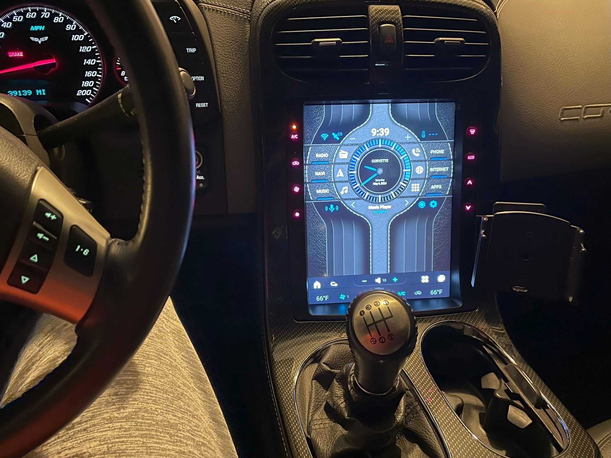

I sat in the garage yesterday and connected the unit to my home WiFi. If you've ever owned an Android phone or tablet, you would feel right at home with this system. A tap on the Chrome browser icon, with a couple logins and a search for Agama Car Launcher, took me to the Google Play store. After a brief download and install, it brought a new loading screen to the playground.
This is just the default (with a quick change from the default "Nissan" to "Corvette" and a change from red to blue theme). I left it on the clock for now since the default Corvette logo is for a C8, so now I get to go hunt for the perfect C6 logo to stick in there. Changing those buttons is super easy. Just hold your finger on them, select the app, select an icon, give it a name, and Bob's your uncle. I already set a placeholder for quick access to the front camera (the "AUX" app) for when I get it installed.
Side note, I can also change the color of the backlight on those physical buttons. Right now, they're just rotating colors. I'll probably lock them into blue also.
