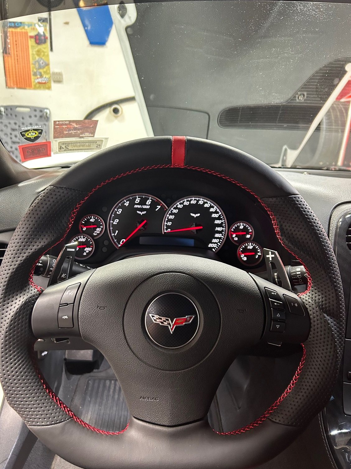

my car is a 2011, When I changed my wheel to the aftermarket Revesol one Instead of swapping the parts from my wheel I bought a complete steering wheel from ebay and used those parts for the swap. My OEM wheel had the right side controls on the wheel but not the left side (the new wheel had the Bluetooth controls) After my install was done now the left side when I hit the answer button (top button) it activates Siri on my aftermarket radio but the end call button doesn't do anything

Mine originally defaulted to OnStar, and no matter how I tried to program them they always went to OnStar, to address this I pulled the OnStar fuse in the floor board fuse box (which isn’t supported by GM anymore anyway, so no loss there). After doing so I could program them to operate like I wanted them to. If I get a chance in the next few days, I’ll try to pull my airbag, ant take a look at the wiring for the controls behind it.
