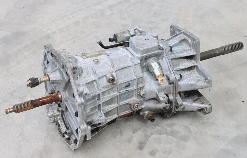

[url]https://i.ebayimg.com/images/g/2B8AAOSwoTVlU-ca/s-l1600.webp[/img]
You understand that the rear rod coupling you are changing out, is on the front side of trans itself, and in the back end of the torque tube cover void as well.
So front coupling at back of shifter has to have it bolt removed so front of shift rod can be split there when you pull the trans, then drive line from trans back has to be remove from car so you can get to the cross pin on the old coupling to remove it from the trans shifter shaft stub, install the new unit, then put everything all back together from back of torque tube rear.
Hence to change the rear coupling on the rod, you have to remove the drive line from the back of torque tube back, since not enough room to replace with trans still in place, much less less get to it, since port window through bell housing will be on top.
