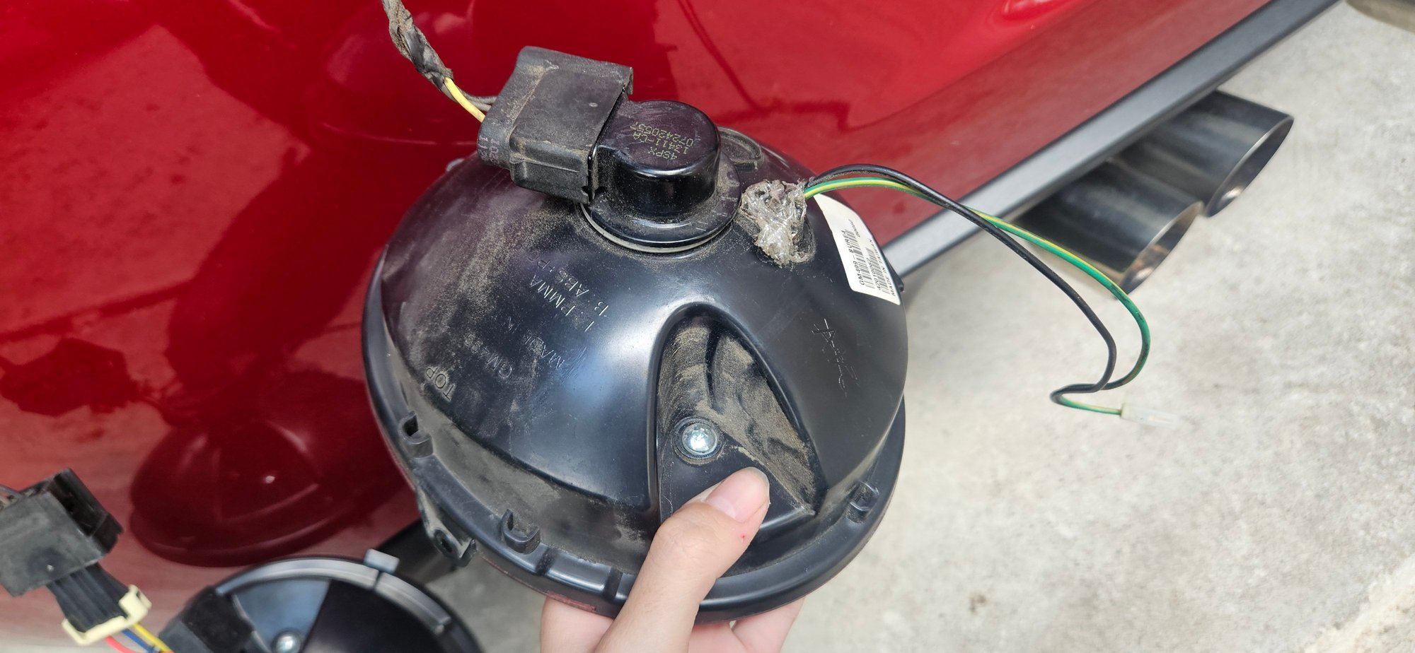

Originally Posted by FAUEE
They should have come with 4 resistor boxes. Mine were gray. They have to be plugged in, it sounds like one or more of yours are not connected.
here are what my tail lights look like...
I see that cable just hanging, where would I plug that in and what's it for?

Did you actually connect the resistors.
I didnt even get any with these lights, i now realize. the guy i bought it from said that these tails were on his vette when he bought it, and that they weren't on there. so theyre nowhere to be seen!

Contact Vette Lights as you need the resistors that were in post #2.
