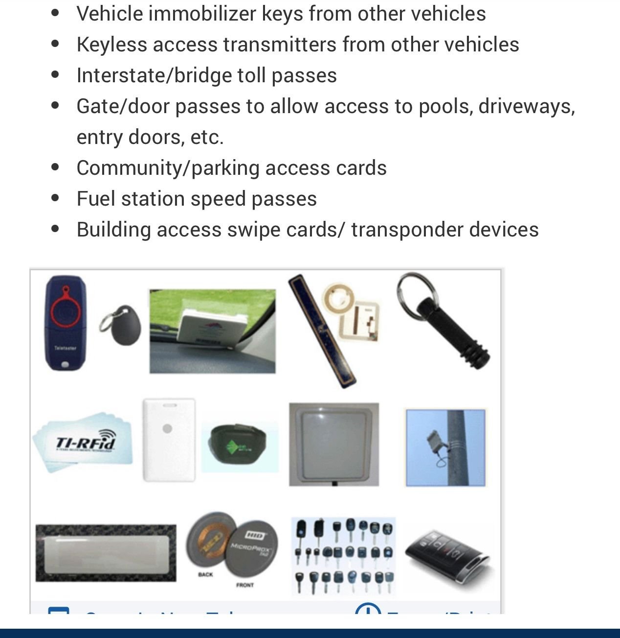

From: Etobicoke (Toronto) Ontario
The Remote Keyless Entry (RKE) system is susceptible to electromagnetic interference (EMI). There’s a section in the owner’s manual that speaks to it. Cell phones, Bluetooth devices, cell phone chargers, usb chargers, fluorescent lights etc have all been linked to fob communication issues. I’ve had the fob not found message from having the fob in the same pocket as my phone, from having the fob in the same pocket as the fob from our DD, and from the lighting in a gas bar. I’m sure you can come up with your own plan to eliminate this issue as a possible cause.

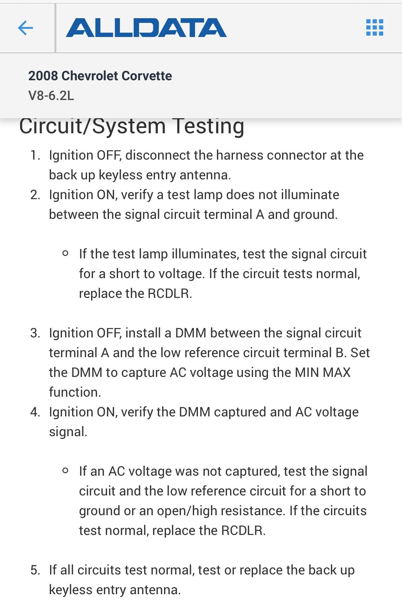

From: Cape Coral, Florida
Circuit testing from Alldata for a 2008.

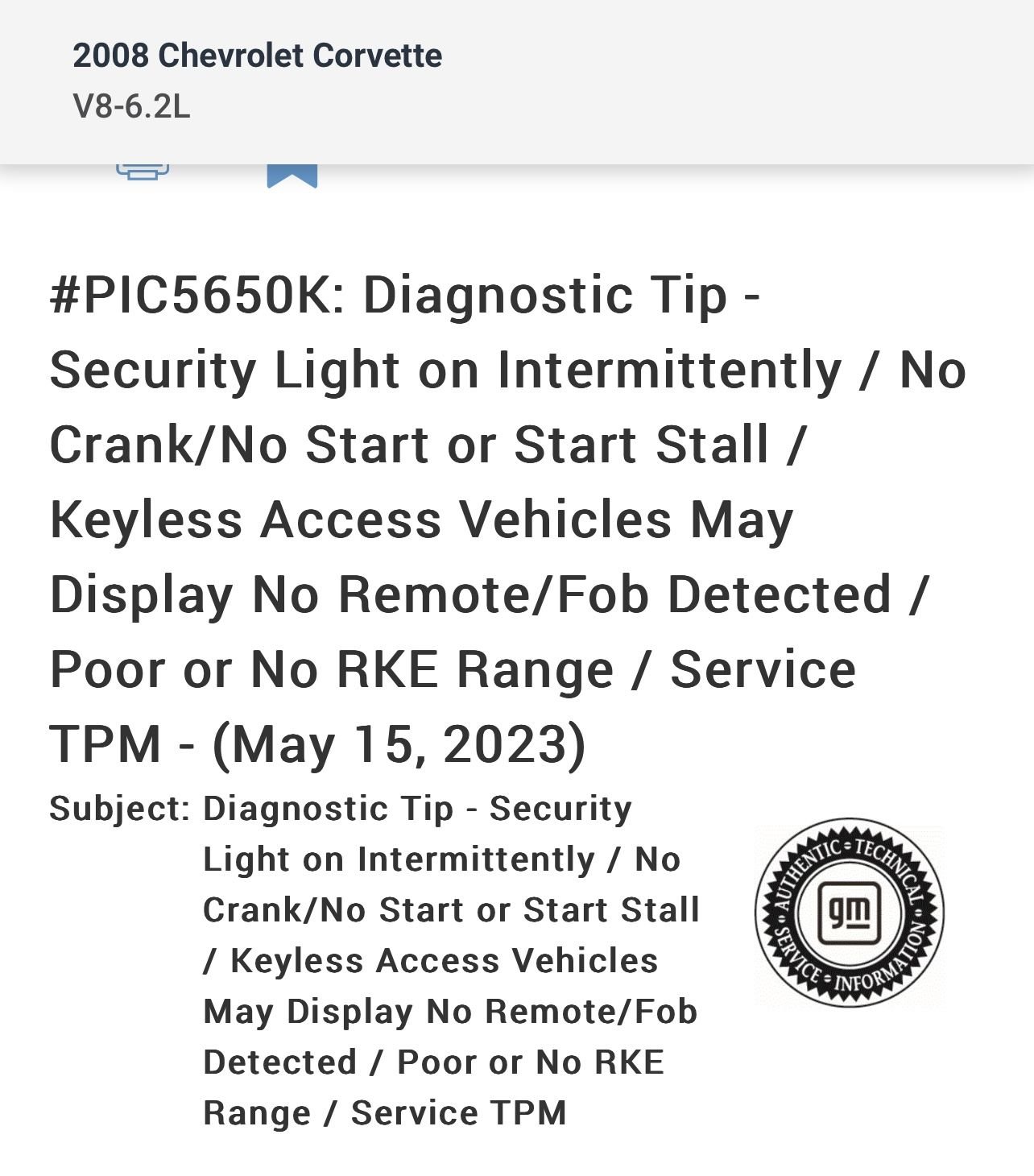

There is a TSB concerning this issue..do diagnose these cars you really need to have a “factory level” or similar aftermarket scan tool…code readers are only used to see and clear Powerplant codes…that’s it !!..if you need some more help I can use my 2008 to help you diagnose this…it’s a slow day today…with a scan tool I’d check to see if I can communicate with the RCDLR…if not checking that module for proper power and grounds would be my first check…car should start using back up antenna.

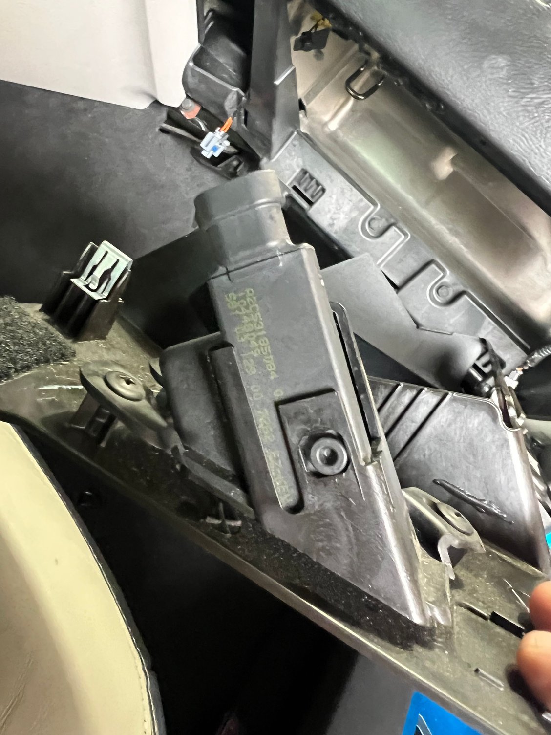

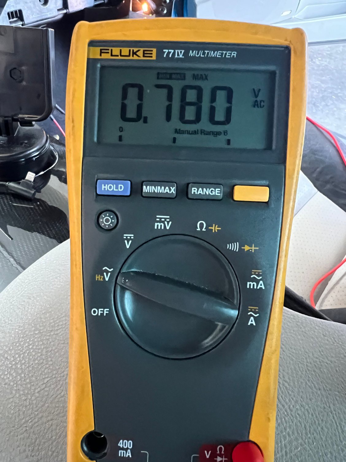

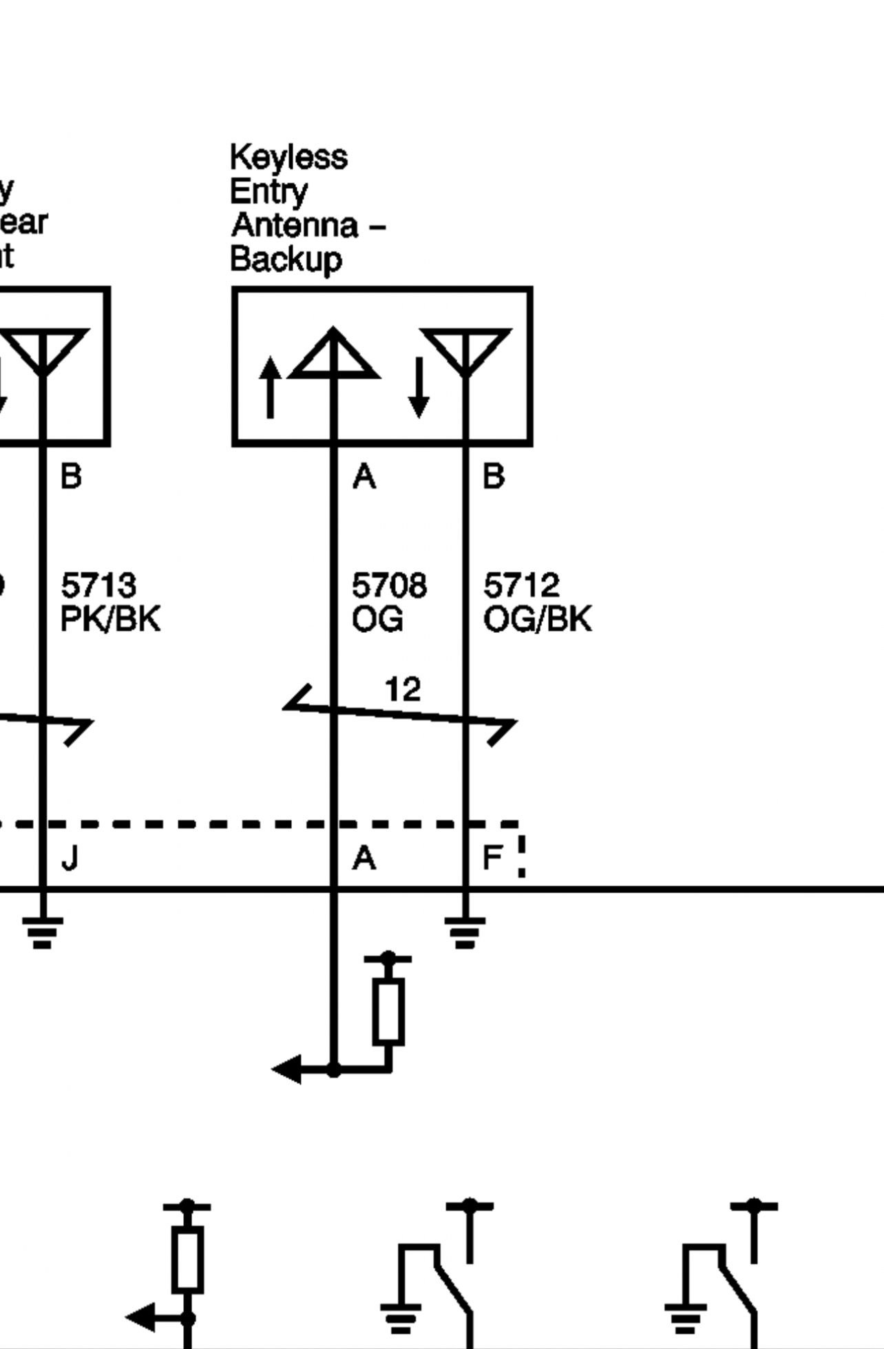

You would expect a bad RCDLR to affect both the door lock/unlock functions too…2 separate systems…the funny thing is your car will not start with the FOB using the backup antenna in the glovebox…access the antenna connector and you should NOT see the test light illuminate when test light connected to ground with ignition on probing the orange wire…when connected across Pins A and B with AC selected on your DVOM you should see some AC voltage…it will move around so if your DVOM has a “min-max” feature it will be easier to check…I saw .780 volts max….I checked resistance across the backup antenna and saw .9 ohms…no published info on this though…a few years ago I was having FOB issues on my Toyota 4 Runner…turns out my cell phone power pack which I used to keep plugged in prevented the doors from locking and unlocking and probably had a bad diode in it which was back feeding voltage into the car…that was a fun one to diagnose.
