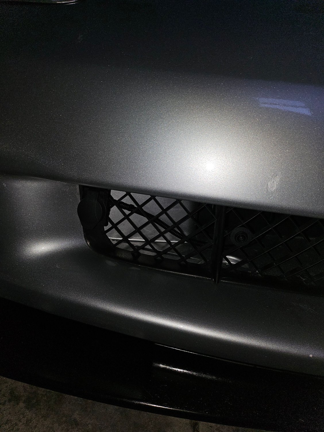

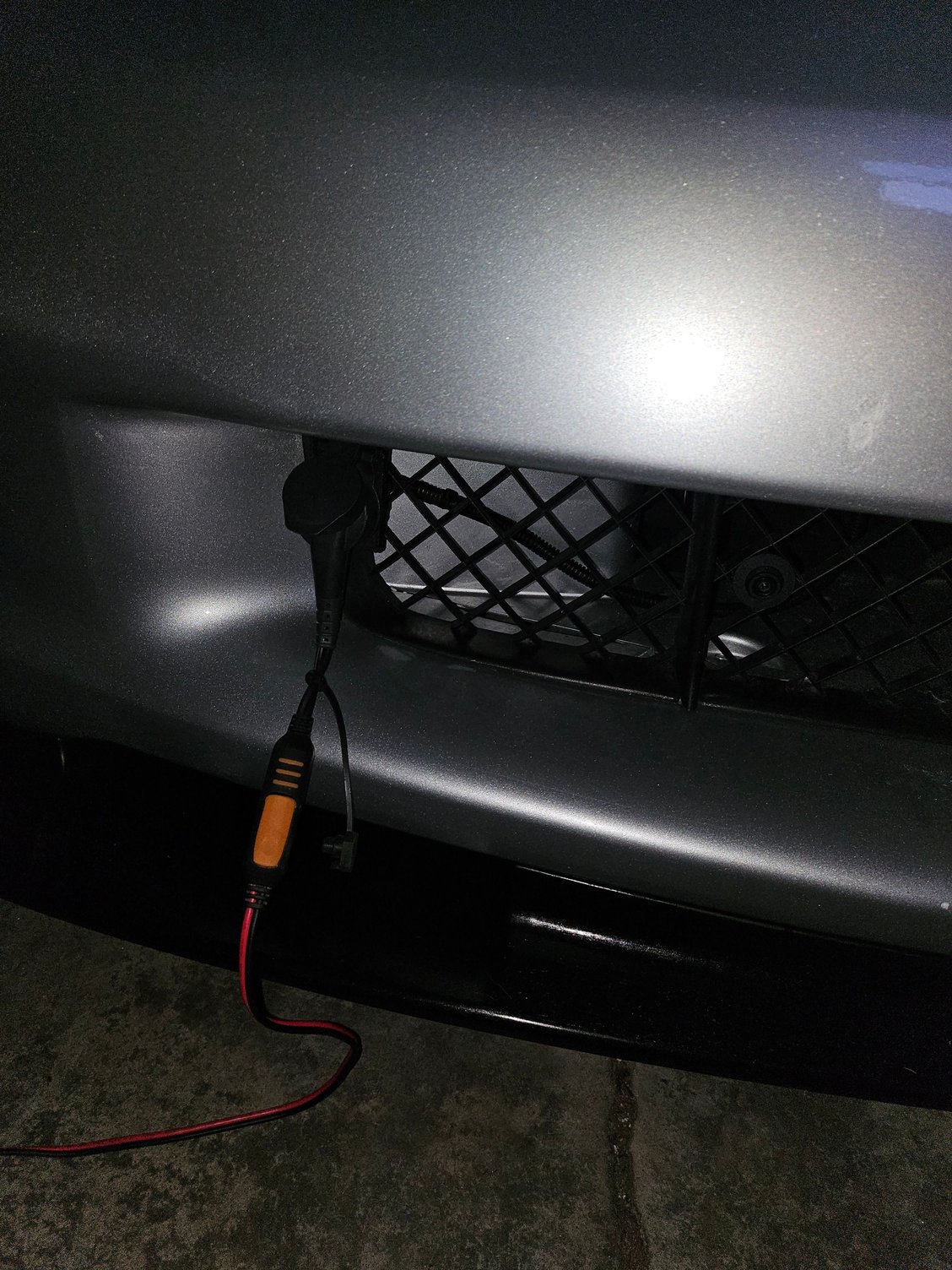

I wired the plug like turnerg1's picture shows. The connector ends are under the nuts on the cables by the battery. I figured even if the battery was disconnected I could get power via the trickle charger to open the doors etc. I did order a longer set of leads as the ones that came with the charger were only about 18"-24" long.
