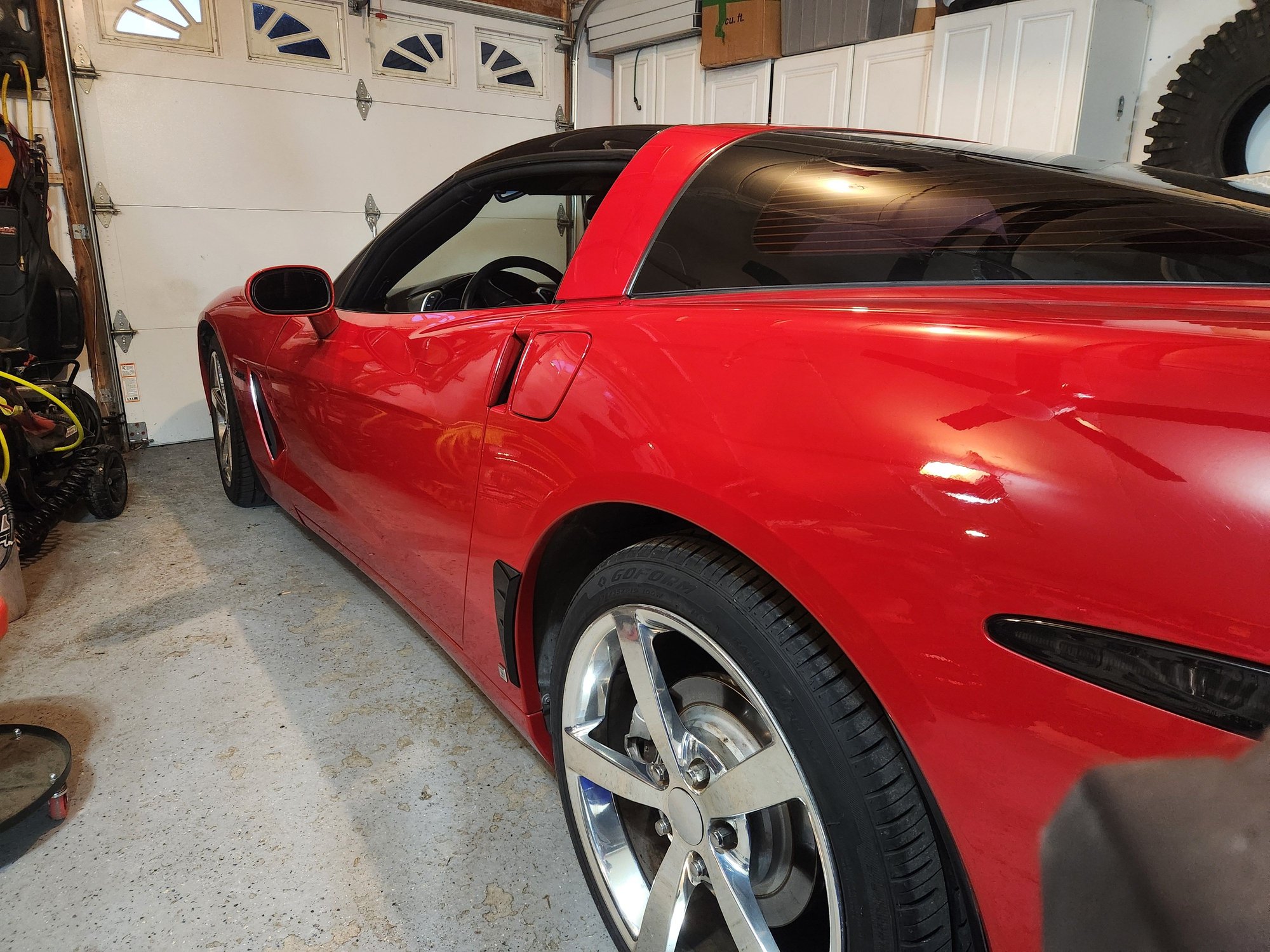

Just picked up a 05 base. Previous owner put new tires on it to pass safety. Problem 1 they are cheap off brand tires, problem 2 is the rear he put 275/40/19s.
Tires don't hook well at all so need to get new tires.
Looking at the Nitto NT555 G2s
I've looked at the forum and searched sizes but damn that gets confusing! I know I'd like wider tires all around! Is there a definite answer to what fits?m
Whats better rearm 305/30/19 or 305/35/19??
fronts? 265/35/18? 245/40/18?
i read something about trying to stay within a certain height difference F/R to avoid stability control issues?
Lots to learn on these cars, Im use to slow and way overbuilt Jeeps!
