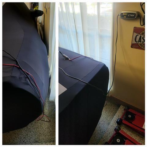

I run C-Tek and have for years. They work really well. I haven't ran my connection out of the bumper, though, but I might in the future with an extension. For now, it's just connected under the hood.

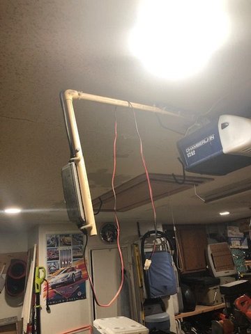

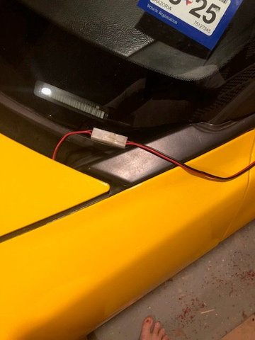

Since I only occasionally plug in a trickle charger, I decided I would continually forget (and rip the wires when I back out) if it was plugged in at the front grill. So I mounted it right at the driver's door. Can't miss it.
C-Tek is mounted to a pvc pipe attached to and plugged in at the ceiling garage opener. High enough to clear head and to hang wire on when not in use. Plugs in at wiper arm.

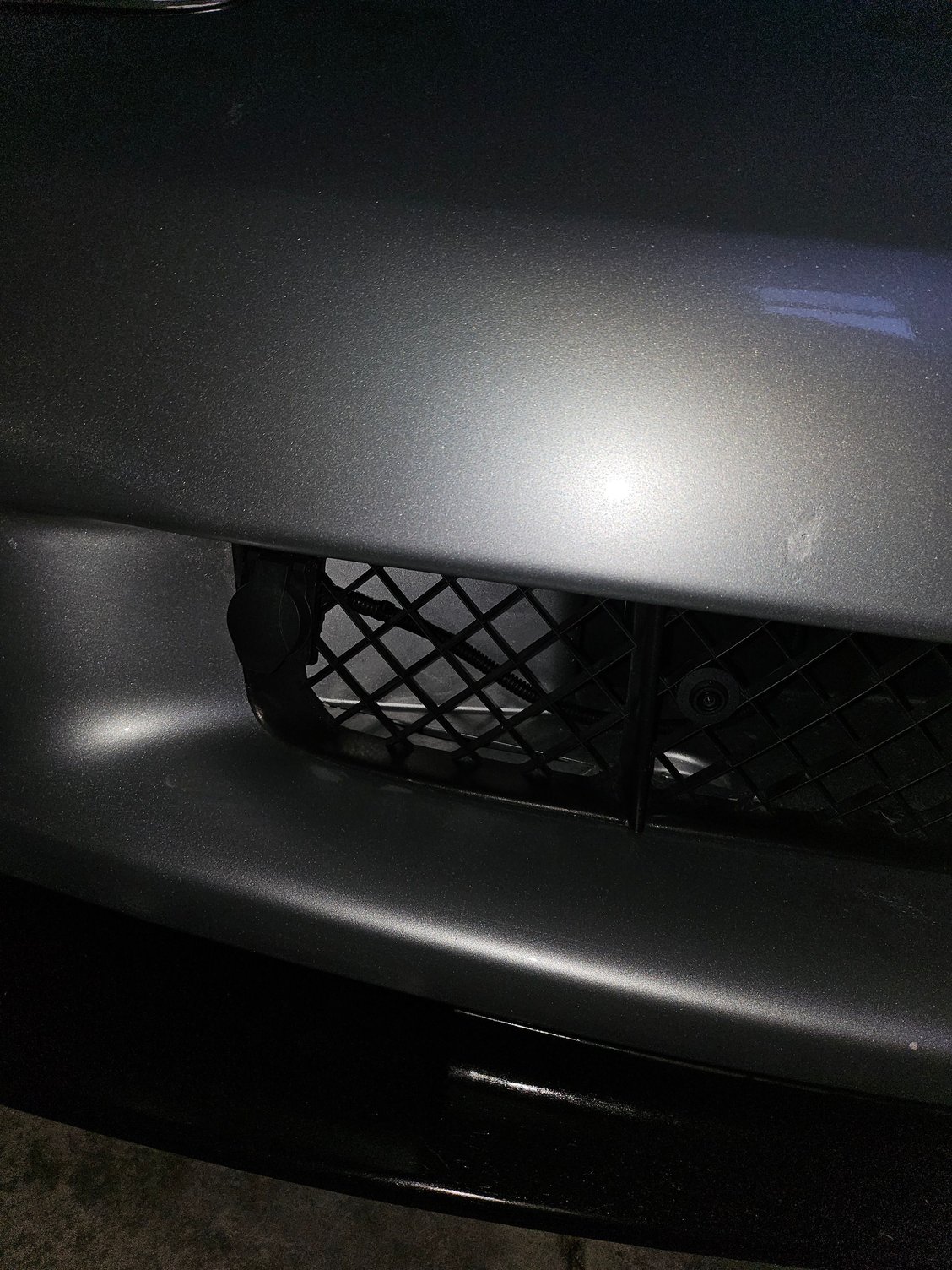

As you suggested "I ran a Deltran Battery Tender Jr. with a cord that went directly to my cigarette lighter" , works great. Even better is connect directly to the battery or fuse box in engine compartment. .Buy a deltran extension cord to make things easier and cleaner. Just use some zip ties to existing wiring in engine compartment to secure. I ran the end out one of the openings in the grill instead of bumper. Zip tie the cap to the grill and attach end to that. You can reverse it back through the opening beside. This will almost keep it barely visible. Just pull it out when you want to connect. Easy and clean. I keep the actual tender attached to the garage wall.
I used the same connection points on mine for my Deltran Battery Tender, but I got a small extension, and ran it out the grill where I zip tied it to the grill. It works fine.

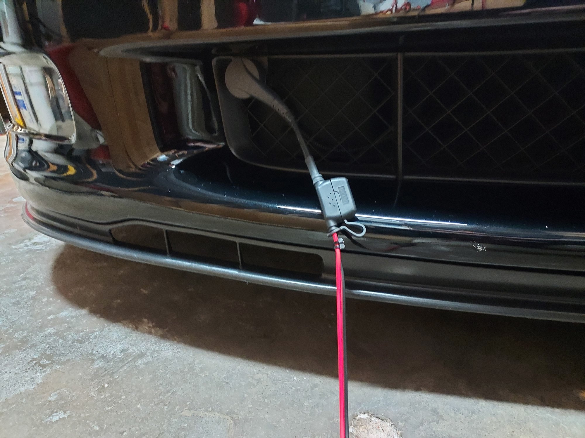

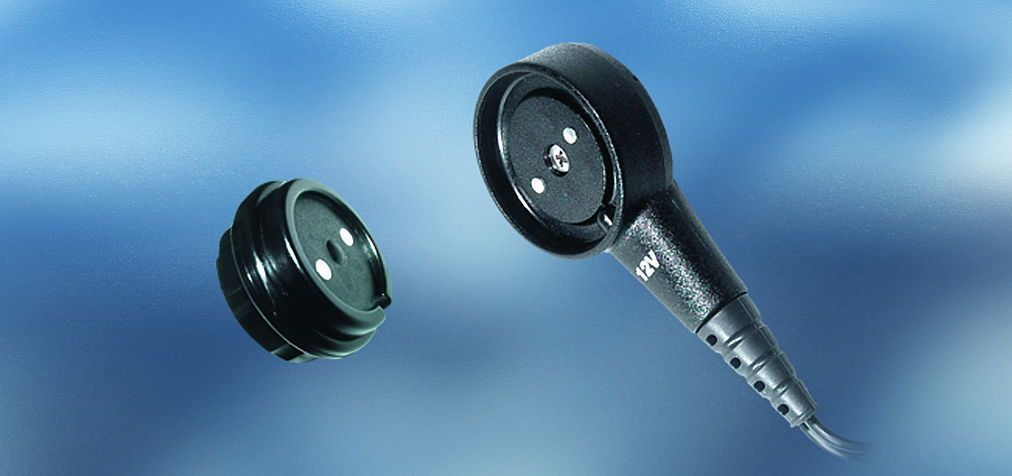

Old Nov 18, 2024 | 02:45 PM
Bigmac67's Avatar
Bigmac67
Joined: Apr 2022
Posts: 284
Likes: 138
I use a magnetic connector in front grill opening and attached like pictured above wired to fuse block and ground. Auto disconnects when I back out of garage.
Old Nov 18, 2024 | 03:35 PM
cadbob's Avatar
cadbob
Joined: Jul 2022
Posts: 1,364
Likes: 433
From: Central, Mass
I have done it every way one can and the very best way as far as for me is magnetic connection. Simple quick and clean.

Old Nov 18, 2024 | 06:52 PM
wjnjr's Avatar
wjnjr
Joined: Nov 2009
Posts: 3,299
Likes: 1,154
From: Klein TX
There's lots of ways to hook up a maintainer, no one best. This has worked well for me, YMMV.
​​​​​​Magnetic connector mounted in the grill and hardwired to the fuse box
Easy 5 sec hookup even with the car cover on.
NOCO 10amp charger/maintainer provides the juice. Always a nice hot battery.
