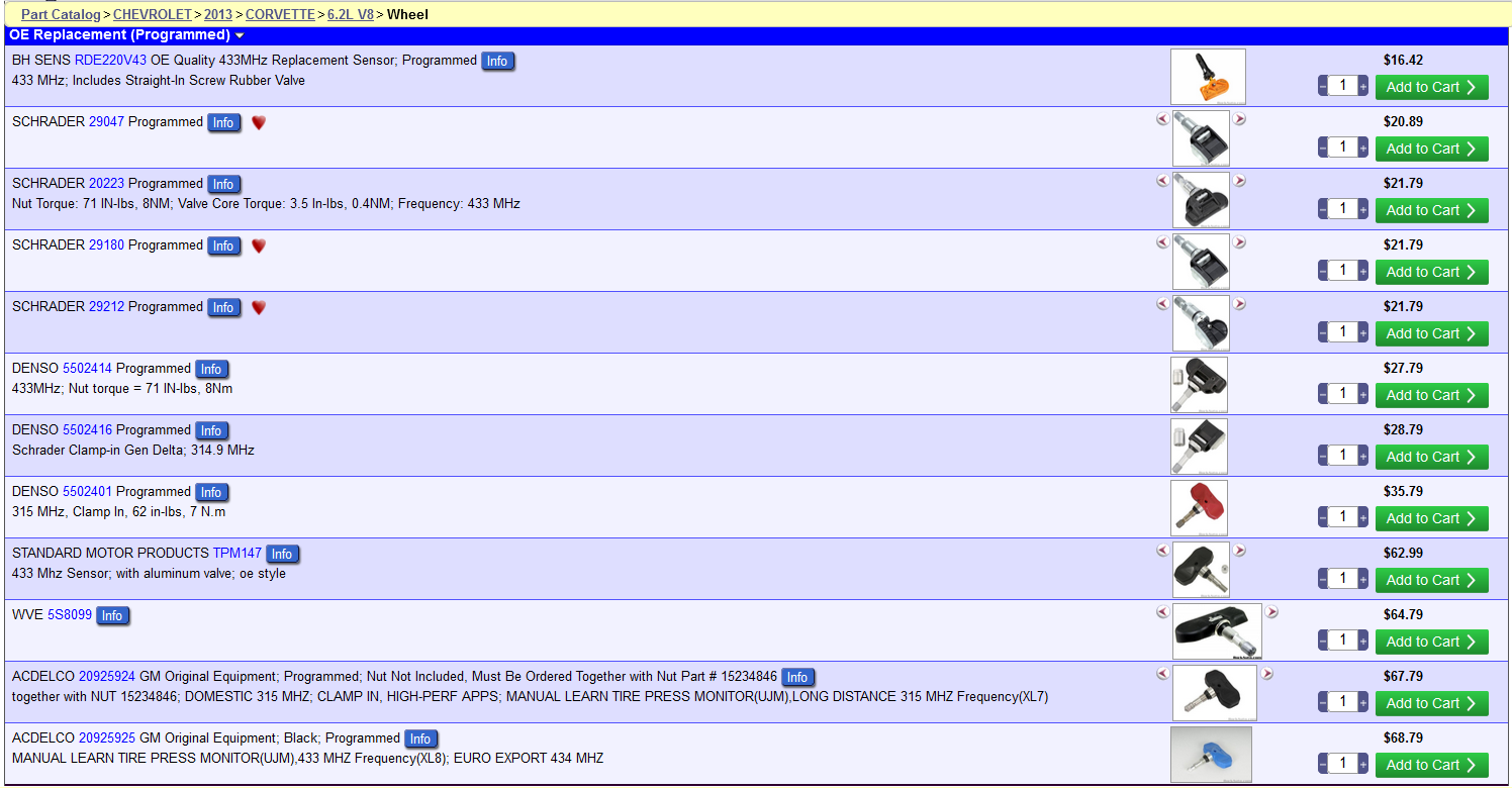

Seems like this subject should have been beaten to death by now but I'm confused by the shear number of replacement part numbers that seem nearly identical. I'm going to be putting new tires on my '13 GS in the spring and want to get new sensors installed at the same time. Rock Auto lists 4 different Schrader part numbers, they are all listed as fitting but some look physically different. The prices are almost identical. Which one is right or will they all work?

I would go to Schrader Website which has pretty good descriptions of the different sensors. Like exact fit OEM or universal application.
Site shows OE is 314.9MHz....not sure why rockauto is listing some 433MHz for your car.

Thanks, so I want the SCHRADER 29212 correct?

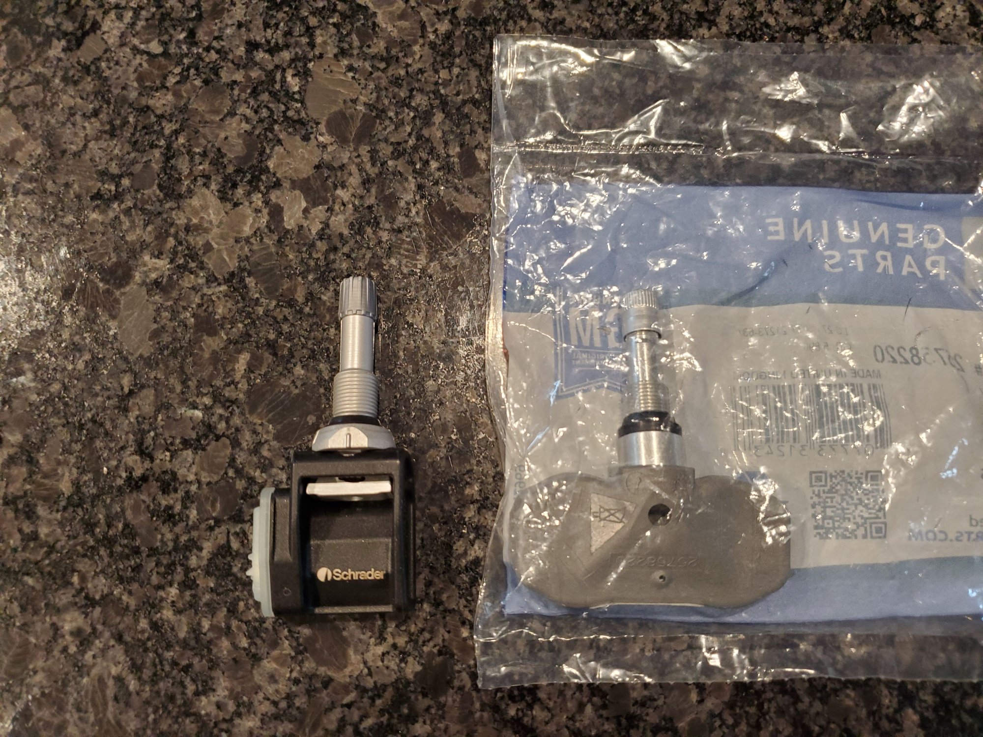

In the same boat as OP -- went here, but the schrader sensors listed here (and on rockauto) look physically different. Did they change the body shape? Has anyone confirmed the smaller sensors work?
The OEM sensors are listed at ~$130+ each now, looking for a better option
Here is a side by side from another user
The ones in my wheels looks like that and they work fine.
Appreciate the feedback -- the user who posted that picture also confirmed the smaller body versions worked w/o issues.
