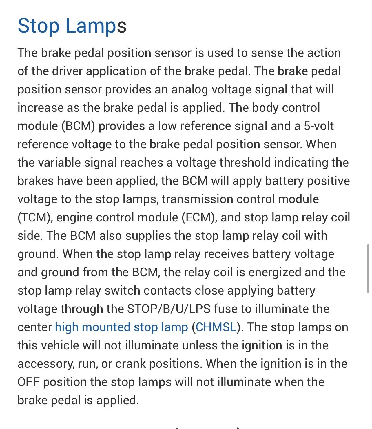

If you are able to read BCM DTC’s I’m assuming you have a factory level or equivalent aftermarket scan tool…look at your brake light inputs and see what they read on your scan tool as you apply and release the brakes…it may be under “chassis data” in your BCM menu.
