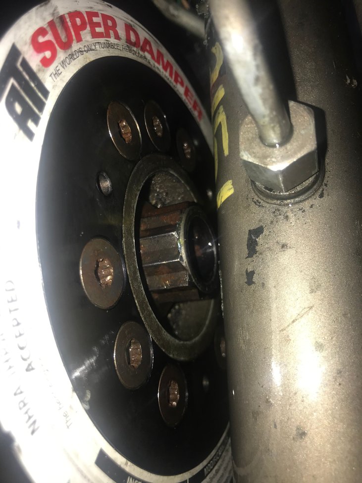

Its not a balancer, since the engine is internal balanced.
Its a harmonic dampener, and the only thing you have to worry about mostly, is the center rubber dampening part, coming unglued from the inner steel and outer steel pulley hubs that is was bonded to,
Or worst yet, it has been change, but someone did not install the new one correctly, the bolt comes loose, and the whole unit walks off the crank snout to eat either the power steering cooler, or steering rack instead.
