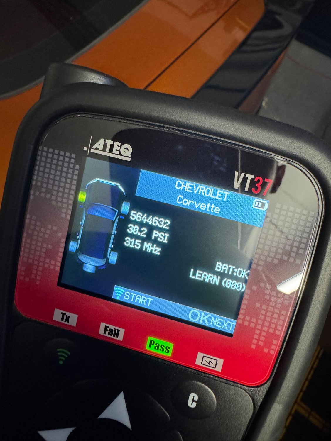

Hey so I bought new wheels, tires and TPMS sensors (from TireRack, they are identical to the Shrader ones at RockAuto) for my 07 C6 Z06.
The TPMS relearn has been incredibly annoying, and it’s not working. I have tried 3 different devices:
- the Amazon basic unit
- an Autel at a local tire shop
- the ATEQ VT37 recommended by Tire Rack
The last one allows me to check if the sensors are even alive and I can confirm they all work as expected.
When I put the car in relearn mode (accessory mode and then hold lock + unlock until the honk), it’s completely random. Sometimes just the first wheel (front driver) triggers the hook. Sometimes the second one too. One time the second wheel (front passenger) triggered a honk but not the first, and the third worked too (rear passenger) but not the fourth (rear driver). And many times, it just doesn’t honk at all. Nothing.
It drives me nuts. I’m seriously losing my mind on it because I know the sensors are working and randomly the car will manage to recognize one or two at a time.
Has anyone ever dealt with that? And hopefully has a recommendation?
Thanks in advance!
