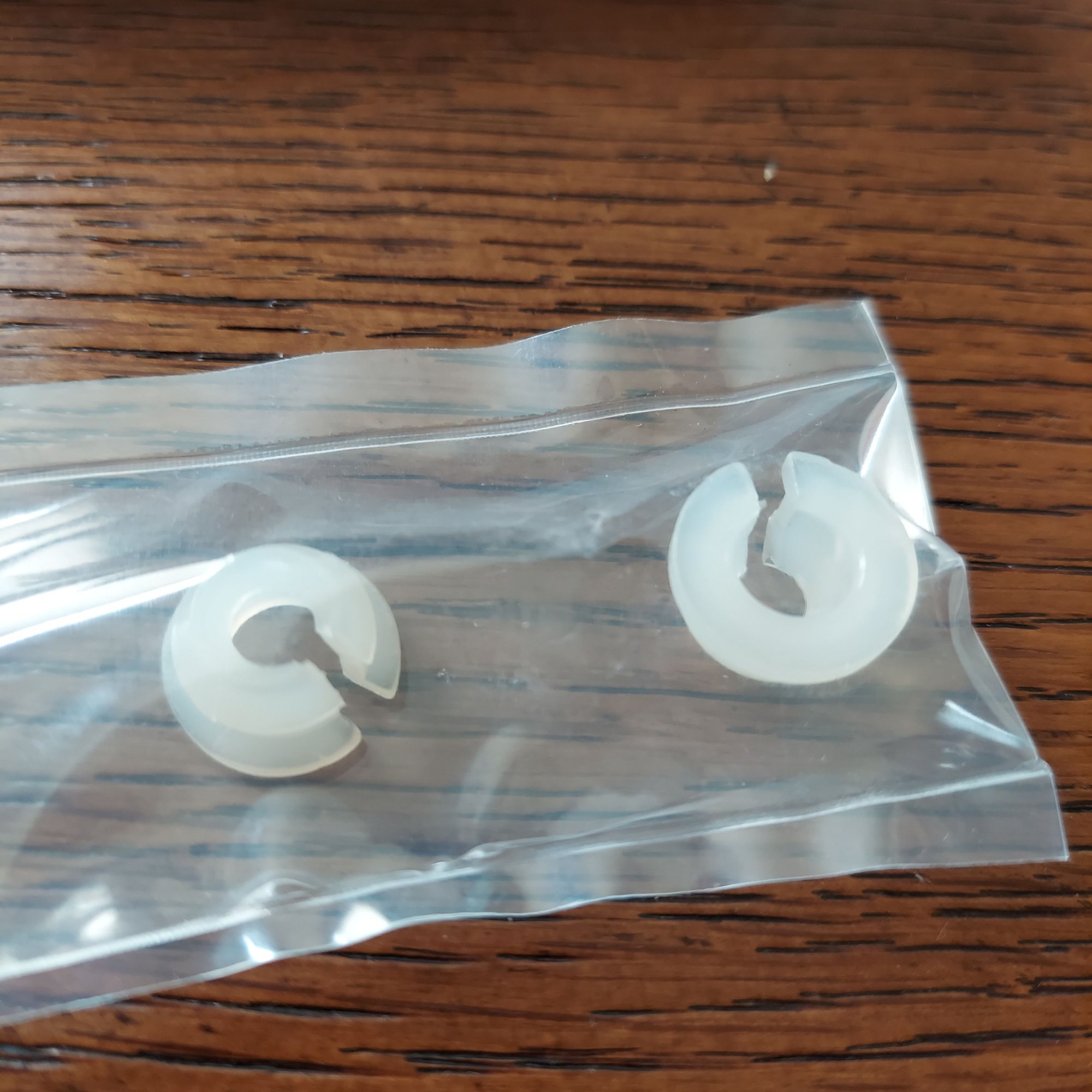

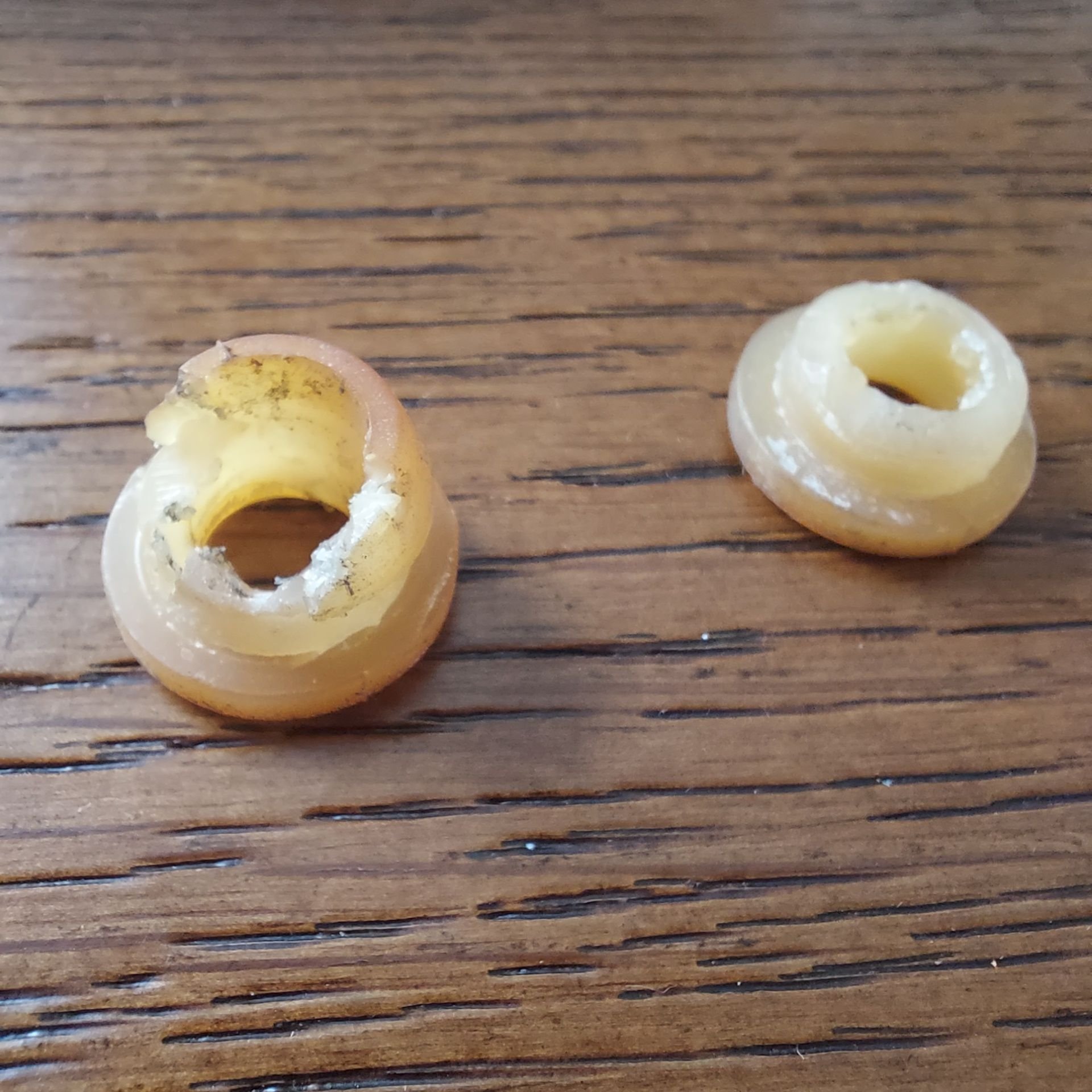

So thanks to this forum, I had some proactive maintenance done on the Vette today..AND SO GLAD I DID!!
The FORUM had been saying the shifter linkage grommets can become brittle and break, leaving you stuck in the gear you were in when they break..not a matter of if, but when..
MAN, WE'RE YOU GUYS RIGHT!! 👍👍
Mine were holding on by a thread, and super crumbly!!
Luckily I had the work done before disaster struck!
Thanks to all of you out here for the great information! (3 pedal guys need not comment) 😉

Mine is an 08 (17 years old) with 17000 miles. I went to replace them as a preventative measure and I found them to be spongy and nearly impossible to remove. They were like new. My guess is that the grommets on lower mileage and/or cars kept indoors would be fine. I regret replacing mine being that it was such a PITA.

I wonder if the brittleness has to do more with higher mileage cars, in which the grommets would be subjected to more heat than a lower mileage car?

Just curious if you went with the split style grommets from C&S Corvettes (my choice this time) or the Dorman ones?
Bob
