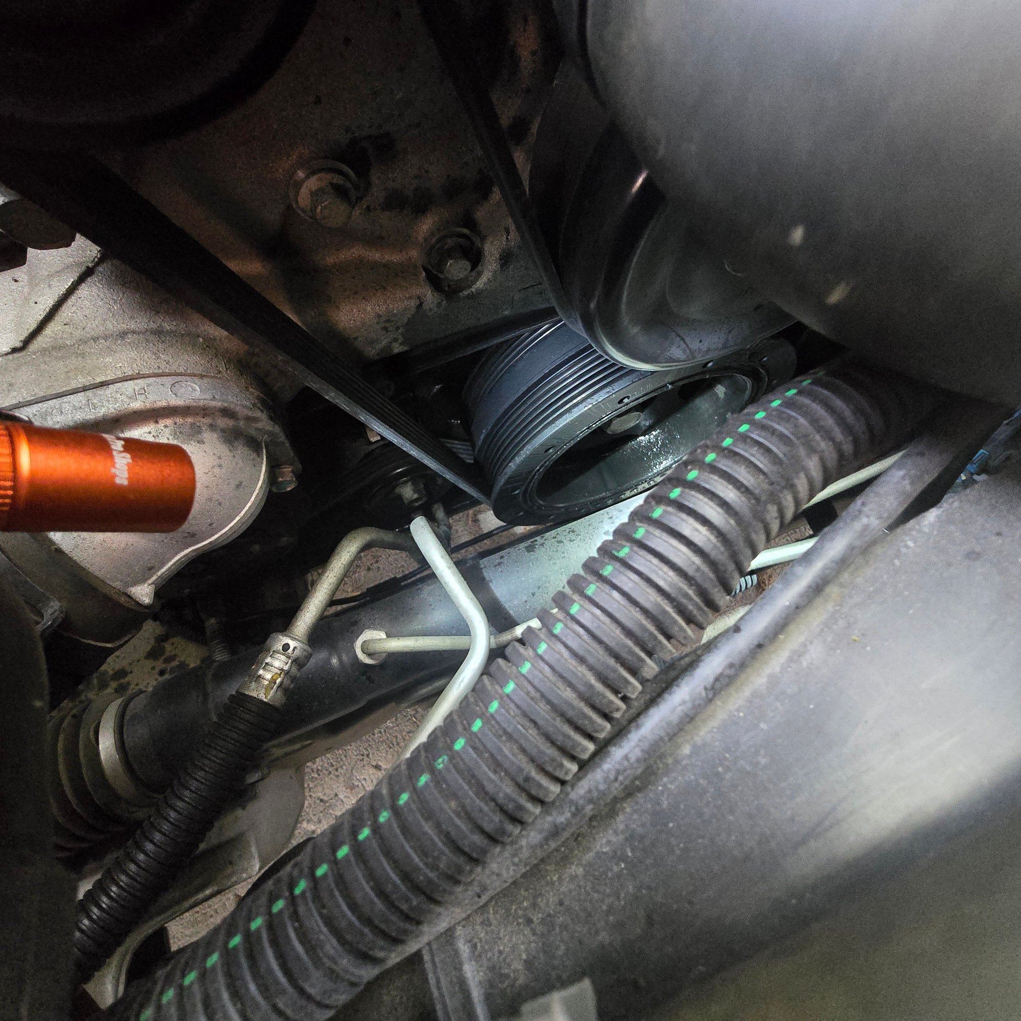

Hello everyone. Fist time poster here. I recently bought a 2006 convertible. Has 60000 miles. Just started leaking oil for the balancer area and has a slight wobble. I don't mind replacing it with aftermarket, just want it to be better than OEM. Any suggestions.?

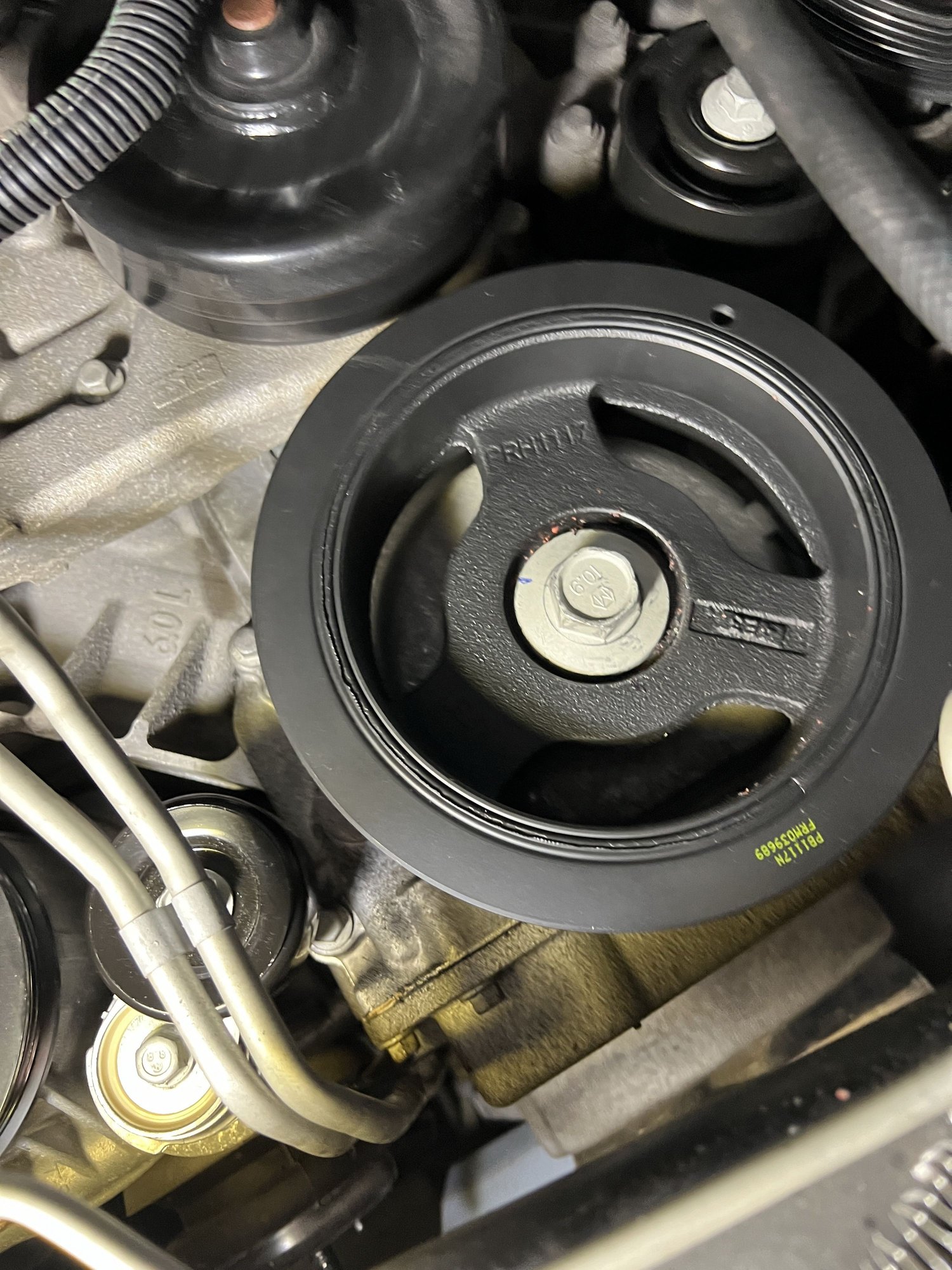

I replaced the one on my 06 convertible and used the Powerbond/Daco PB1117N. Search here and read all about numerous options. While you are at it replace the front main seal GM-296-02. I elected to replace the belts as well as the AC belt tensioner and the drive belt tensioner.

My harmonic balancer was replaced by a local auto repair shop last year. The shop was unable to obtain the OEM unit, so they installed one from Summit Racing instead. I actually prefer this performance unit over the OEM; it is rock solid.

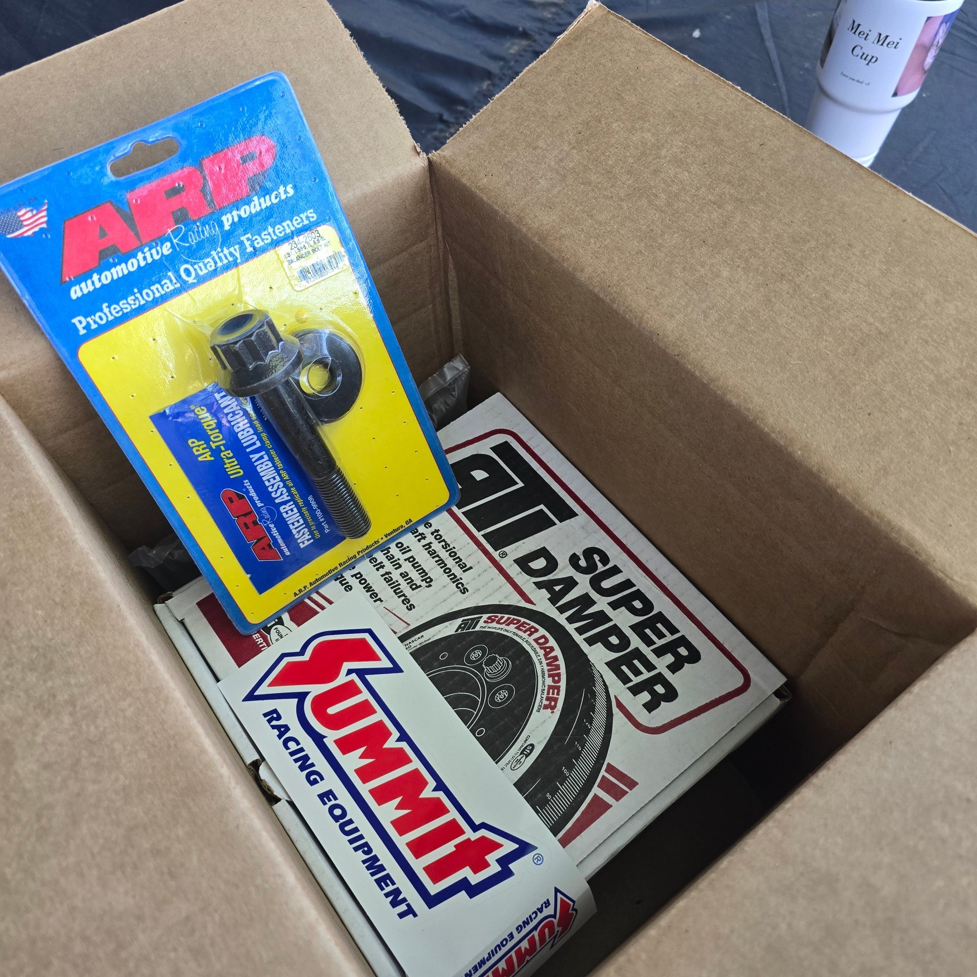

I've decided to replace the harmonic damper with the ATI917245 accompanied with an ARP crank bolt. Going in next Sunday. I'll give an update. Thanks to all.

ATI or Powerbond are popular aftermarket choices, don't install an OEM unit again
