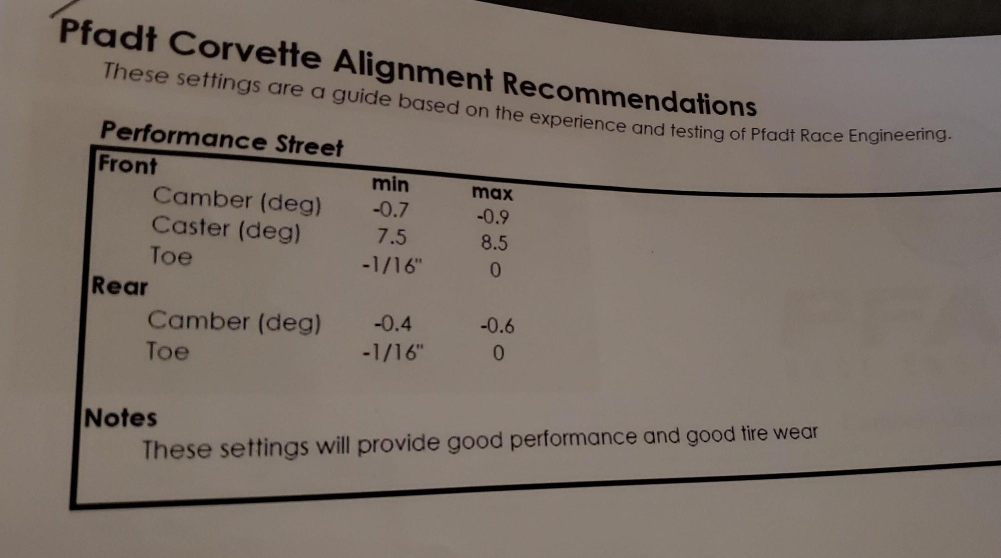

On a Grand Sport with the Mag Ride. Would the following be a good alignment specs to do on the car?
The car drives straight and good now but I don't want to prematurely wear out the new tires if the factory settings are too aggressive.

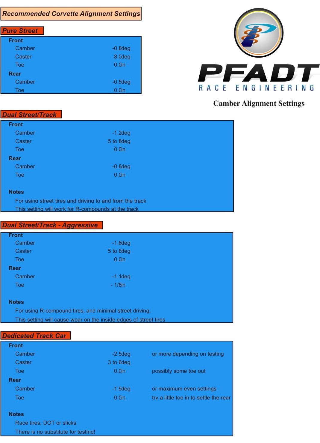

I’ve been using the PFADT pure street settings on my GS for about 6 years. Handling is just fine and at this point I think the rubber will age out before it wears out. There’s about 2Ok mileage on the rubber now.

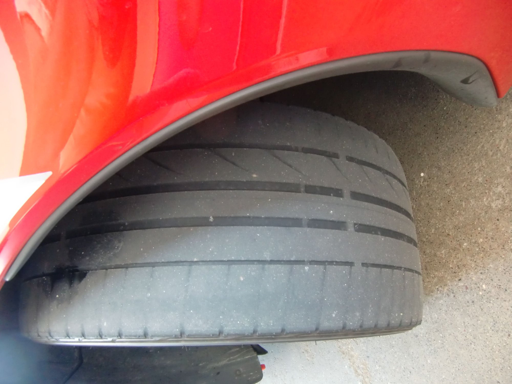

To give you an idea of why the factory alignment is not the best for tire wear, just before I started a close to 7K mile road trip, I had the alignment checked by a competent shop, and it was 'in the green' according to the factory specs. So off I went, with what appeared to be minimal tire wear. As the trip progressed, I noticed that the front rubber seemed to be noticeably wearing away. At just over 4500 miles into the trip, this what the front rubber looked like.
Maybe a little worse on the outside, but more or less even across the tread width.
This was at a Chev dealer in Missoula MT. I figured I'd never make another 2000 miles on what was left given how fast they were wearing, so the fronts were replaced there. Rears had minimal wear. I should have been paying more attention to the posts about PFADT, because the fronts wore out pretty quickly again, even though the alignment was still 'in the green'. An expensive lesson learned.

I will try and find a good tire/alignment shop to get the alignment into specs using the PFADT Pure Street settings. Don't want to ruin a good set of new tires.

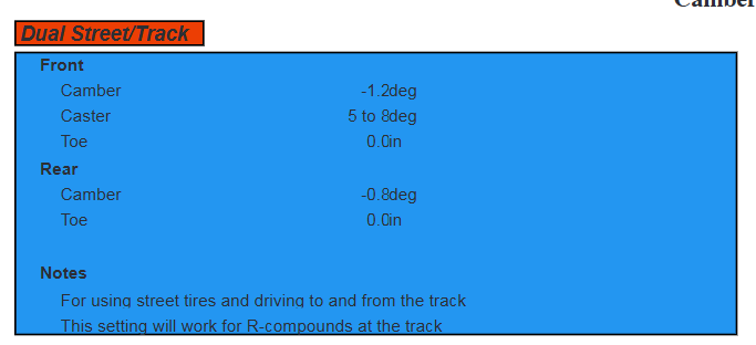

So are the FACTORY SPECS more in line with the DUAL STREET/TRACK-AGGRESSIVE settings?

There is no difference between the nominal PFADT Performance Street settings and the Pure Street settings. The Pure Street document is nonsense because it only gives nominal values and no tolerances. Everything has tolerances. I gave the Performance Street settings to my shop 6 years ago and my Michelins wore extremely evenly and still gave me a 1.29 max G reading on the G meter.

So are you saying to take the alignment range sheet I posted in the first post to the shop? That gives a range to shoot for.
Yes, and its when the car is diving like a caddy for driving miss Daisy, that your not putting enough force in the corners to wear the inside edges of the tires at same rate, that you get the outer edge wear/ need to have the alignment done to Pfad street specs.
Yes, that setting will give great street handling and good even wear. I've attached the PFADT sheet with all their recommended alignments all the way up to full race slicks.

I use the Dual Street/Track alignment settings on mine and tire wear is surprisingly very even daily driving the car.

The factory settings on the front of my car were almost at the DUAL STREET/TRACK setting. I believe that if you track the car, with a setting like the above, the tires should see "even" wear as the aggressive driving keeps the tire wearing evenly. If you don't track the car, a setting like the above, will wear it out unevenly if you just street drive it. That's what the alignment shop told me.
