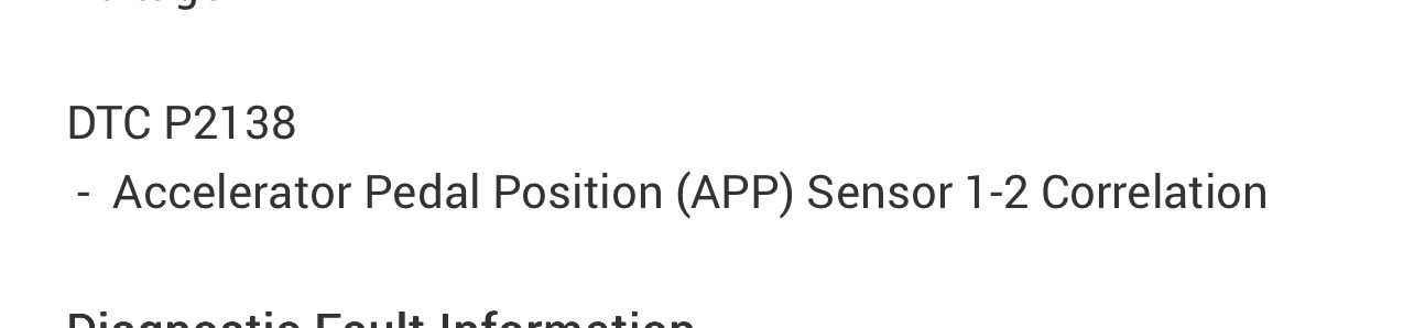

I have a 2011 Grandsport Manual and it threw the codes P2138 and P2138P. Any idea what can fix this issue and what causes it?

Could be a bad APP sensor or even a bad ECM…below is what sets that DTC and the Circuit/System Verification…if you lack electrical diagnostic skills I’d seek out an auto electrical specialist.

Best guess, is the swiper sensors in the accelerator pedal.
P2138 Accelerator Pedal Position (APP) Sensor 1-2 Correlation ECM
