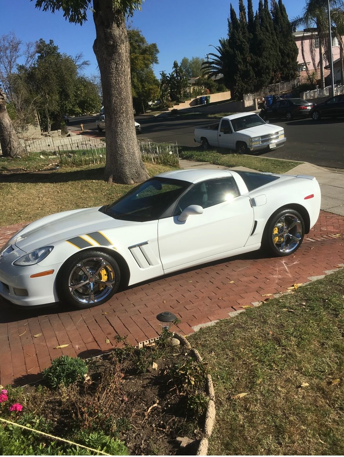

So I have had Xpel PPF on my 13 GS for about 6 years, wondering if it’s best to have it removed due to shelf life ? What say you fellow experts ?
Don't have an answer to your PPF question but like your white with yellow & silver combo. Looks nice!
Thanks you Chukman. Appreciate it.
Great looking ride you have to, enjoy.
