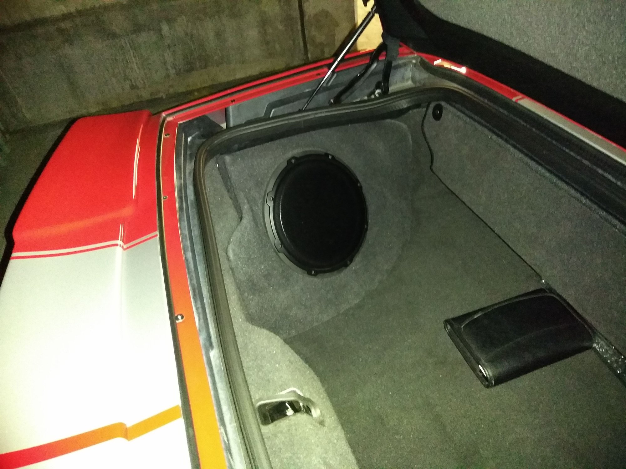

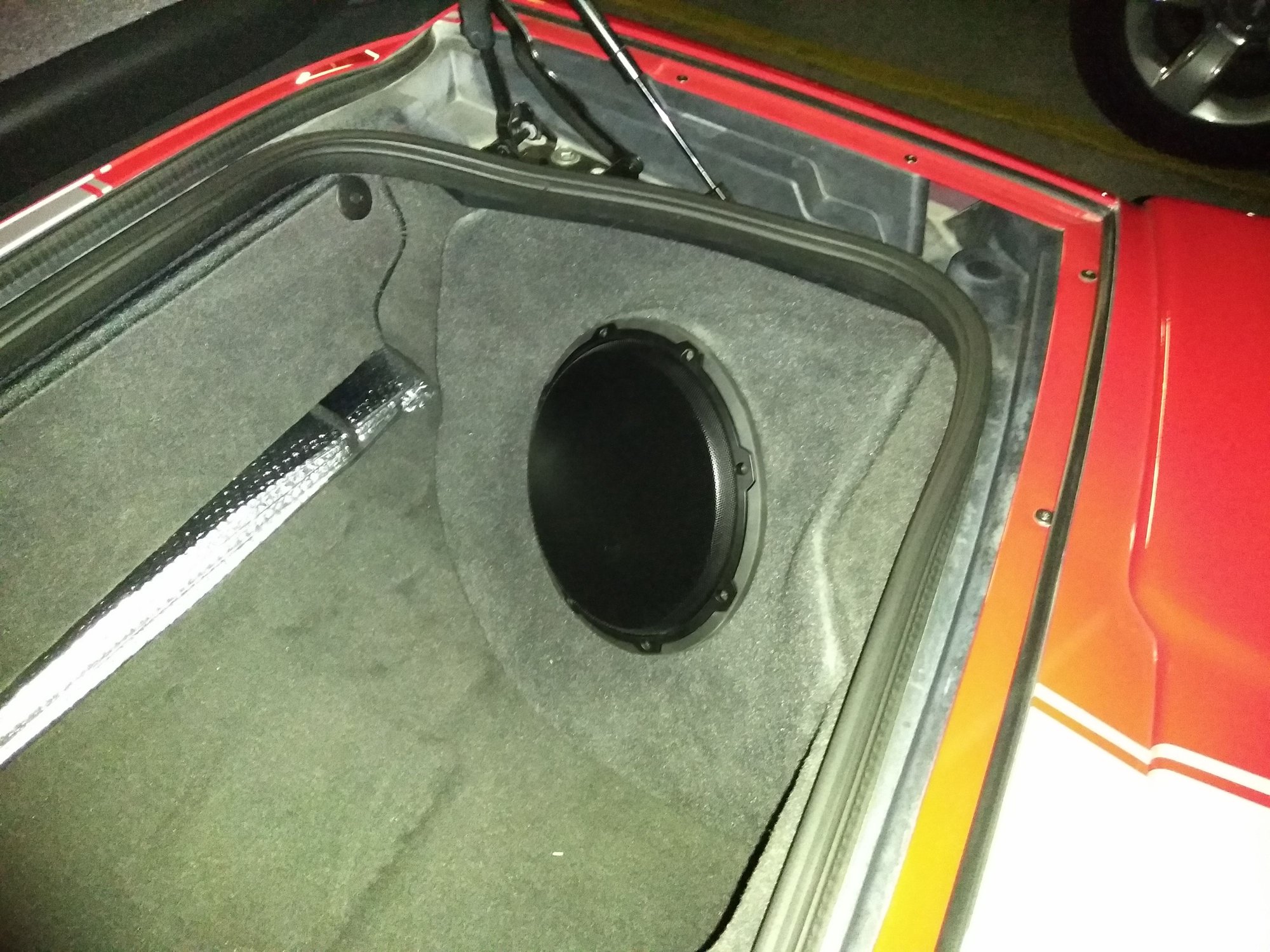

This is my solution. And before you ask, no, I don't know where you can get these enclosures. I've never seen any others like them, so I tend to believe they were probably a one-off build.

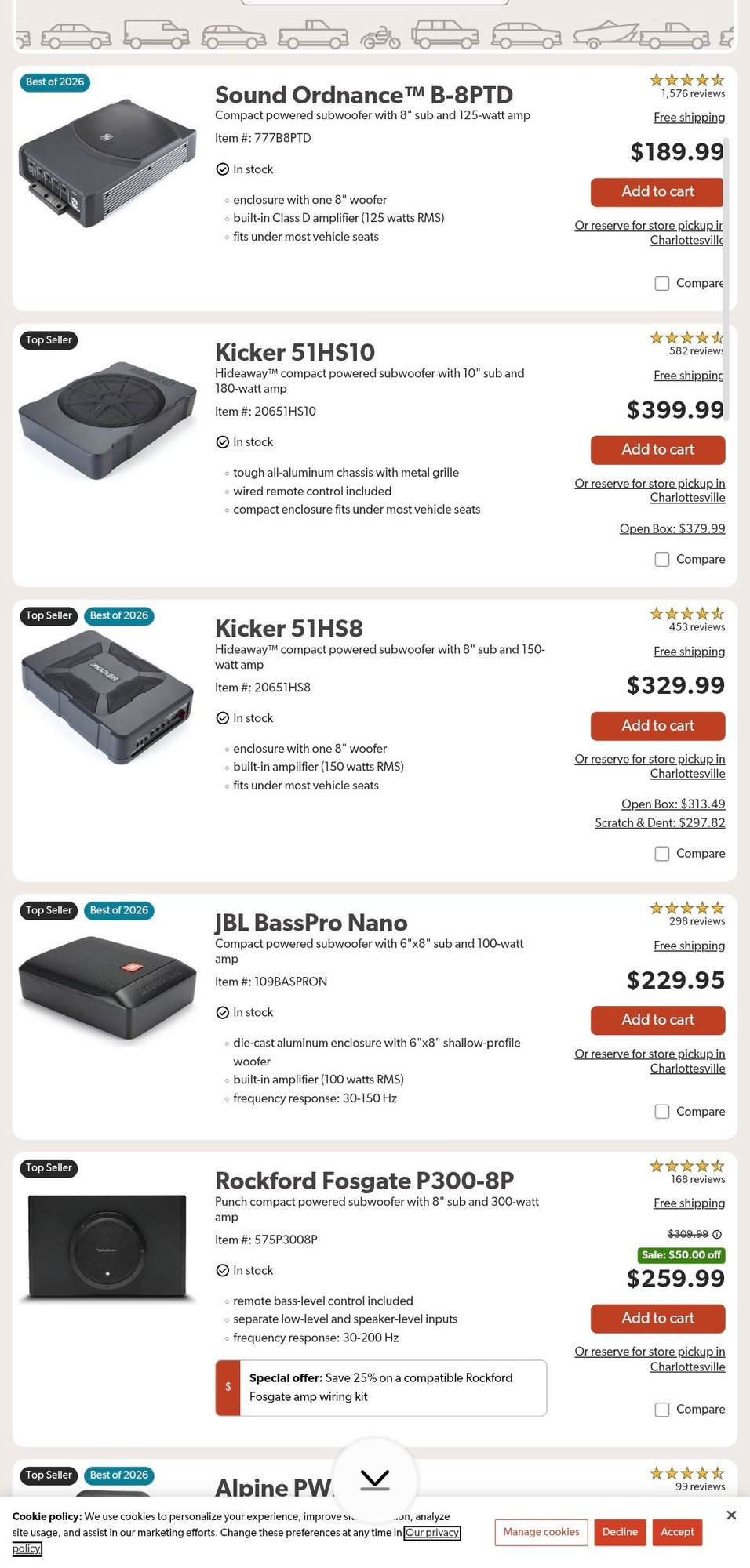

Cruthfield

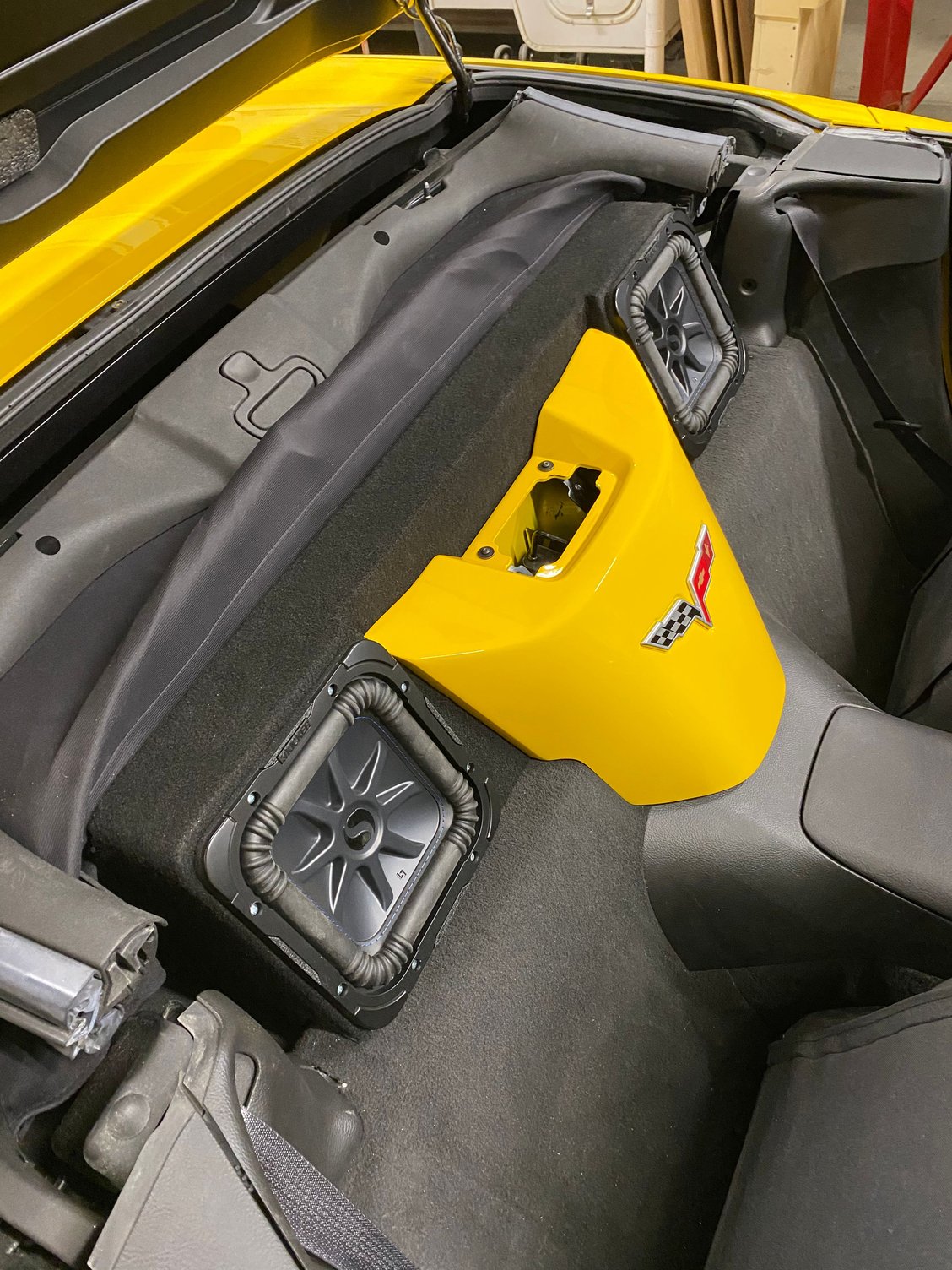

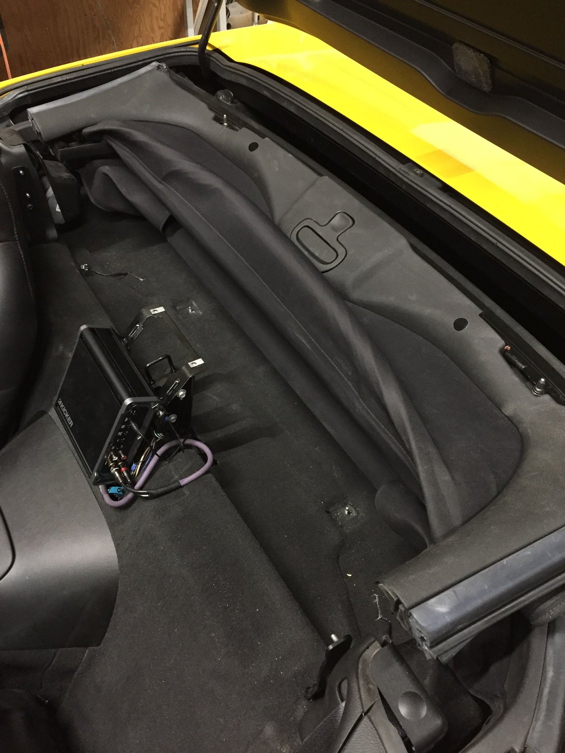

I did something similar to that with mine, it mounts in the space the original rear speakers were, after a few design changes this is my latest version. The amp https://www.kicker.com/CXA8001-800-W...-Subwoofer-Amp I mounted behind the water fall where the stock XM tuner was. I used the Kicker 8” Solo-barics. In my original design I used Kicker 8” round CompR’s, but I like the Solo-barics better as the sound of them has a little deeper bass compared the round CompR's. The sub sounds really good and the sound doesn’t muffled when the top is down which can happen with most trunk mounted subs. I was a challenge to build these which took me a couple of years of modifications to get my design to this point, but it was worth it. I’m still running the stock door speakers and amp, but adding the sub really livened up the sound by adding that much needed deep bass that the stock systems lack.
This gives you an idea of how much space there is to work with for the sub where the rear speakers were. I might add that I have a manual top also, so I don’t know how my latest design would work with a power top.
