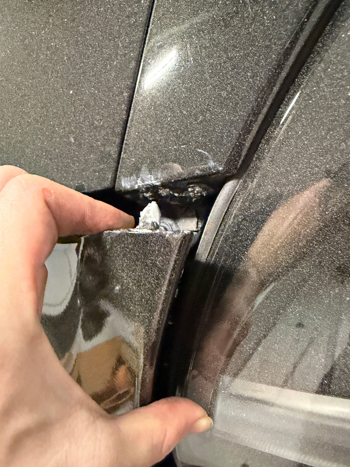

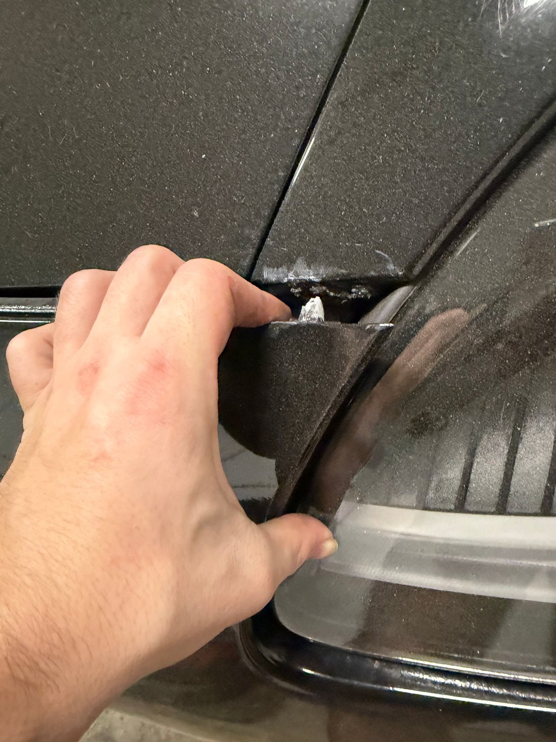

One of my front bumper clips has broken. I wandering what’s the best way to go about fixing this. The clip has gotten smaller and the hole has gotten too big to the point it just slides in and out.

I would ask the experts, find local Bodyshop!

Check that your radiator core support is not damaged from bottoming out. This could cause the front bumper to be misaligned.

The clip is cheap and easy to install. The problem is where it pushes into the fender is damaged. You're going to have to remove the bumper and or fender to examine the damage to see how you can repair it.
