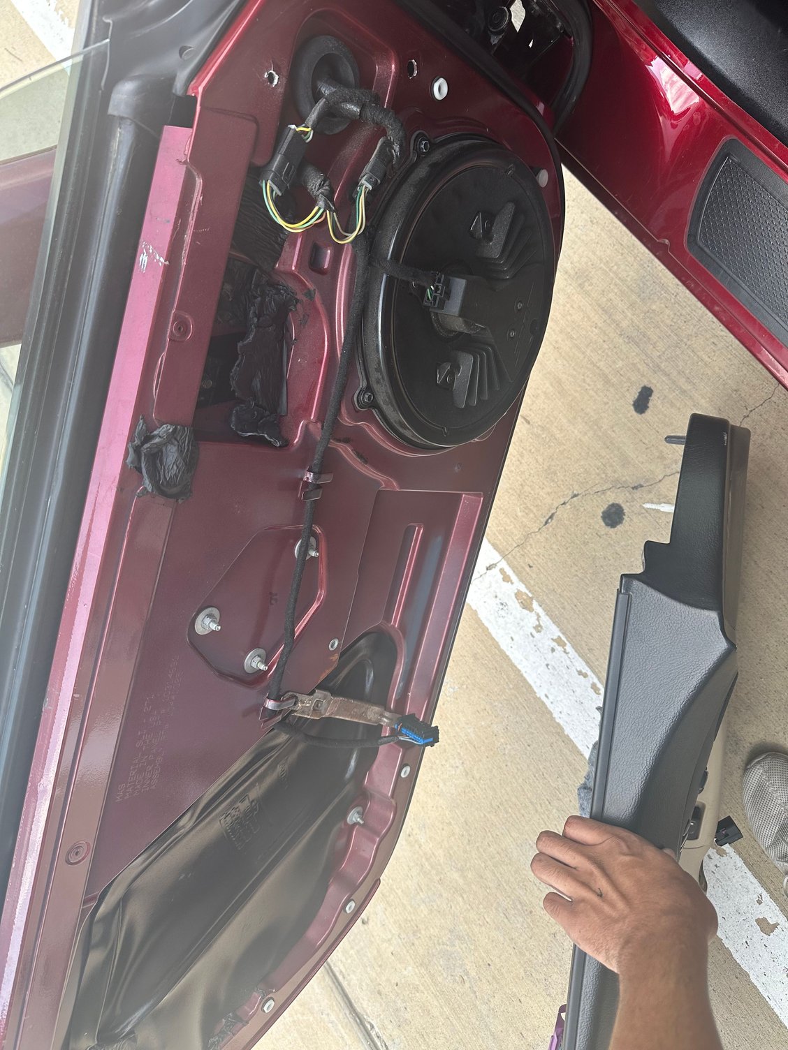

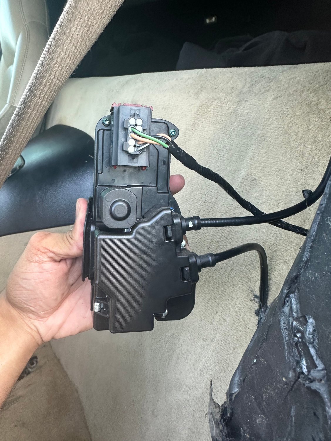

Hi guys, please point me in a direction if I overlooked a useful thread. I’m having the dreaded door wont open issue on my drivers side. Saw a bunch of threads in regards to replacing the actuator, swapping interior buttons and cleaning the exterior contact pad. The issue I’m having is interior only. Exterior is great, new actuator is installed, swapped button from the passenger side with no luck, opens fine with the emergency latch and indexes every time when interior button is pressed.
Im looking for info on finding the electrical gremlin for the interior button. Like I said, when the button is pressed the window indexes, the latch just doesn’t open. If anyone has pictures or can explain what to look for/fix that would be awesome. I’m decently mechanically inclined, but a complete buffoon when it comes to electrical and wiring. Saw a million videos about the exterior connection cleaning and I’m assuming there is something similar for the interior button but am unsure what to look for. I popped the door panel off and made sure all of the snap connections were in good shape and looked for any obvious damaged wiring. Reading a wiring diagram feels like staring at mandarin so I’d really really appreciate if someone has had the same issue with the interior button and could share a video or picture. I’m guessing if I backtracked the cable from the actuator that doesn’t link to the emergency latch it goes somewhere that I probably have corrosion issues, but was unable to track things that far this morning. Pics for reference of what I’m working with and where I’ve been so far. Thanks a million for any advice that a caveman like myself can follow!

Might be as simple as [a] wire comig loose, or, frayed.
In either event panel needs to be removed for inspection.
Betting sourse of issue reveals itself.

If the window indexes down when you press the button, then the only explanation I can think of is the actuator is defective. You said you replaced it.
I just went through this with the passenger door, but the door would not open at times from inside or outside. The window would just index.
I replaced the actuator and all was good. Much quicker too.
When you press the button on the inside, do you hear the actuator? You should.
Best guess with something this trivial is to disconnect the battery for 10 minutes and let the modules reset and see if things get fixed.

I was hoping actuator as well. I’ve got the battery unplugged as we speak so fingers crossed. But no, I’m not hearing anything from the actuator like it’s even trying so I’m afraid I’m losing signal somewhere between the button and the actuator

Ya it’s perfect from the outside every time. Was hoping there would be a similar contact situation for the interior too but couldn’t find anything off the bat. I’m tempted to drop in a new wiring harness for the door atp. Looks like a replacement is about $60 so might be easier than trying to chase down the issue?
