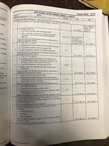

Old May 7, 2026 | 08:35 AM
C6ToGo's Avatar
C6ToGo
Joined: Dec 2006
Posts: 4,590
Likes: 1,669
From: Pearland / Houston Tx
