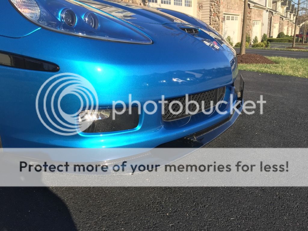

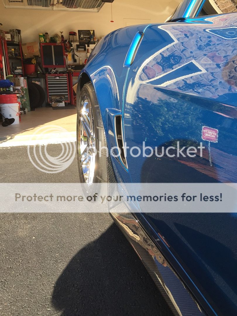

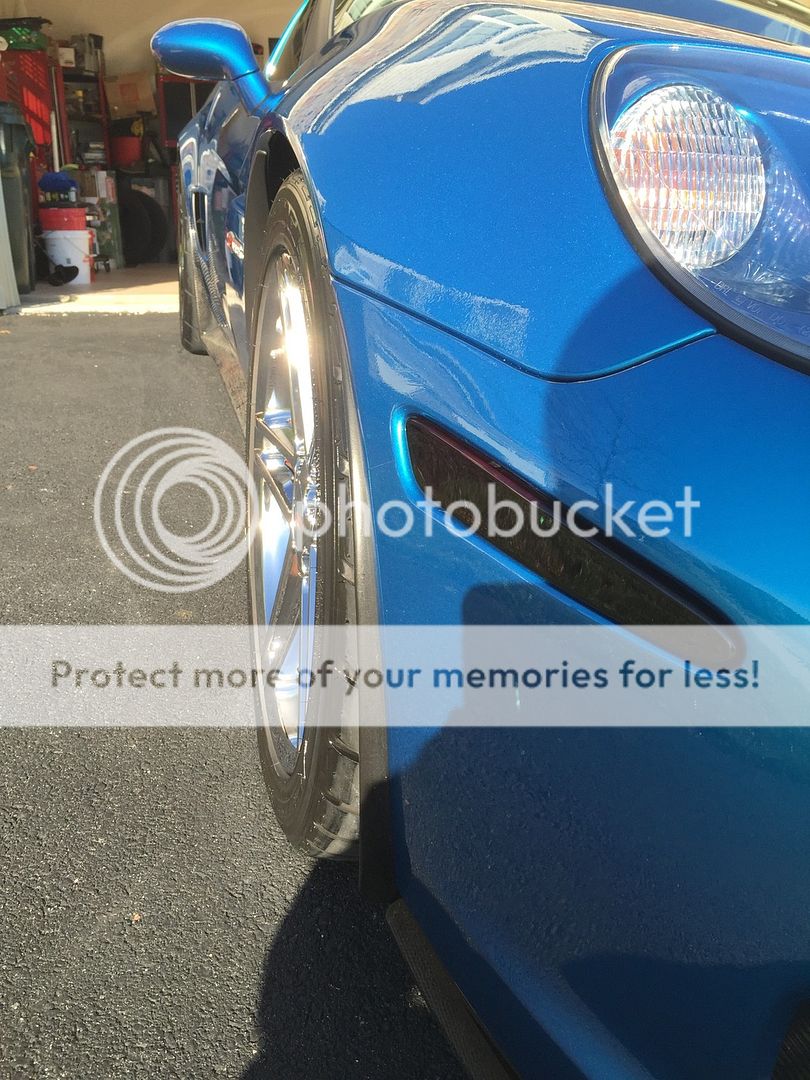

Got some pictures of the new wheel/tire look now that I have the 5mm spacers on all 4 corners. Was able to get enough bite from some extended thread chrome replacement lug nuts. It's amazing what a difference 5mm makes, especially on the back and with the C7 extended side skirts!
Also picked up a matching C7 front splitter...

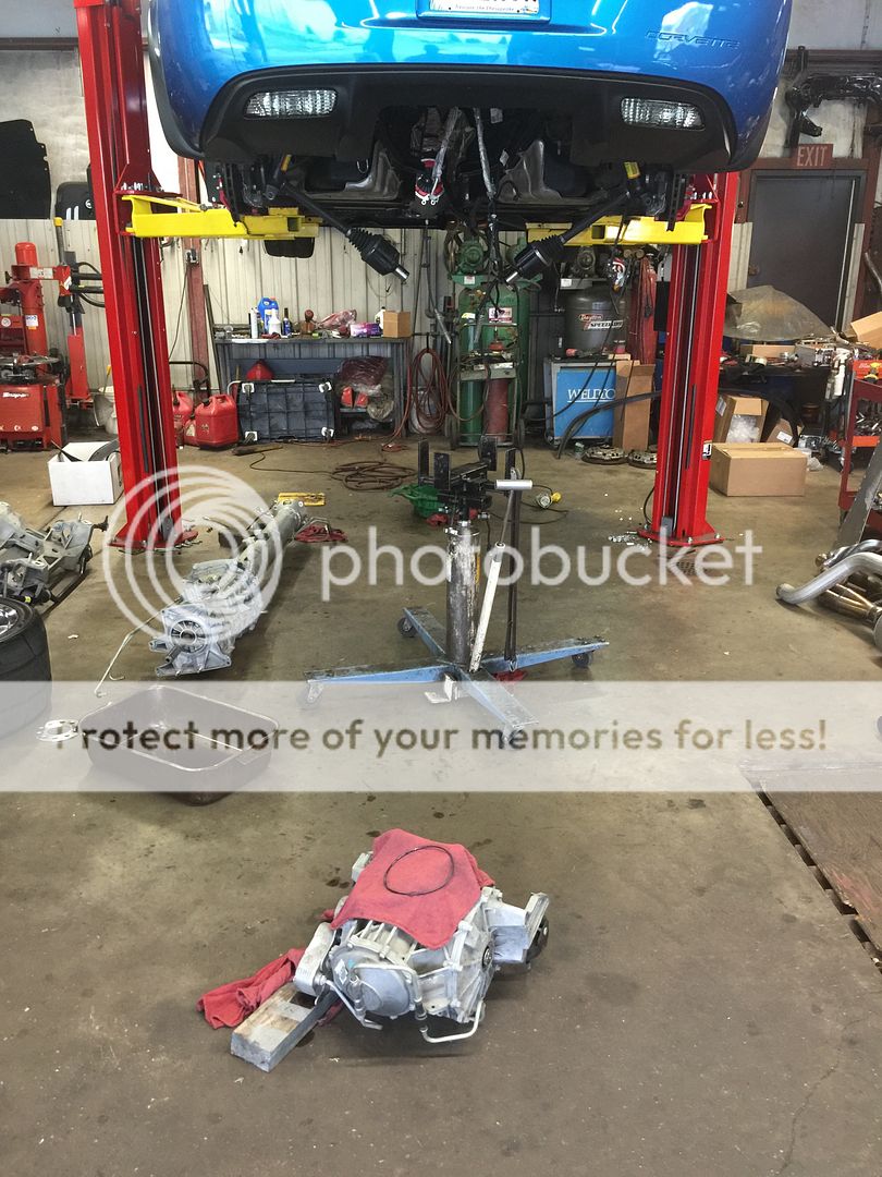

Well I got my replacement clutch, so we ripped her back apart this weekend. The swap went well and there's no longer any noise with the pedal depressed like I was having. It is suspected that it's is a defective GM slave as the clutch did not seem to have any obvious issues. Either way, it's all better and I LOVE this Mantic9000!
