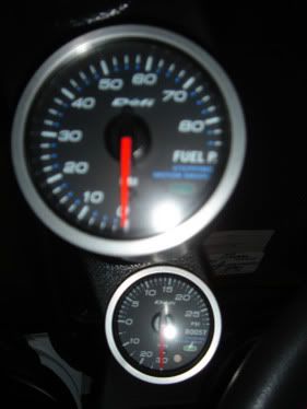

wow those look pretty cool, and not as expensive as tne autometer nexus... any idea where I can get a deal on them? Do you have them on the steering wheel like in the picture or on the a pillar? any pics of them mounted?
and most importantly can you link me to the controller that you use and can that alert somehow cut the boost with a boost controller? or w/e sorry im a no0b at this :o

(Defi gauges) no AFR in these pics... (old pic)
got mine from www.edoperformance.com

those are pretty nice thanks for the pic post!
