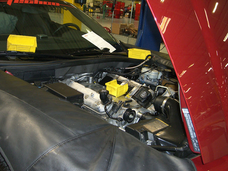

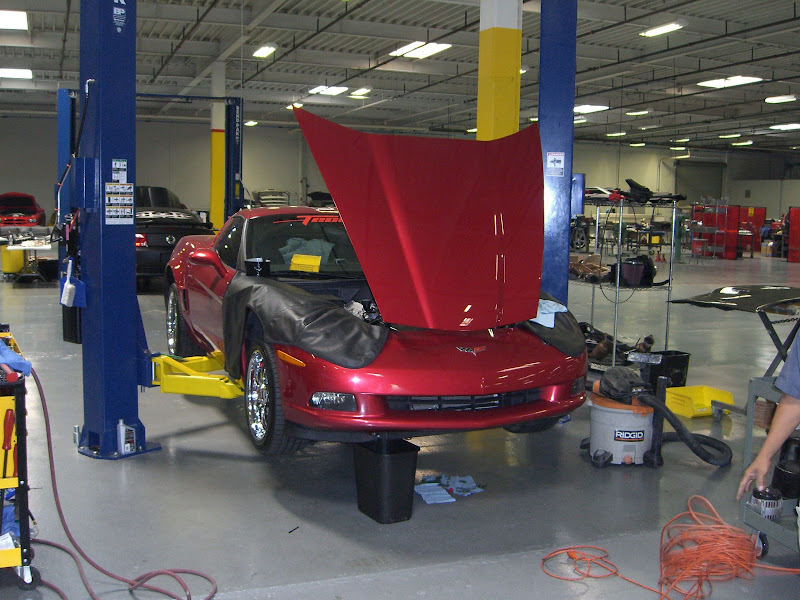

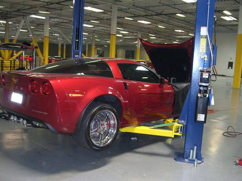

We have gone round and round trying to find the best way to complete our supercharger package for the LS2 without sacrificing hood clearance and any restriction. Here is the direction we are going.......
LS2 to LS3 head swap.
With the design of the LS2 heads compared to the design of the LS3 heads we feel that this is the best direction to go. We currently have 3 cars in house in process with this set up.
Pictures of the process is below. We will have details and hp gains, final pricing soon.
Even if we designed the blower to work with the LS2 heads with our twin screw runner design it would of taken entirely too long as well as sacrifice power gains, etc....
