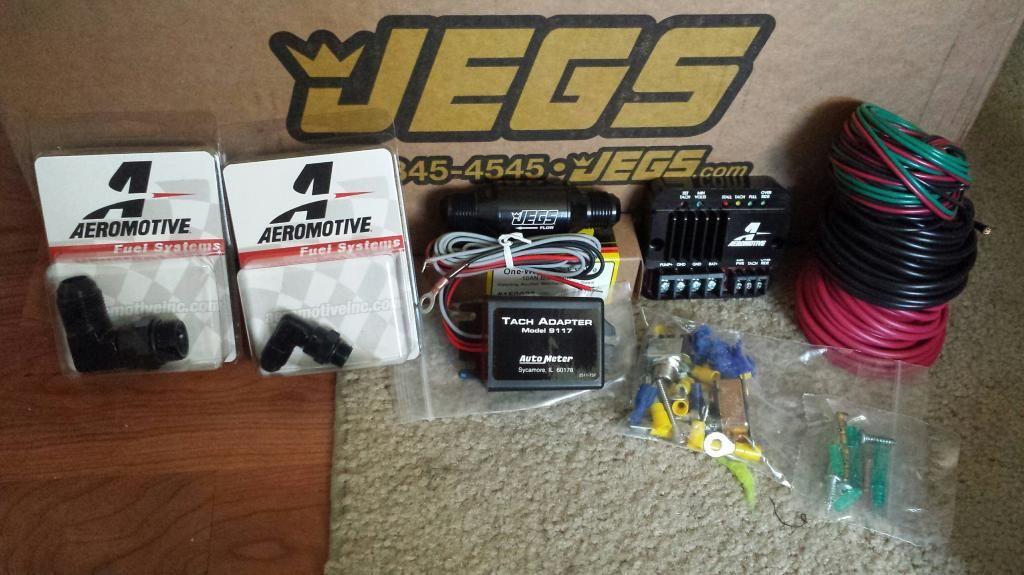

Only had the car 7-8 weeks and already bored with its "slowness" lol. Seriously I bought the Vette to build and replace my 900awhp TBSS.
Initial goals for this build is 800rwhp and run 10.0/9.x.
Its heart will be my built, stroked, forged 419 LS3 with WCCH LS3 heads with additional extensive valve work.
Injectors (not pictured) are FIC 95lb@3bar.
I'm still waiting on some parts to be delivered like the Circle D convertor and UPP TT kit, but the rest should be a good start! I'm also trying to get the car scheduled at IPS...OR CTD?? to do the first round of mods.
So I have a few months to get this thing build before spring and have a little fun next year.
Thanks,
Jeremiah

Subscribed! Which UPP kit did you get?

Good luck with that fuel pump setup, I would recommend something different.

I think I've read one good thing about that setup ever.. so yeah, I agree.

We will see how the pump setup works, the system itself should be great! I ran twin 450s in my TBSS and hated having 2 pumps. I wanted to do a single with this build. Time will tell.
I went with the fender mount kit with the GT35r's since UPP has done some nice improvements. I had CK do a couple minor tweaks to it too.
-wideband bung
-IAT bung with IAT/adapter setup
-ceramic coat the up pipes inside/outside
-ceramic coat the turbo hotside inside/outside
-ceramic coat the down pipes outside only

Good luck with the build. All the stuff I've read about that pump setup seem to have been install / wiring issues. I'll be running the same fuel system.

I was just getting ready to say that lol. I spent 3 months researching, this pump was the best option for my goals-both HP and personal.
I use the term "most" loosely, however Aeromotive strongly suggests using a speed controller and specific gauge wiring with this pump. Most run the incorrect gauge wire and/or NO speed controller.
My biggest concern was the lack of a bucket with this pump. So when the tank gets low, will I have pickup issues? Again, time will tell.

The only problem I had with the in tank A1000 was every once in a while after a long pull the fuel pump would cut off. Think I narrowed the problem to the pump speed controller. I have pulled that one off and replaced it with a controller that Dsteck builds which will run off of the map signal instead of rpm.
