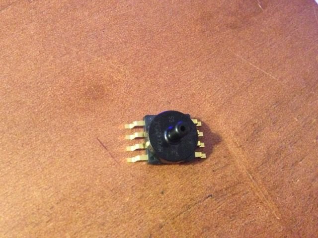

OR you can use one of these....
MPXA4250AC6U
2.5BAR PRESSURE SENSOR

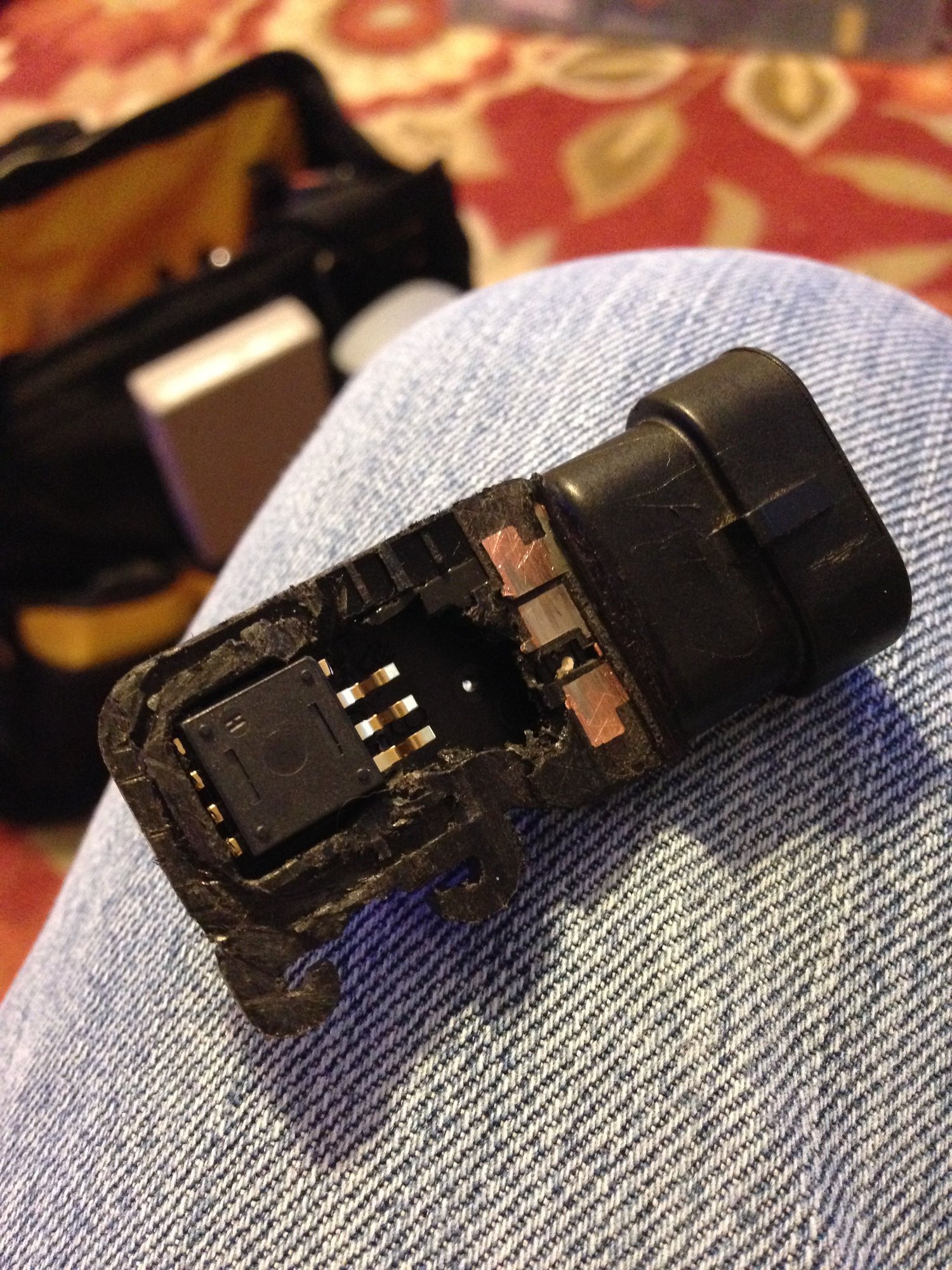

You have to install this into a MAP sensor housing.. so you have to rip an old MAP sensor apart to install this, but still, you can find those on ebay for $15 for ones that will work. I have one coming on Monday to try to play with
Here's where I found the idea:
check out posts at the end.. package gets "simpler" as the thread goes on
https://www.corvetteforum.com/forums...post1579874635

BUT, I figure the sensor is like $16 and an old MAP sensor I found on ebay for $10.. so for $26 it'd give me a small project and maybe save me $100. or cost me $26 if I screw something up.
Either way, not a huge deal. I like doing stuff like that though. If I didn't have time I'd just order one too

Did a little cheapo eBay MAP sensor hacking up last night. Would be a lot easier the second time.. I think I'd just stick it on a belt sander to wear away the top half of the case if I were doing it over again. Wasn't sure how it was constructed until I got it pretty well opened up
Does anyone know if there's any kind of port on the back of these sensors that needs to remain open?
I'm hoping not and can't find anything in the data sheets stating otherwise but still wasn't sure
