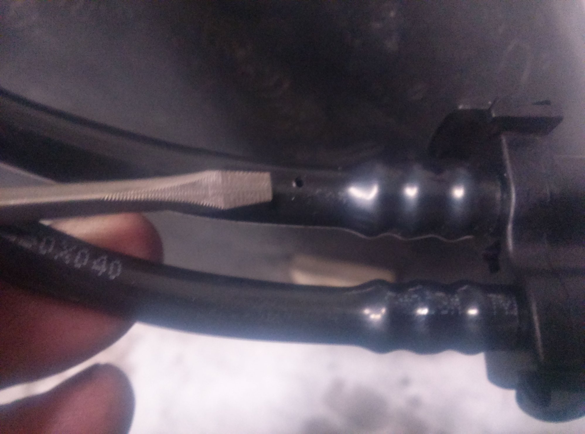

Good news. I pulled the pump back out and blew through the fuel line from the top of the assembly and sure enough, fuel shot out from in between the 2 halves of the filter. I pulled it apart, lubed all the orings, and after about an hour of putting it on and taking it off, it snapped right in place and sealed tight.
There is bad news though. I decided out of curiosity to start blowing through the fuel lines just to see if they were leaking. I found a pin hole in one of the lines that is inside the tank, about an inch from the connectors to the crossover. It is a perfect tiny tiny hole, almost like its supposed to be there. Is that hole there for a reason, or does it need to be replaced/repaired? I didnt have any tools there so I cant imagine where it came from.

Right next to the tip of the screwdriver. I cant imagine what would poke a perfectly round hole through that hard line. Thats the line that sits in the bucket.
Old Jan 9, 2015 | 10:35 AM
turbotuner20v's Avatar
turbotuner20v
Joined: Dec 2009
Posts: 4,754
Likes: 303
I'm 99% sure that i have that same hole
