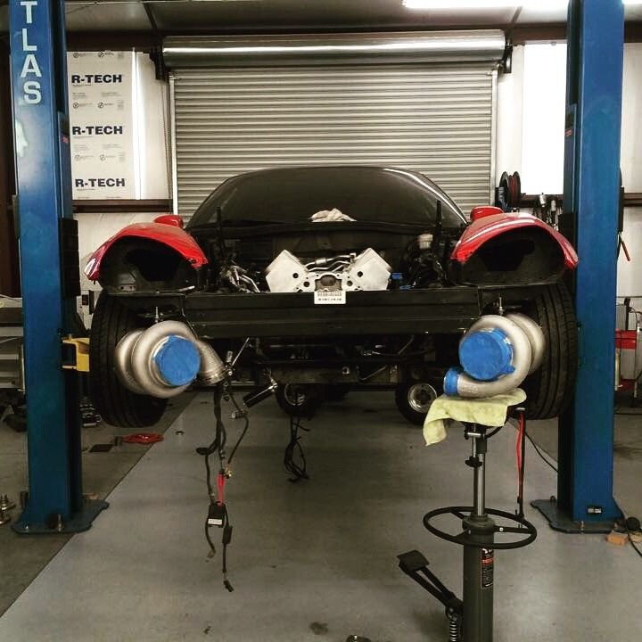

Little teaser of the twin build I have going on down at caliber customs. Should have it wrapped up by end of summer.

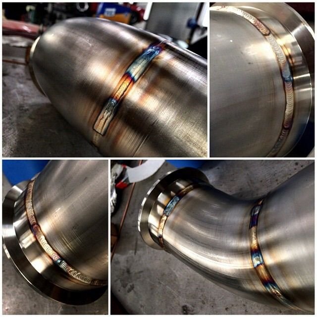

Welds look pretty!

S*hit looks good, what size turbos are?

Promod 88/91s

How are you getting the hot side past the cradle to the turbos. I want to do twins in the same location but can't figure out how to get the hot side past the cradle

theyre forward facing coming up parralel to the head and down to the vband of the hotside on the housing. exhaust is dumping in the front bumper in front of the wheels

Can't wait to see this one complete. Excelente choice on heads. What intake are you going to run?

mast is working on casting a lower runner section for the edelbrock port since there is no off the shelf right now, will be all cnc'd out once cast and lme is making a billet top for it. the manifold is holding everything up right how was suppose to have been done 8 weeks ago

Bummer on the MAST delay, hope they don't drag their feet to long on it.
Have you though of an alternate route if the MAST doesn't work out for some reason?
Wilson has cut a couple single plain intakes and welded on the correct flanges.. Could always go billet or sm..
no one has a program for billet on the lsx-r port or i would have (that im aware of or lme). hogan could have made a sheet metal by now but they have a 6-8 week lead time. already to deep waiting for this thing might aswell stick it out and ride the wave lol
