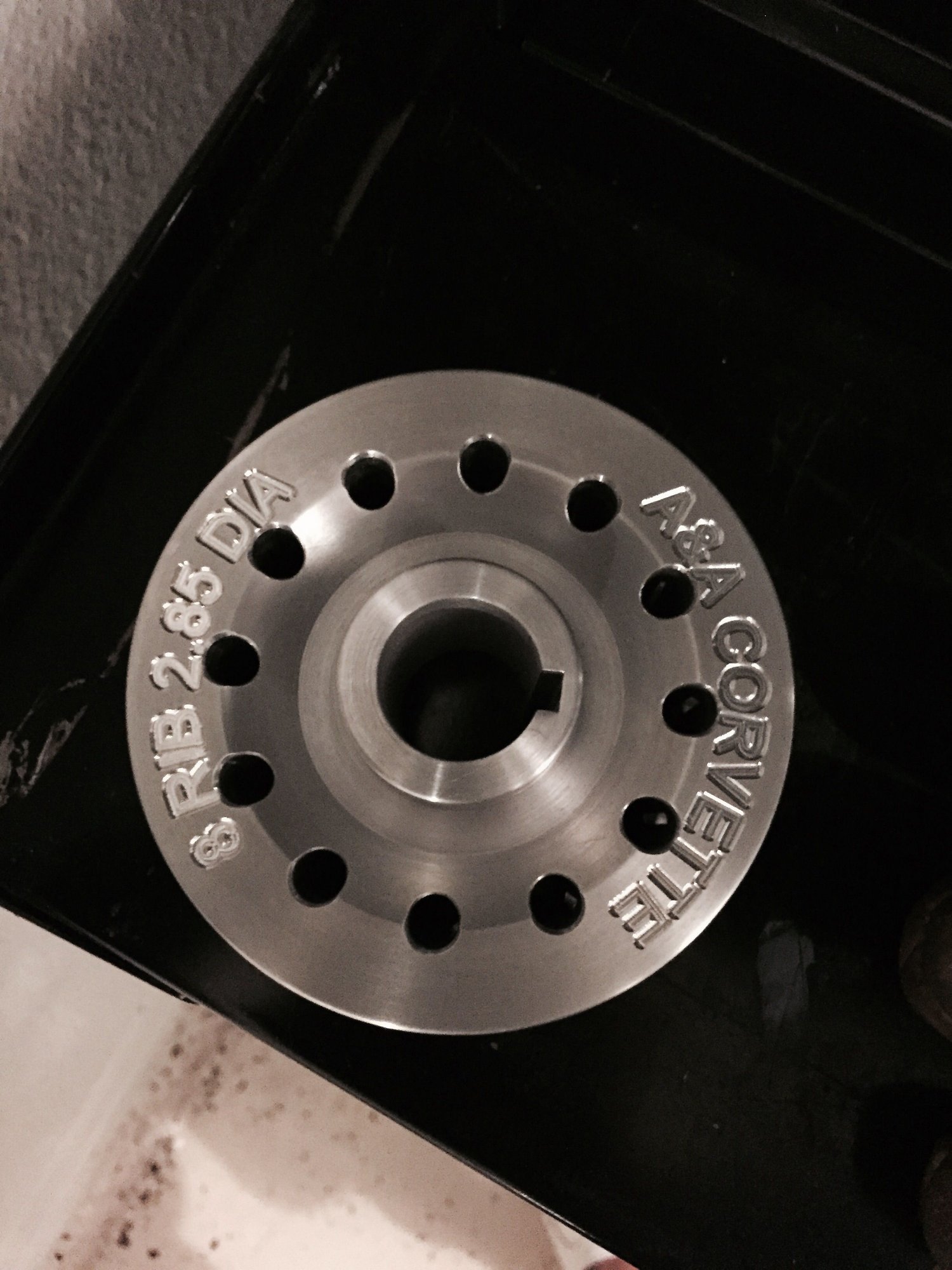

Alignment is off so check your blower to idler to tensioner to crank alignment.. That side muse be off to send belt 1 rib left either shim blower pulley left or get A&A pulley so you dont need to worry about that because it has guards.. There are time at WOT if the belt isnt max tensioned or if it has stretched it can jump off a bit too but not like you can watch for that.. Not too many realize that belt stretches so much its crazy.. My advice is get A&A blower pulley and never worry again.. They make em 6 rib or 8 if you have 8 rib but im sure you have 6 rib..
Not tellin u to get this diameter just an example..

Do not go with a pulley with edges on it, that's only a band aid and if the alignment is off it will roll the belt over and destroy it rather then just jumping a rib. Most likely the tensioner bracket needs to be adjusted, you can look down over the head unit pulley and see the misalignment of the belts if that is the case.
