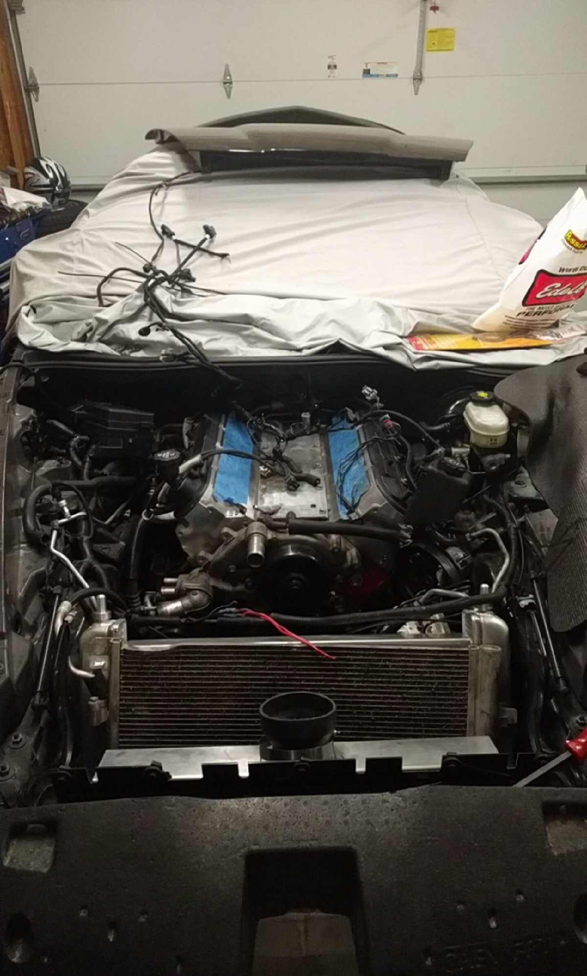

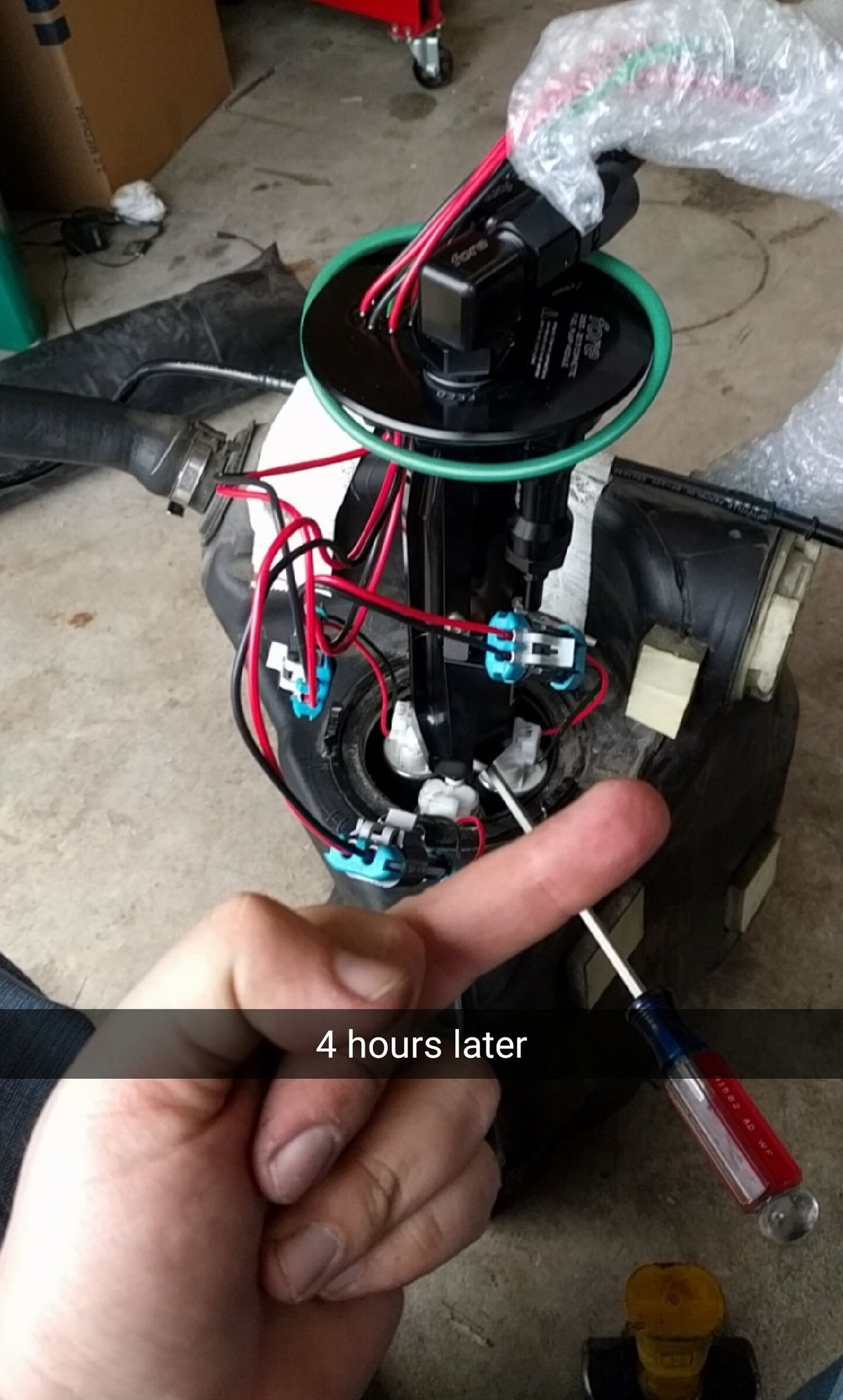

Some progress over the week. I ended up getting the motor in last week. Definitely didn't go in as easy as the old one came out, but overall it wasn't that bad.
Aside from that, I started on working on getting the Fore system installed. Spent about 3 hours on it yesterday and got all three pumps in the bracket in the tank. I kept having trouble getting the fittings on fuel pumps to align with the threads on the Fore system. Pump #2 took about 30 minutes of fine tuning. Pump #3 is still a work in process. The pump is in the bracket as mentioned, but also having a hard time getting the fitting started. After awhile, I gave up and will probably mess around with it after work.

Got to get the fuel level float/sender in there too before going much further, otherwise it will never attach.
Good luck. I spent ~8 hours getting the last pump hooked up correctly. The 2nd one would go in just fine, but the 3rd didn't want to move.

Yes, the float is already in. That was the very first thing that I did. I had to stop last night because I couldn't feel my fingers anymore. They haven't worked that hard since I was in high school.

Good to hear that it wasn't just me being dumb. Will be looking forward to your full battle report once it is done.
My fuel level only goes up to 7/8th a tank after the fore triple, and I'm just living with it as there is no way in hell I'm pulling it apart to attempt to fix that.
We need to get t-shirts or something for "I survived a fore triple 465 install"

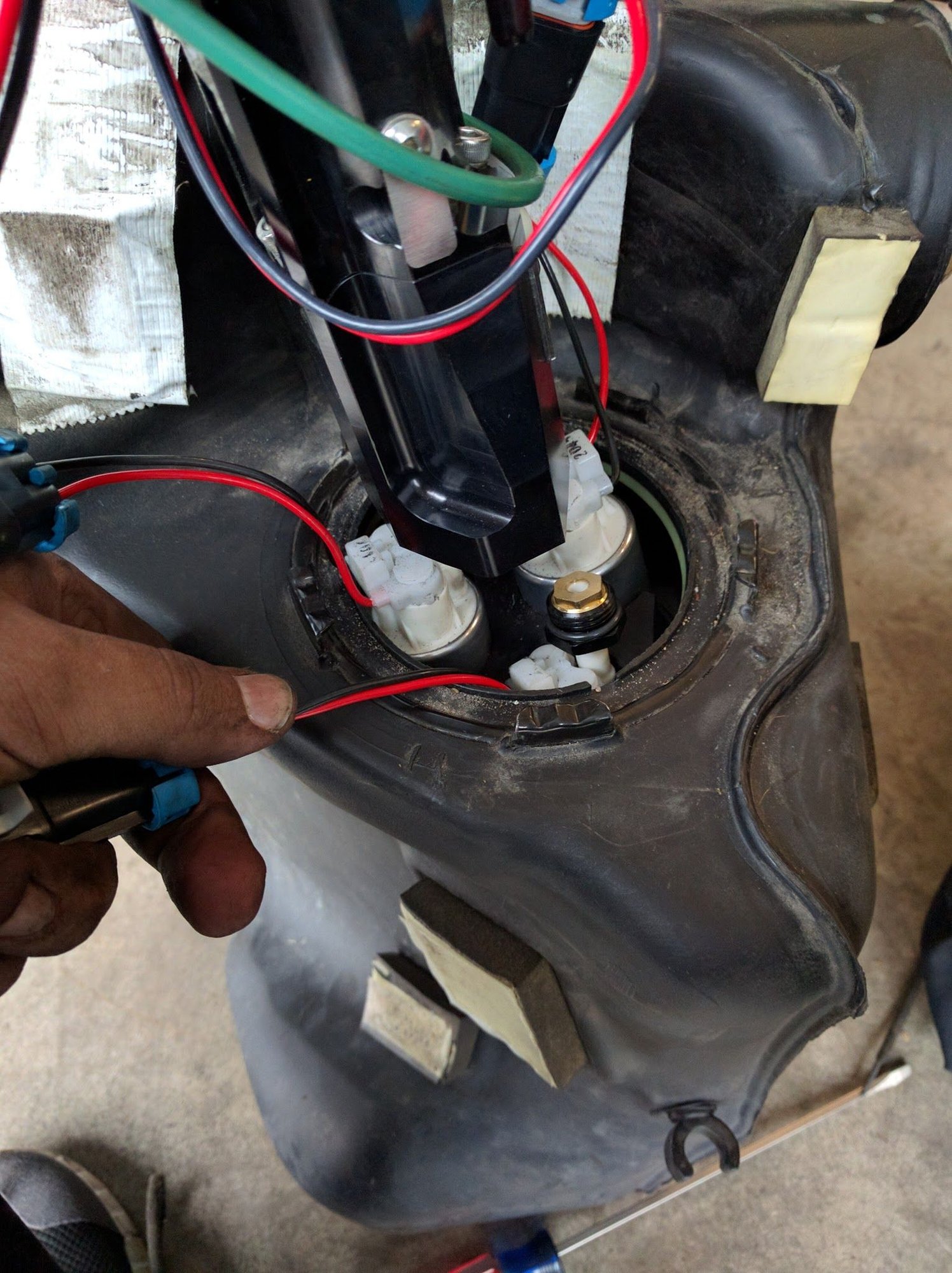

Welp, only about 45 minutes of messing around with the 3rd pump and I was able to get it in. Luck would have it though, that in the process of trying to get a good position on the pump, the small plastic piece that holds the float broke. So now I'm stuck waiting for a new sender to come before going any further. Hopefully it goes in just as easy as the broken one came out.

Looks like the transfer siphon/etc still need to be hooked up. Hopefully that is easy to reach and plug in.
Best of luck with the new sender part. It will suck if it has to come apart to fix that.

And when you get it connected make double/triple sure that the transfer hose isn't in the way of the float. Like stick a bore scope down there to make sure once the hat is in.

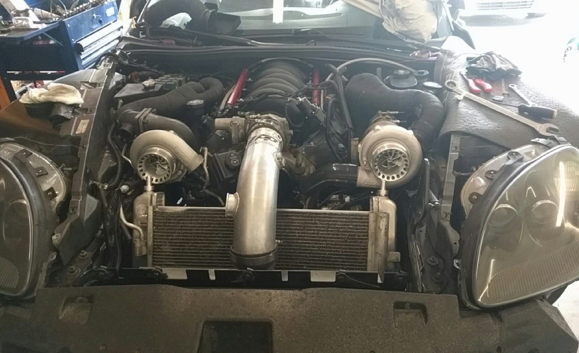

So, its been a little while since I have updated this. Car is still in the stages of going back together as time has been pretty limited this past month with finishing up my class work for my bachelors degree.
For the car, the entire fuel system is back in along with the rear end. First time the rear cradle has been in the car in over a year and a half. While I was in there, I changed out the wheel bearings as both boots where damaged (probably from doing the 15" spindle conversion a few months ago).
For the engine, had a lot of trouble with the drivers side header/turbo. First, the downpipe was too large to fit with my old line lock solenoid and hard lines. Since the car is probably not going to see much 1/4 racing, I yanked it out and replaced it with the OEM lines after waiting 2 1/2 weeks for them to show up. On top of that, the compressor side of the turbo wouldn't go all the way down due to the hardlines going into the ABS block. Even with moving it down about 1/2", I had to do some slight modification to fit the 6266's in. I think it'll be pretty difficult to fit anything much bigger, like a 6766, without moving the ABS block.
From here, pretty much all I have left to do is modify the power steering bracket, relocate the alternator, finish running the oil feed lines for the turbo, mount the cold side piping, drill the holes for the dump tubes and finish wiring the fuel pumps in. Should be able to fire it up this weekend.

Yeah looks like a cluster lol! GL! heat is going to be a challenge on that kit for sure.

Hoping to combat it as much as possible. The headers and downpipes are ceramic coated, wrapped with DEI heat wrap, and then additional coating over the heat wrap. I'll also be running turbo blankets to help keep everything in. Maybe a little overkill, but want to keep things as cool as possible.

Hoping to combat it as much as possible. The headers and downpipes are ceramic coated, wrapped with DEI heat wrap, and then additional coating the heat wrap. I'll also be running turbo blankets to help keep everything in. Maybe a little overkill, but want to keep things as cool as possible.
Not over kill, it will help a lot but its still going to be extremely hot.

No such thing as overkill when it comes to that.
