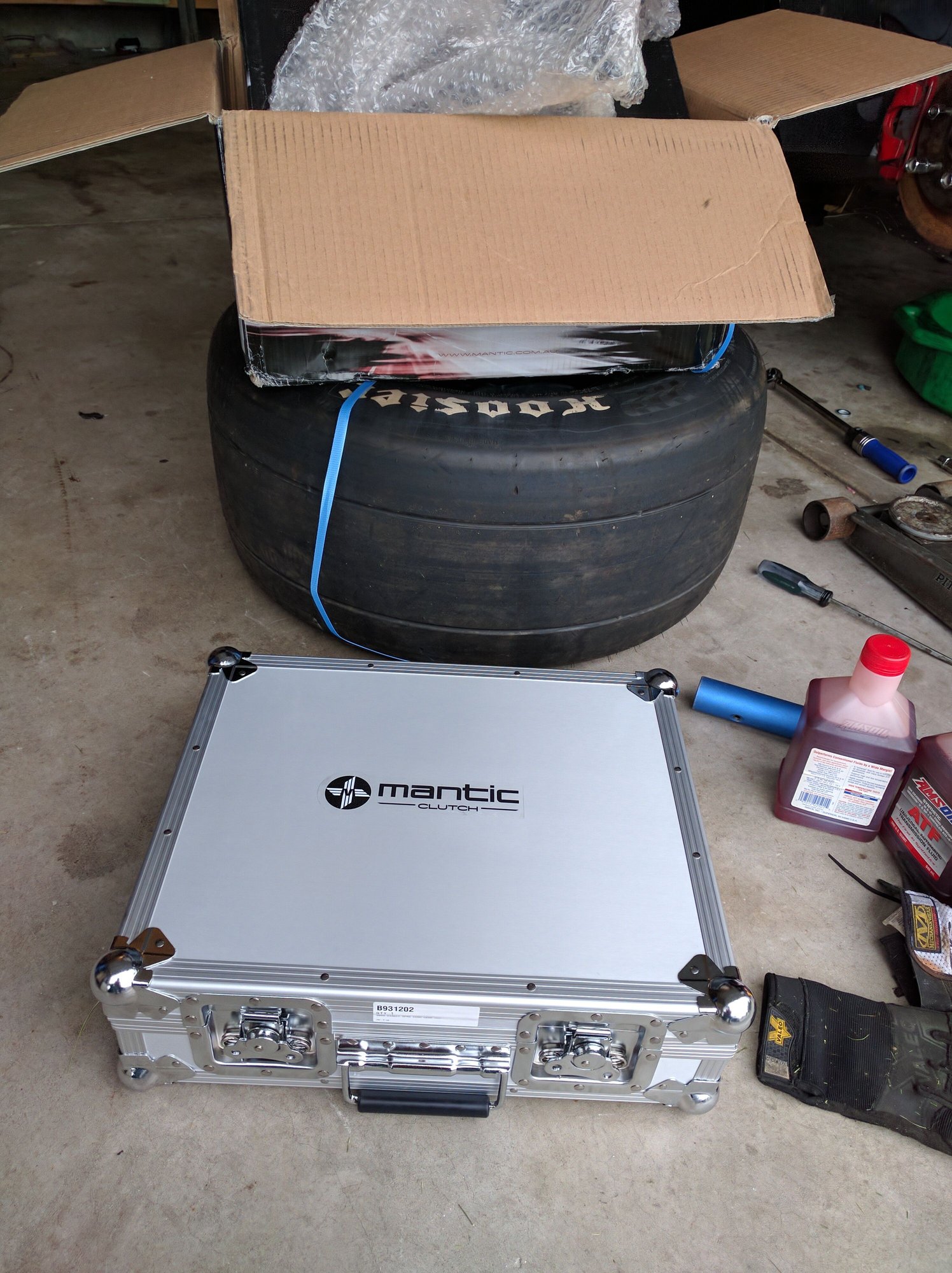

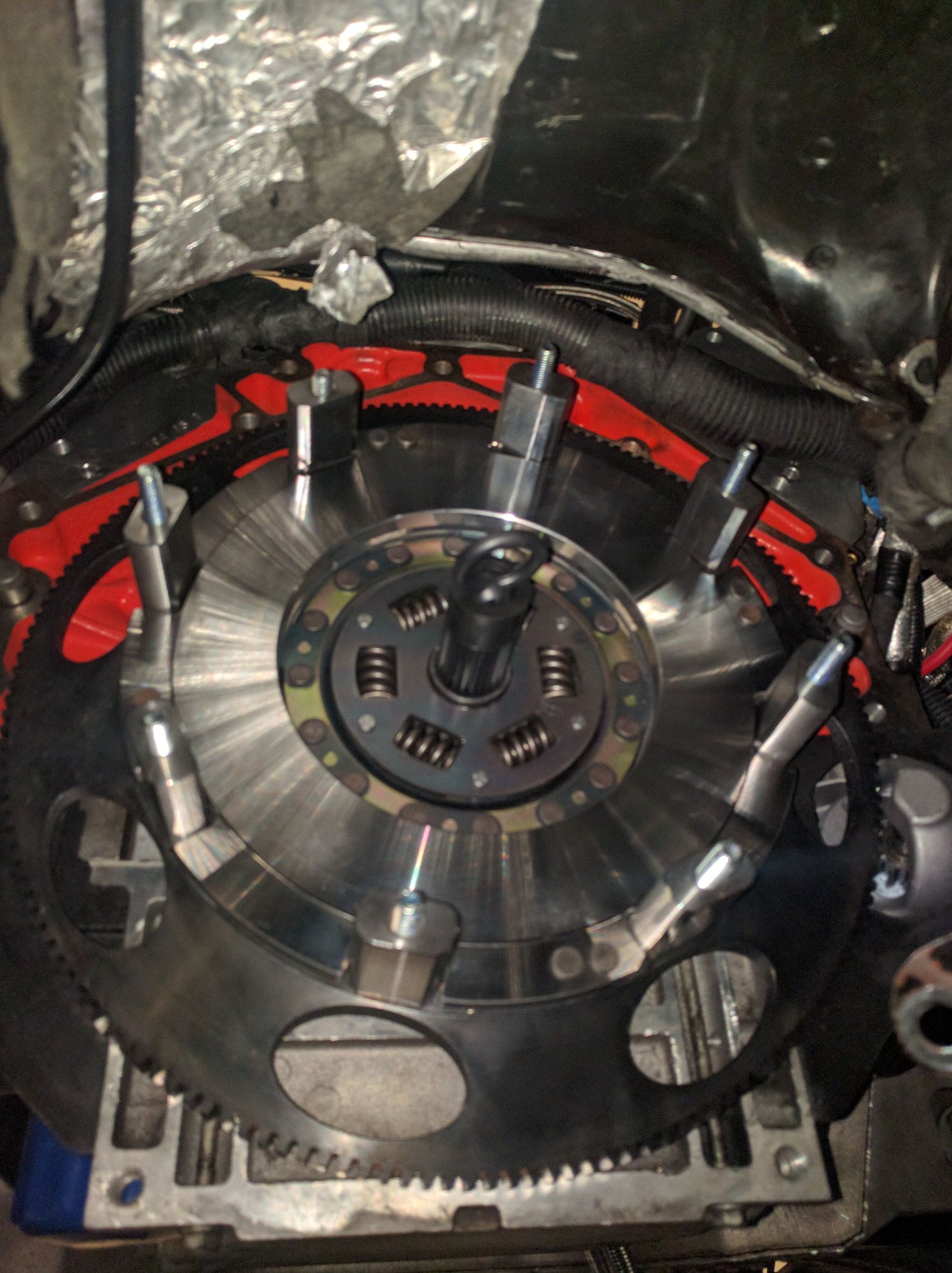

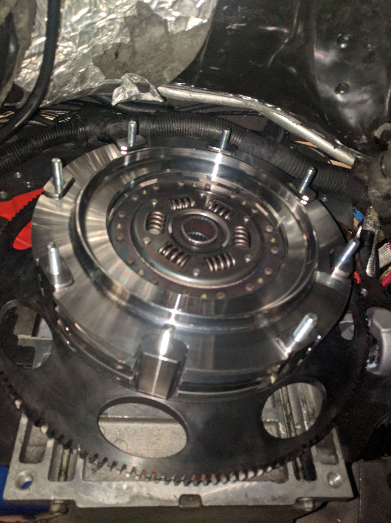

Welp, a long time since I've updated here. Everything in the engine bay is back together, just been having hydraulic problems as of late. When I got the car back together, I ended up getting a leak from my McLeod throw out bearing. So, the entire rear end had to come out of the car again. As it was an older style, I decided to just replace it with their "new and improved" version. Originally, I ordered their C6 version and it was too short so had to return it to Summit and order their C6z06 version that has more adjustment (c6 was their fixed style while the z06 is adjustable; which makes no sense to me considering both use the same height throw out from the factory, but anyway). Even with the c6z06 style however, I could not get the clearance to be within their tolerance so I reached out to McLeod, who verified that my measurements, and gave me the green light to install.
Ended up putting it in the car and reassembling the rear end again. Tried to bleed the throw out per their instructions and it kept on getting air in the system; somehow, even though I wasn't getting leaks anywhere. Spoke to McLeod again and they recommended sending the unit back so they can test it on their bench.
At this point, I was just beyond frustrated, especially with more than a month had elapsed, so I yanked the entire clutch out and replaced with a Mantic 9000 triple. Dropped the rear end for the 4th time and installed about 95% yesterday. Unfortunately I couldn't finish it up because the pressure plate cover nuts weren't included (always my luck it seems). Spoke to Alex at ECS though and they are sending me out some today --so hopefully it is just smooth sailing from here.
Anyway, here's some Mantic ****.
