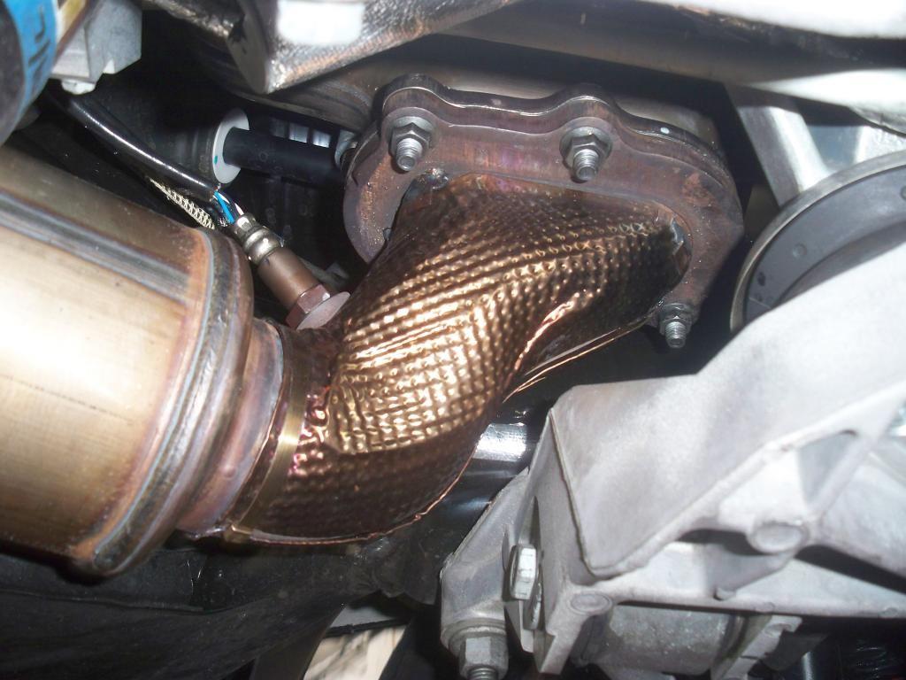

This isn't my car but here is a picture I found when researching adding another O2 bung. I think this is on a C5 but C6's are similar.. there's enough space to add another bung before the cats, you just have to get it in the right place.
Are you running stock manifolds or something else?
on the Z06 manifolds you have to cut some of the heat shield out of the way, then it's simple enough to weld a bung in

I don't remember if LS3's come with LS2 style cats/manifolds or more of the Z06/ZR1 style.
For LS2 style manifolds you can put the WB sensor in the opening to the catalytic converter.
It's not very in the picture but if you look real close you can see I circled in red the area that will work. I ran mine like this for the better part of a year. I was weary of it getting the sensor too hot.. but it seemed to work just fine
