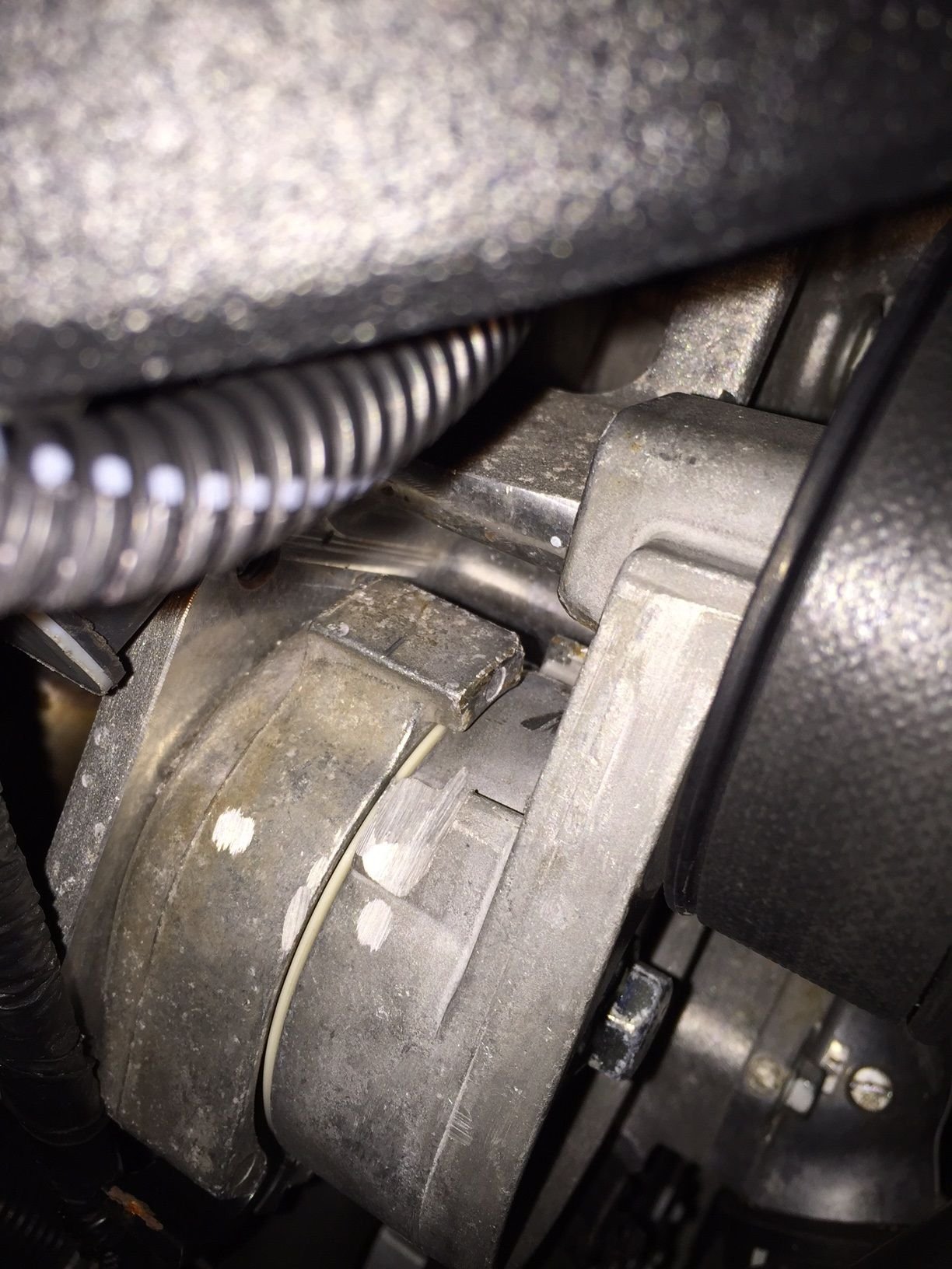

I'd figure out the proper belt length

I ground the stop on the tensioner down so it would collapse more. The belt fit fine then. Hope this helps.

I fit the 103" with the new bracket - and it fits pretty easily around the blower.
I ordered 2 more belts - 102 and 102.5" to see if they fit.
If not I'll send them back to Amazon.
John - did you grind the Tensioner to get more play/movement on it?

Yes
